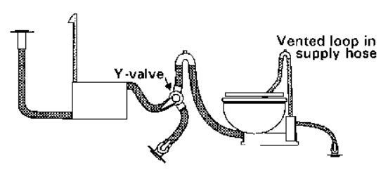

Hey everyone I installed a new head on Cool Whip but it doesn’t pump water in? There is no seacock just a thru hull, I checked the vented loop and it is good vut no water to the bowl, what am I missing???

I'm guessing it's a manual toilet. Make sure that the Dry/Wet lever or switch (on some toilets it's "dry/FLUSH" instead of "WET") lever is in the "wet" position.
I'm also wondering if you toilet intake line is connected to the right thru-hull, because that thru-hull has to be below waterline and I've never heard of a below-waterline thru-hull that doesn't have a seacock 'cuz seacocks are REQUIRED on all below waterline thru-hulls.
I should have asked this sooner: What's the make.model of your toilet?

Ho Peggy it’s a jabsco, not sure on the model # but it’s a newer one, yes there should be a seacock there, but I guess in 1975 they didn’t think about it, it is a below water line thru hull
It’s in my plan to install one in the fall
sailsf yes that is how it was plumbed.
