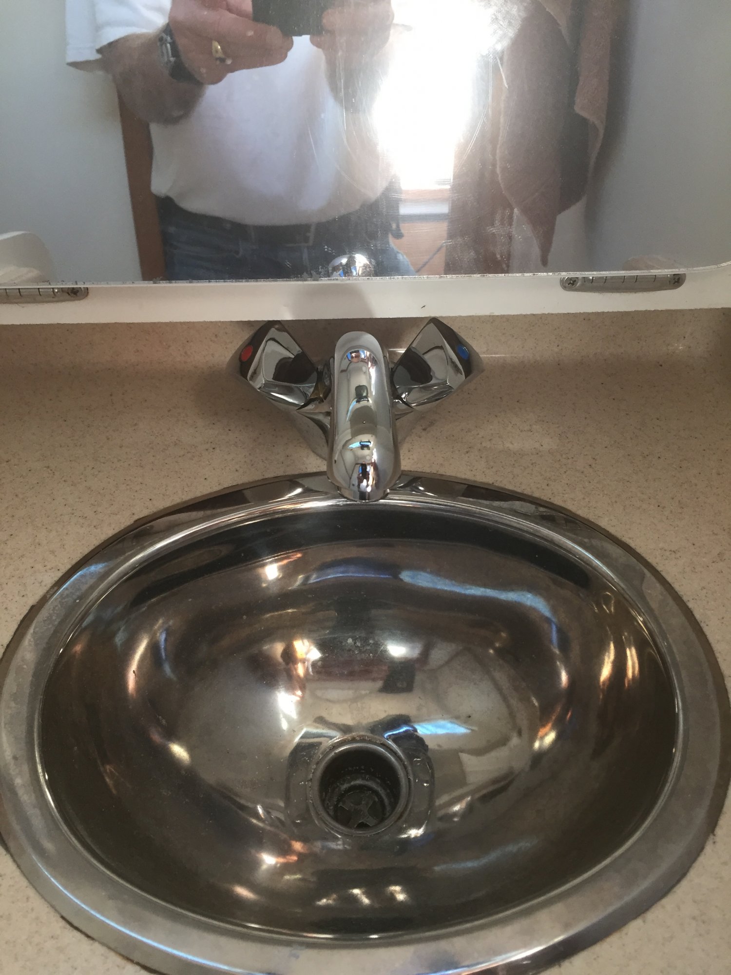

Looks nice. Did you install chrome sink or did it come with the boat?
Clyde Thorington
C310 # 245
I LEAN TOO
San Jose, CA
Came with the boat. I assume it was the original?
Clydo
May 28, 2013
366
Catalina C310 SF Bay/Delta
Think original was one formed piece. If you look at Paul J's picture in this thread you will see original.
Mine is like his.
Clyde Thorington
C310 # 245
I LEAN TOO
San Jose, CA
Nov 16, 2012
1,055
Catalina 310, 2000, #31 31 Santa Cruz
Mine is like his.
Clyde Thorington
C310 # 245
I LEAN TOO
San Jose, CA
I’ll bet CY changed it Over the production run. Ours is #31, 2000 vintage.

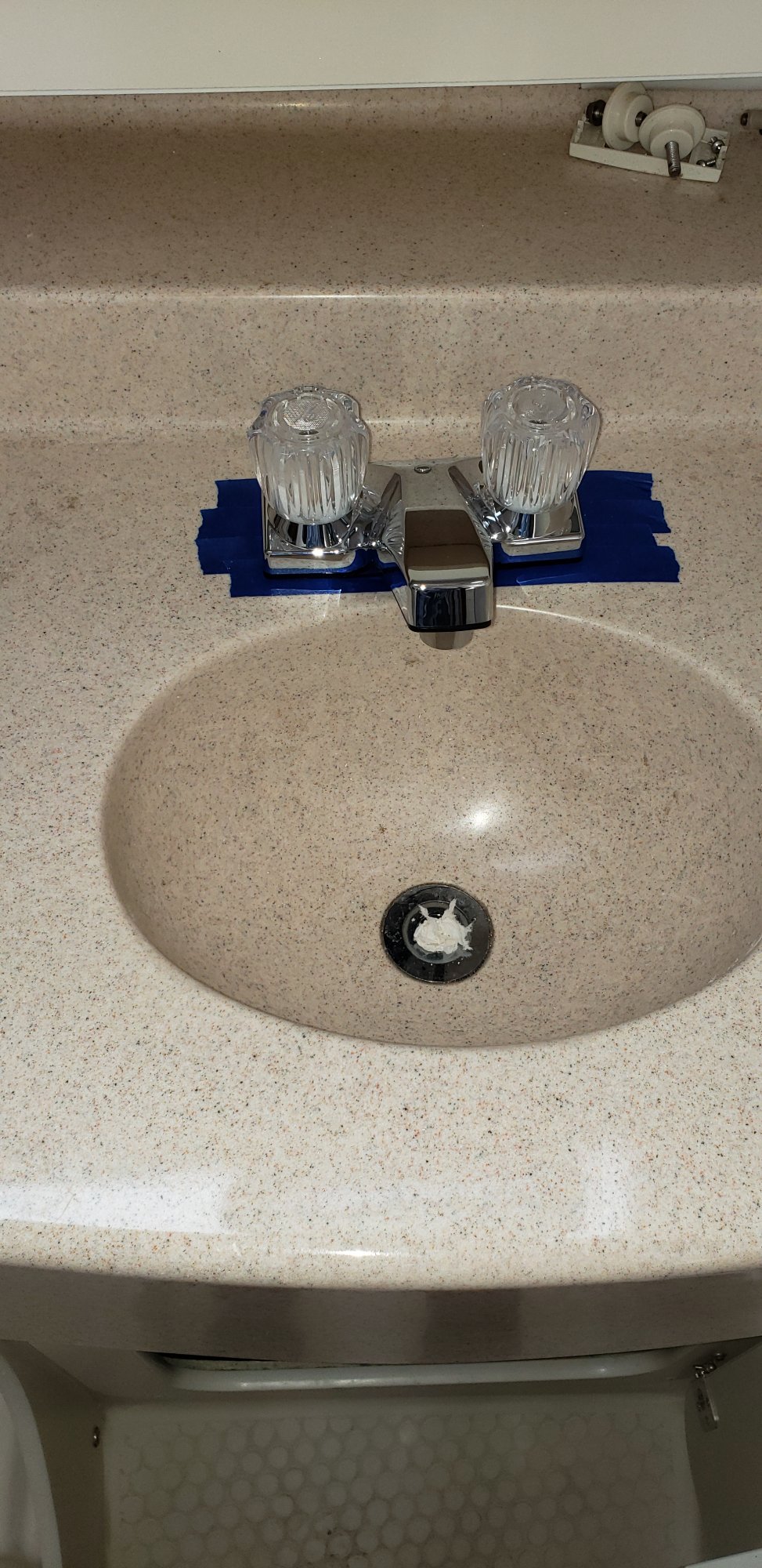

Clydo
May 28, 2013
366
I actually replaced our old one with this. Matched the original and the galley sink faucet.
Just got delivery of mine. New one has two short 3/8" ? pipes that screw into base of faucet. Didn't feel like came loose from flexible hoses.Other
end have flexible hoses with very large end that screw into hoses from water supply. Did those ends
fit into you existing water supply hoses? For some reason thought water supply hoses were much
smaller and had push in connections with clamps. Did you use those old short hoses from old
fixture and connect to old supply hoses? Thanks for your info.

San Jose, CA
It’s been a while since I did that, but I also replaced the PVC tubing at the same time. Pretty sure I used pipe thread to barbed hose fittings to make the connection. Bought a bunch of different sizes and configurations (straight and elbow) from Amazon and McMaster. Pretty inexpensive.
