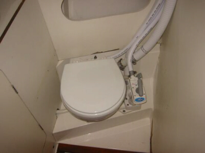

The backfilling started to happen even when not underway (scary) and I think this may have been because the intake hose for the tank was run a little low on the way to the head.
If the intake line is to blame, it's not backfilling, sea water OUTside the boat is seeking its own level INside the boat. The loop in the intake doesn't belong in the intake line between the thru-hull and the pump...it has to go between the pump and the bowl, and it needs to be at least 6-8" above waterline at ANY angle of heel....which on most sailboats puts it 2-3 FEET above the bowl (See photo). You CAN find room for it ...directly above the toilet...in a hanging locker behind the toilet ...you want to keep it as close to the toilet as possible...and you NEED to find room for it if you don't want your boat to sink because someone left the toilet in the "wet" mode when you closed up and went home.
So we'll see what happens next time the tank is full...
When the tank can't hold any more, water will rise in the bowl and overflow it....and continue to overflow it unchecked until the boat goes down. It's one of the most common reasons why boats sink in their slips.
