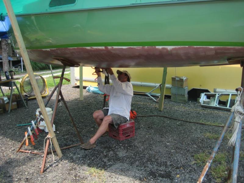

I'm interested in whether you have ever seen the gel coat below the water line on your boat, and whether you have done repairs on the gel coat. Here's the background (I started this in another thread in the medium sized boat forum, but this seems like a place more will see).
My C-27 was built in 1980 (1981 model). She's new to me, and she needed some cosmetic attention to spider cracks in the cockpit. Through a series of steps, the marine service I engaged ended up hauling her and moving her to their excellent shop. Having her out of the water with mast down, indoors, offers a number of good opportunities, one of which was to strip the bottom paint for refinish. We started that task with a grinder, and exposed the gel coat. Before the gel coat was revealed there were a few blisters to see--but not really much to see. Afterward the gel coat was bare, a large number of air voids under the gel coat and therefore incipient blisters were there to see. We ground all of these out for filling. Here's what she looked like:

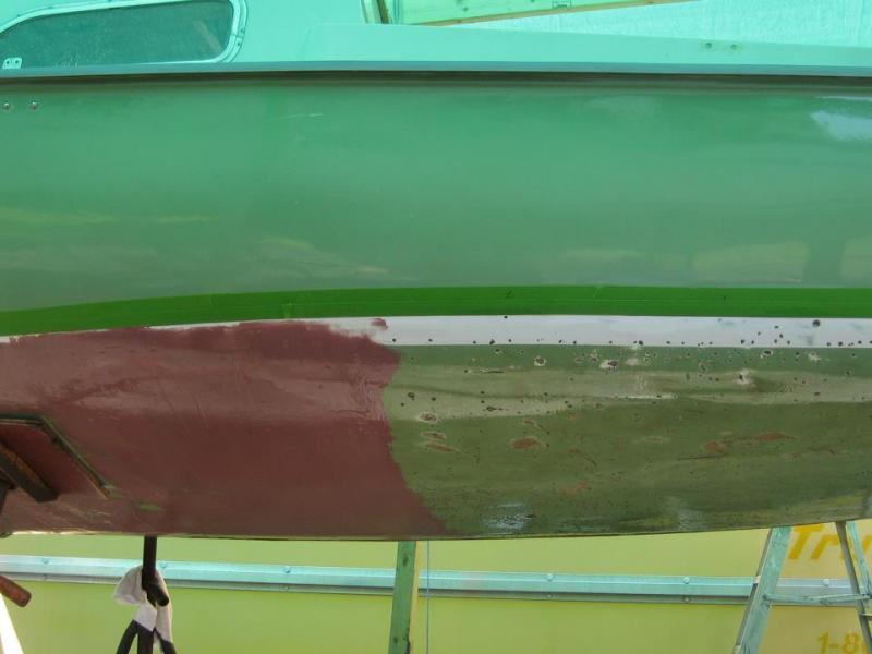

Here's the surface appearance of the gel coat that reveals an air void below (both the thin crack and the bump in the surface):

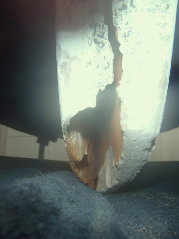

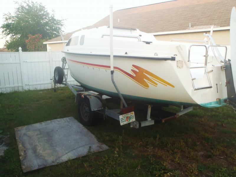

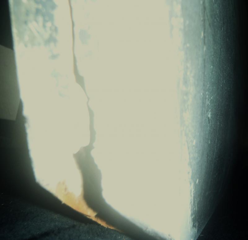

Hi all, I have a '93 Hunter 19 and need to do some keel (centerboard) repairs and was wondering if stripping the hull & bottom and repainting is something a DIY'er with some ability could tackle or if I should just redo the barrier coat. There are no clearly visible defects in the hull, and just a couple of small spider cracks on the deck near one of the stanchions.
First 2 photos are of the keel damage, last is one of the boat (sorry, no real detail on it).
Any comments or suggestions on how to tackle either of these tasks would be greatly appreciated.

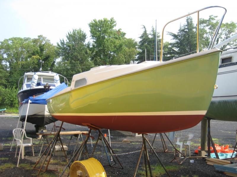

I couldn't agree more. I spent over $1200 in materials alone on a 19" O'Day Mariner.
Been there, done that. I had years of bottom paint soda-blasted off and found a gazillion small blisters, [think 1/2 a BB] some larger but not too many. Boat was a 1970, and it didn't look like the bottom paint had ever been removed.
I ground out every blister with a burr on a die grinder, quite a job in itself but a walk in the park compared to sanding the fairing compound..
I followed West System's guide. After all grinding was finished, a coat of epoxy, pushed into holes with a spreader, and before that kicked off, a coat of 407 Low-Density Filler.
After that was all sanded fair [over head with an air powered board file- quite a workout!!],
6 coats of epoxy with their barrier additive. Sanded that with a DA sander then bottom paint.
On a 19" boat I used about 6-7 gallons of W.S. This was NOT a weekend project.
Quite a job, but, I think it's good for the next 40 years.
