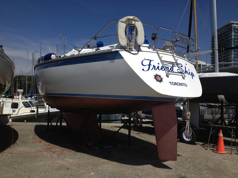

Ahh- the memory is all too vivid still- I stripped the bottom this summer. Took much longer than anticipated- contractor turned out NOT to have the proper equipment to soda blast, VC Tar is a B----h to get off, and shoal keel are an awkward height. I ended up with the contractor using a heat gun and scraper then I sanded with a 6" orbital sander and 60 grit. When all was said and done the bottom was in excellent shape, very few blisters. I had made the decision to do the hull as the keel ( iron) badly needed work-thinking it wouldn't be THAT much extra work!! 4coats of IP 2000 later and a coat of VC17 and this is what it looks like:

...I had made the decision to do the hull as the keel ( iron) badly needed work-thinking it wouldn't be THAT much extra work!! 4coats of IP 2000 later and a coat of VC17 and this is what it looks like:
Great outcome, Richard. Thanks for the note!

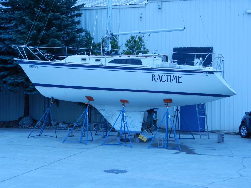

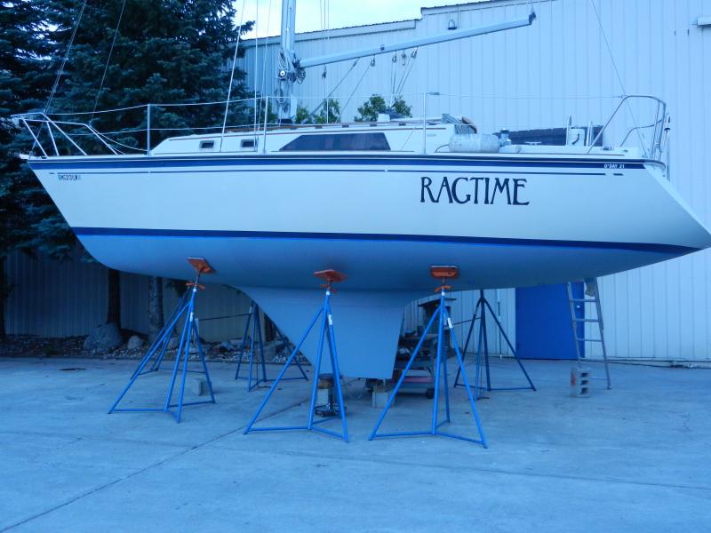

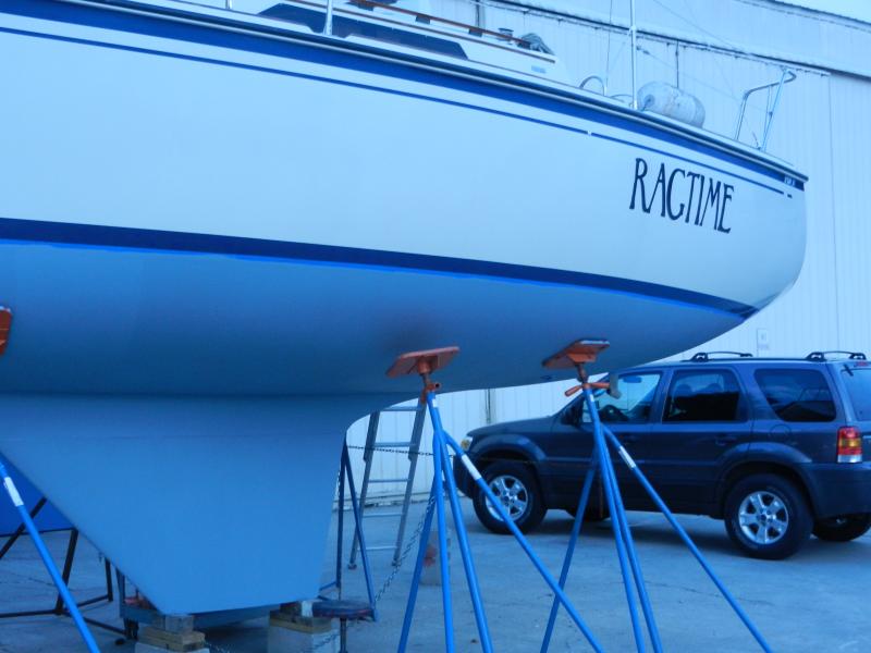

Much confusion here. Leroy mentions never hearing of epoxy over polyester. In fact that is done all the time - inter protect (epoxy) commonly used over gelcoat (polyester). It is the OTHER WAY AROUND that is the problem. Polyester over epoxy does not work - on several levels - chemically, mechanically, practicality.
I agree with Jibes that gelcoat is not needed in this situation. If the owner wants it for aesthetic reasons, then the repair up through the step of coating with gelcoat should be all polyester. Epoxy barrier coat after that is fine.
Richard's post was interesting as I purchased an O'day 31 this past Summer. It had VC-tar from 1986 or so. (a product that I was fond of at that time also) However, after 25 years the VC-tar had cracked all over - unsightly and leaving me unsure of its integrity. We removed it, found the gelcoat to be in perfect condition, and recoated with Interprotect. (see pics) I INSISTED that the tar be removed by sanding. Although some yards and independent contractors will blast VC-tar, most reputable (knowledgable) yards will not.
