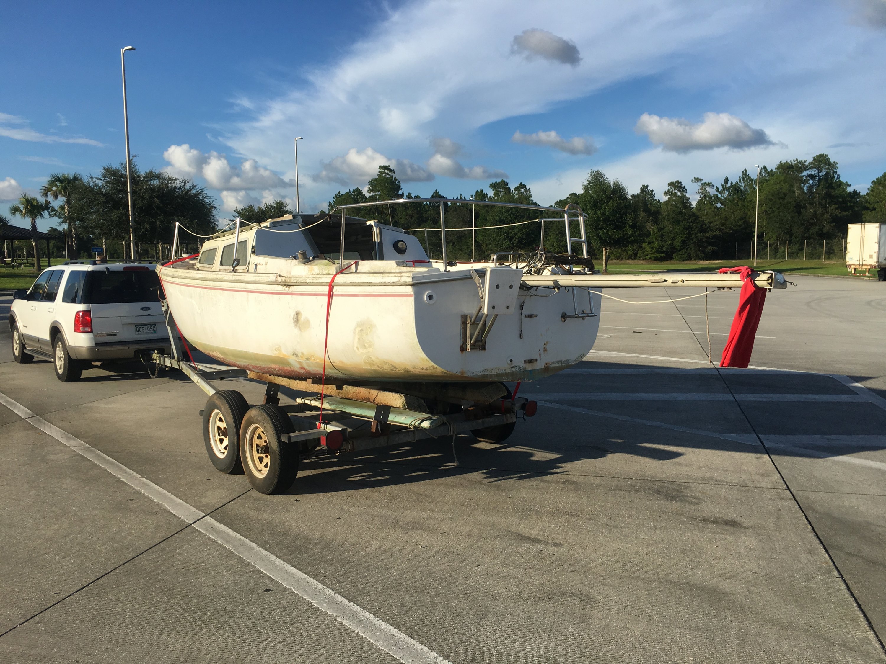

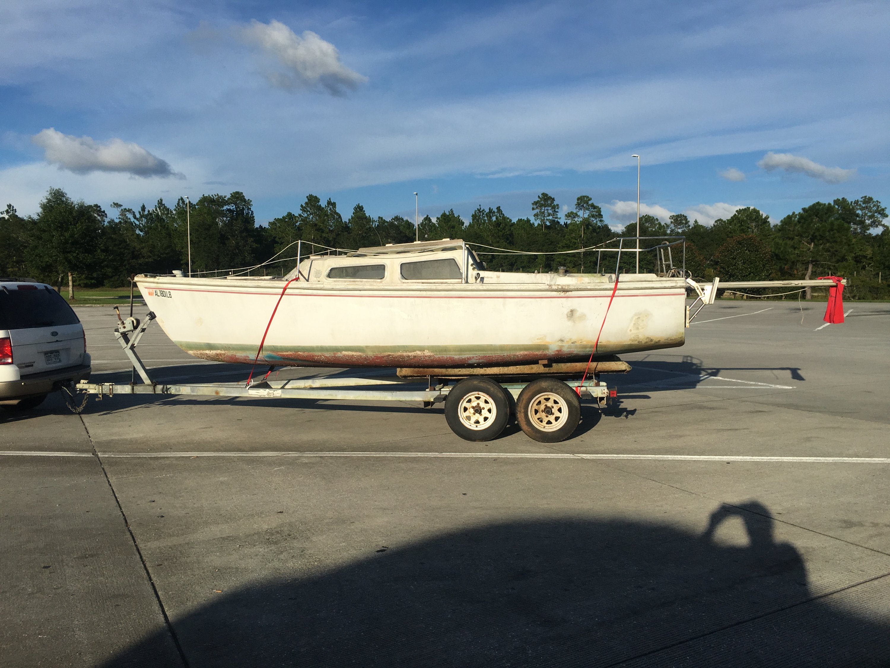

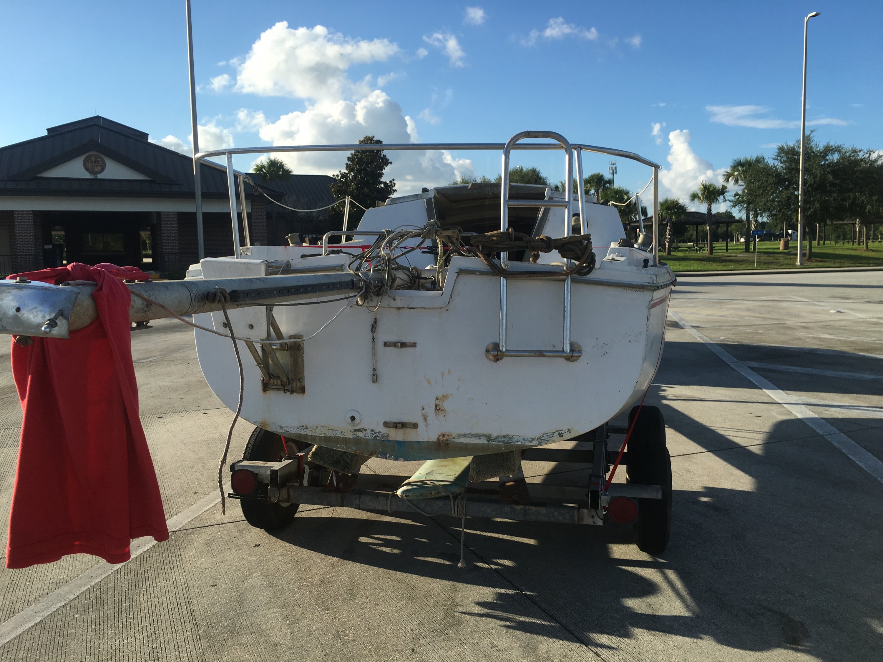

Hey y'all, just stopped by to join in the fun. In keeping with one of the topics that caught me "have i just made the biggest mistake of my life?" I too have just bought a "project boat". Its an '82 C22 that i paid $750 for. Found it on craigs list in Alabama. Shes somewhat complete just not together. Has a swing keel just not in the boat, 5.5 johnson outboard vintage '59 that is supposed to run great (!), most of the interior cushions and all need replacing just good for patterns. Has main with a couple of small holes under 2 inch square, jib is hank on in good shape and all standing rigging is present and at least usable. Running rigging is trash what there us of it was barely good enough to tie stuff down for travel. Mast and boom are ok, mast step is not. Has about 10" of rain water in it that previous owner couldn't get out. It sat under a oak tree for two years with the hatch open and the pop top also.
Trailer is a tandem axle powerboat with 4x6 bunk boards and 4 different tires and two different type rims. Rudder needs new blade, tiller is delaminating as are the drop boards and several of the interior hatch covers. Winches are very good, motor mount is solid and swim ladder only needs the rubber bumpers. Stern pushpit only slightly bent on starboard corner and bow pulpit is perfect and will look very nice once it is attached to the boat.
Oh yes, almost forgot, there is a keel but not sure if it for this boat. The boat was left in a slip for an "extended length of time" and the keel fell out. The slip was in 8-10 feet of water so no one tried to retrieve it. This one is from a parts donor I am told. The winch is just a pile of rust suspended by spider webs.
So with all that said, I think I got a pretty good deal. What say you all? Looking forward to any and all advise, help and insight you have to offer.
Thanks in advance,
Geoff Adams
p.s. In the pic of aft end, that is the keel tied to the bottom of the trailer. I used the best part of the main halyard to tie it down. 141 miles later it was still there.

Step 1 : you need to support the hull with a forward bunk board strut. Don't let her sit with all her weight rocking on that cross member-- the hull is thin and designed to be "cradled" by the long bunks forward and aft.

I think they should have paid you the $750 to haul it off. Not trying to be rude, but that looks like a project that's gonna cost way more than it's worth to put back in shape. Having set full of water for a few years, it's a sure bet the plywood stringers are rotten and they are nearly impossible to get to. You most likely have core damage where the mast step was ripped out of the deck and probably around some of the bent stanchions and the missing pulpit. If that "donor" keel turns out to not be from a C22, sell it, the trailer and mast for scrap metal and part out the rest of the hardware before you sink a single dime into it. I hate to be a Debbie downer, but considering everything that is missing or needs major repair, I think you got taken to the cleaners on this one.

Maybe salvage the trailer. Get some fenders etc. A fellow C22 owner may give you $400 for a tandem axle trailer. Other than that, you bought $750 worth of heartache. Part it out and try to recoup your cost. There are just too many nice C22's out there that are water ready. I paid $1500 for mine. It was dirty but it was sailable when I bought it. Btw, I would never buy a boat from an owner that was too lazy to put a $20 tarp over a boat and let it flood like he did.
