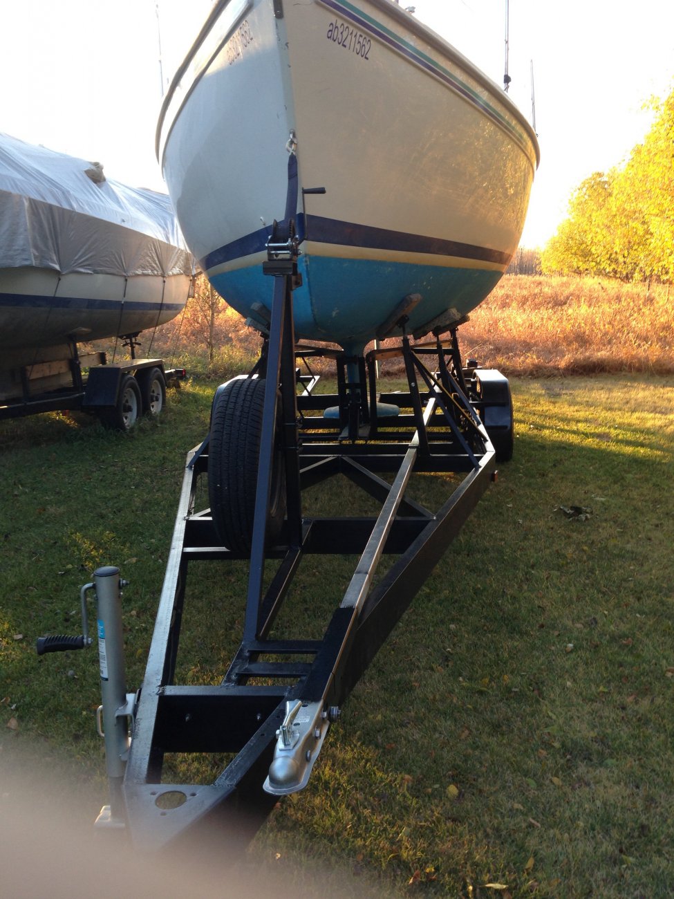

In the picture from jim26m you can see his spare tire. We set that up as a mount that allows the tire to roll and you have your tongue wheel. I agree the hand held trailer dolly just looks too flimsy.
Do you have a pic of the mount or hub that you used?

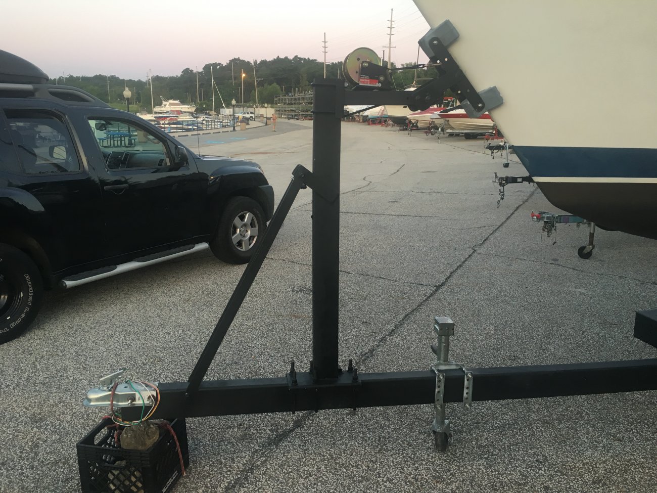

To clarify I have a Nissan Xterra so it's got a bit more weight back there than a pickup. I can toss a bunch of sandbags in the back.
For once this boat didn't throw five more problems at me last night. I managed to move the bow support forward about 5" and adjust the bow "bumpers". I believe the boat moved forward about 8" in total. It went from needing 300-400 lbs to keep the tongue on the ground to me only able to lift it a 1/4" (150-200lbs?). I'm much more confident towing it down the highway now. So we have a significant improvement in tongue weight but in theory the trailer now needs to be backed up an additional 8" to get the boat on/off. The water was already up to my hitch last weekend. Can't go much further without dunking electrical connectors. I'm guessing I need a tongue extension...

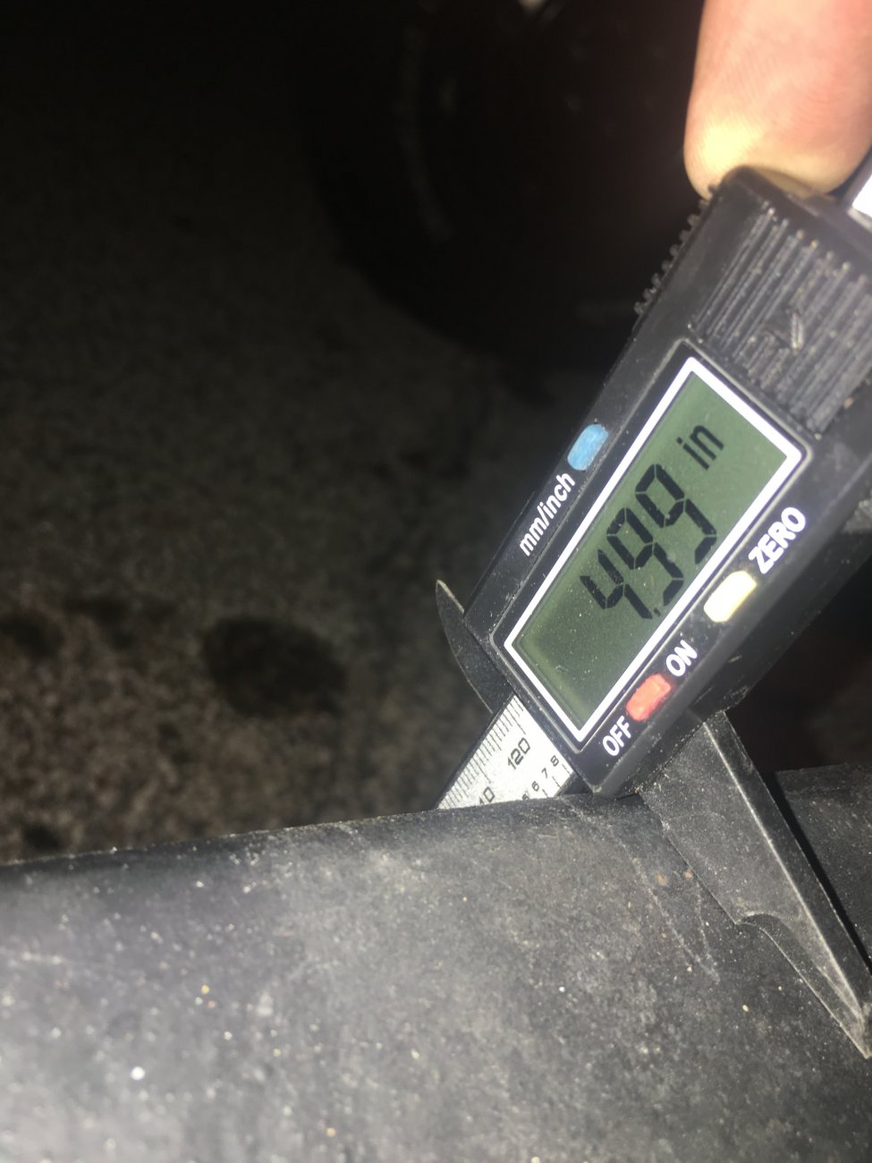

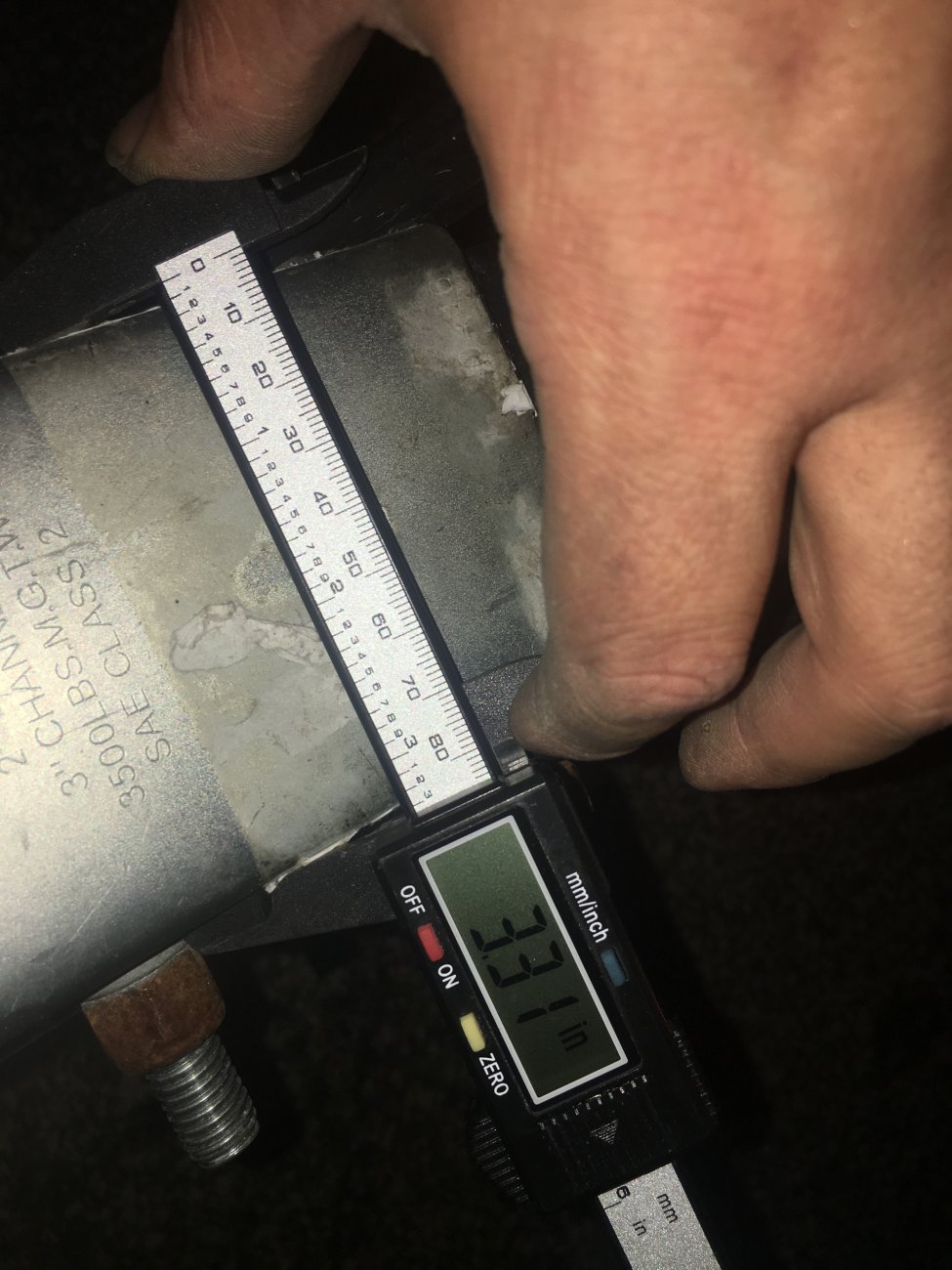

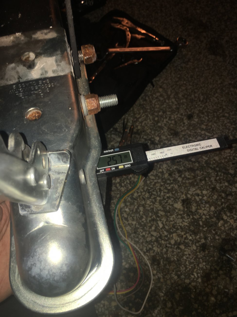

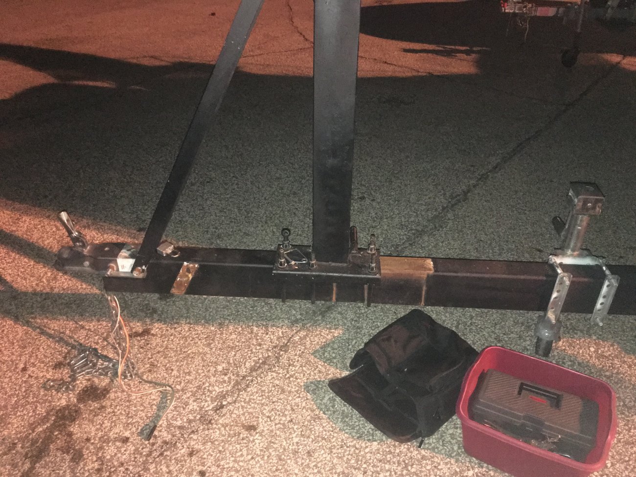

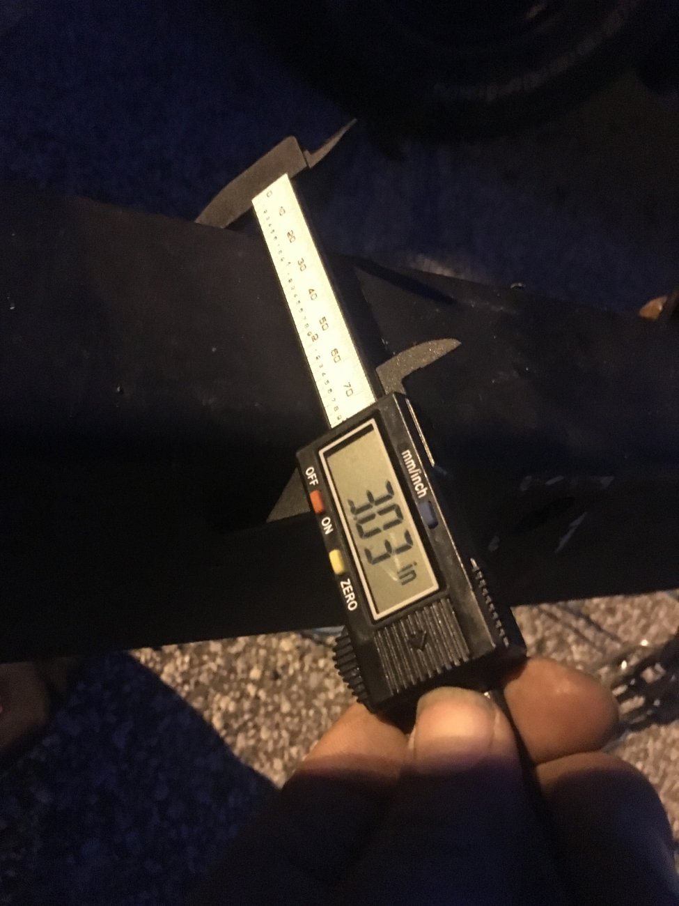

I called a supplier yesterday and the metal for an extension is more affordable than I thought it'd be. Now comes the question of dimensions and mounting. The tongue is 3x5 (see pics for exact dims). If the extension pulls out from inside it my first question is what size tubing should I get? The trailer is over 40 years old so it's bound to have nicks and dents on the inside.
External mounting is also an option. I don't use the trailer very often so I don't have a problem bolting it on when needed. I'm guessing I'll run into fewer fabrication/installation issues but the cost is a little bit higher due to the extra hardware. Also, does this really need to be as close to 5" as possible for strength? I'm interested in hearing opinions from those who've created or used similar extensions

Most of the "factory" extenders that I have seen that come with the trailer are retractable and stay on the trailer retracted when not in use. They have square steel brackets welded to the side of the center frame member and to the first cross member. (or to the angled trailer steel frame - wherever they can fit to be close aboard the centerline). Those brackets have a hole in their side (or top to bottom) for a hitch pin to fit. Into those square brackets fits the square tube that is the extender. That tube has a hitch on its front and a few strategically placed holes along it's length for a hitch pin to fit. To use, pull the hitch pins holding it in its retracted position and slide it forward to the proper set of holes in the extended position and pin it in place with the hitch pins. Size of the square steel tube would be dependent on how much weight it has to carry but remember you will have your front trailer wheel on the ground carrying the tongue weight so the tube shouldn't have to bear all that much weight. I've seen them in the 2X2 inch variety. Hope this makes sense. will try to find a picture if I can. You might look at the factory trailer sites to see if there are any pictures (Triad would be one to look at).

I was thinking about ordering an 8' tube for the extension. I think I will go with steel unless the price of aluminum is cheap enough to get something beefy. Now I'm wondering what height and width I should use to avoid any deformations, knicks or leftover garbage from factory welding. 3/8-1/2" smaller than the inside of the tongue?
