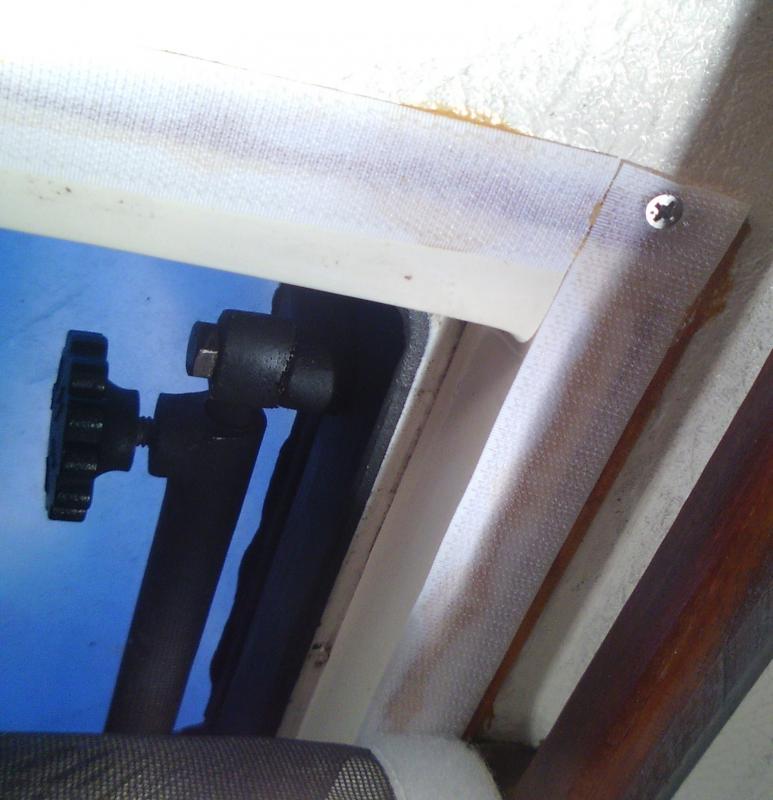

I made screens from noseeum screen, velcro, and webbing from Sailrite. The webbing color is same as headliner and width is same as velcro. I glued the velcro to the headliner with small screws at stress points. I sewed the other 1/2 velcro to the screen same time as sewing the webbing. See attached pictures.
