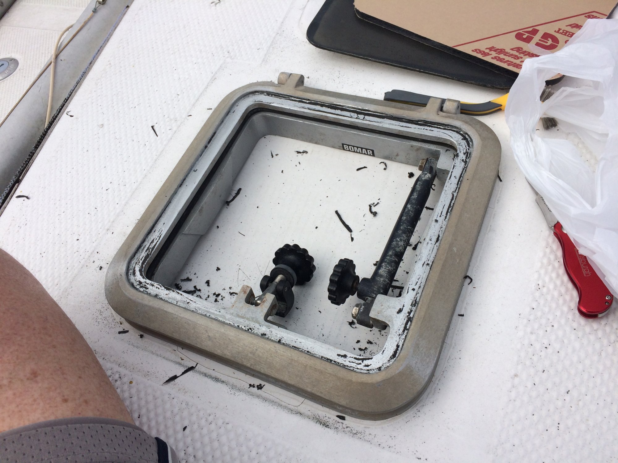

I recently took my forward hatch to have it sanded, painted, and lexan replaced. I reinstalled, but a month later the lexan easily popped out of the hatch frame. What material/goop should the lexan be bedded in? The boat resides at the top of the Chesapeake (winter/summer seasons).

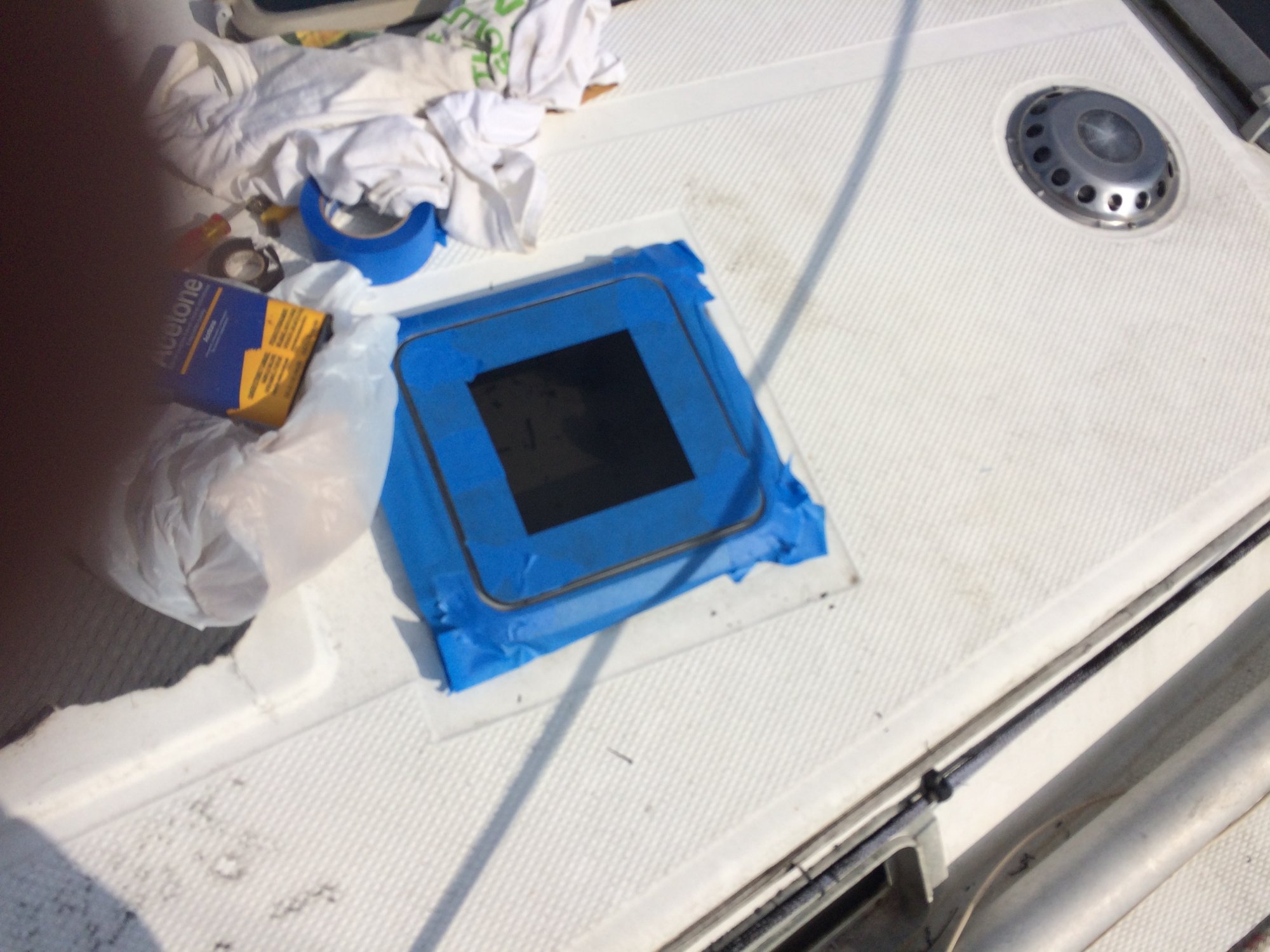

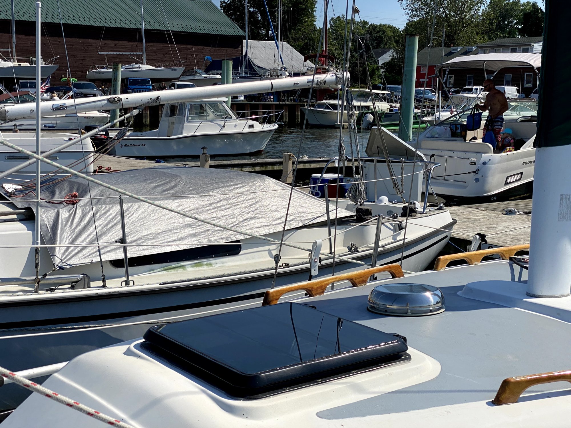

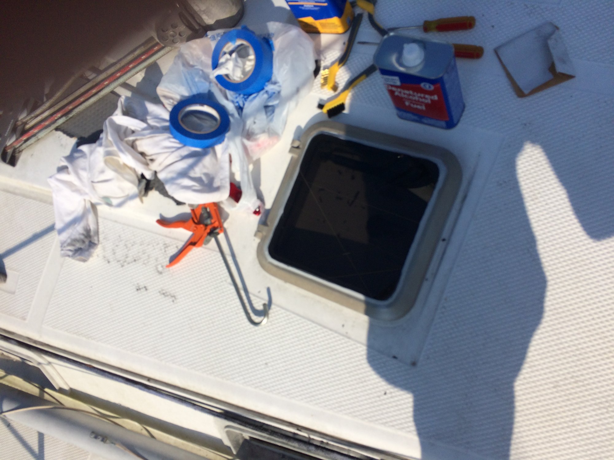

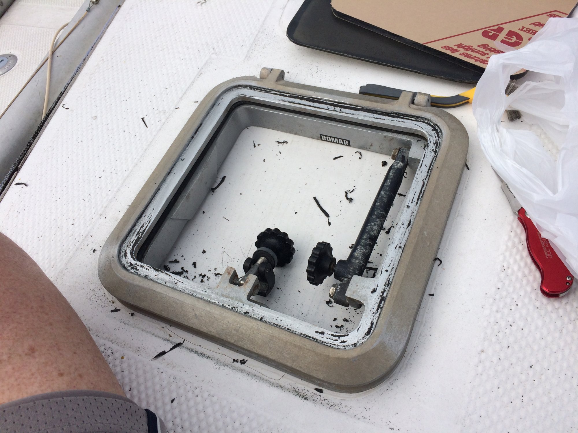

DC 795 is great for that application. Meticulous cleaning and surface preparation is necessary for the 795 to bond to the frame and acrylic.

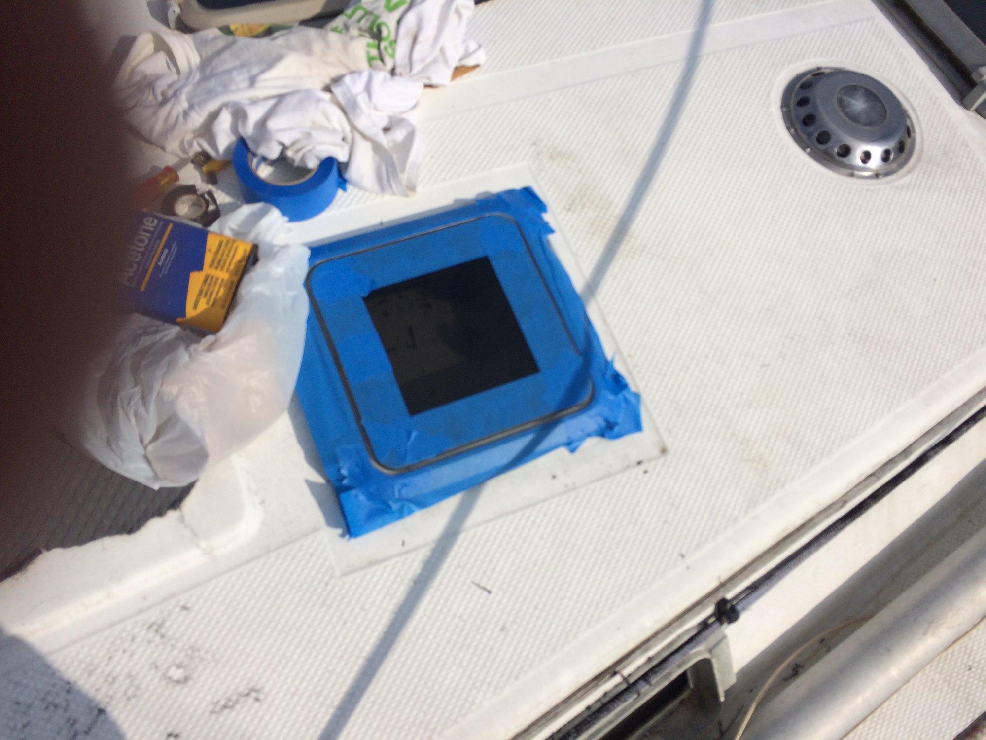

I did all 4 of mine a couple of years ago; a good masking tape job is essential for a good finish
