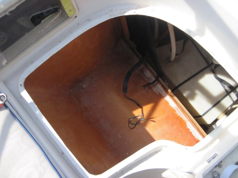

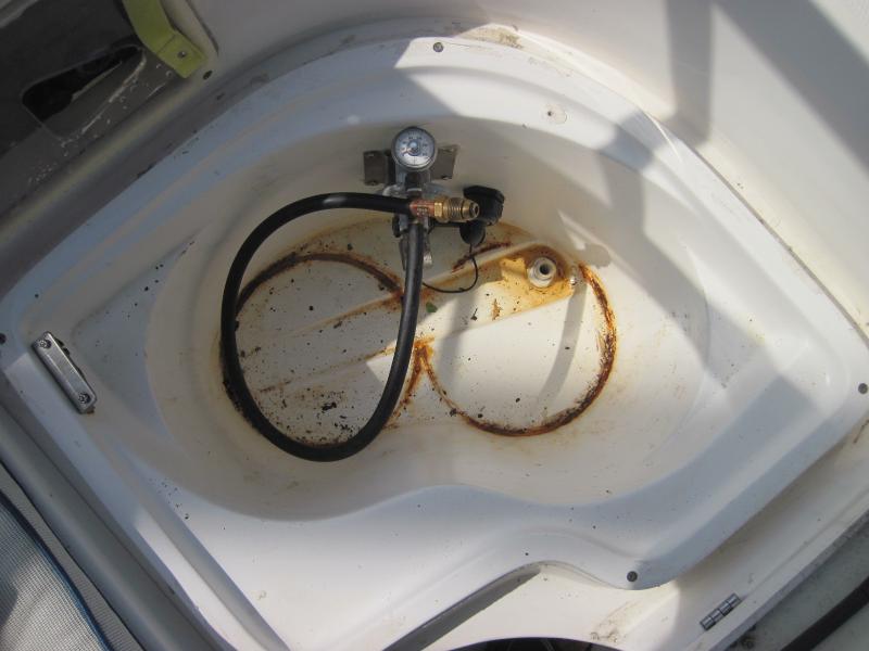

Removed the propane bucket from the starboard lazertte(SP you know what I mean). Removed the two 5lb tanks that have lots of rust on the bottom. Have ordered from Sailboatowners two fiber glass 10lb tanks. Will cut and add 6 inches to the existing bucket to hold the new tanks. Measurements says they will fit. Pictures of this will follow.

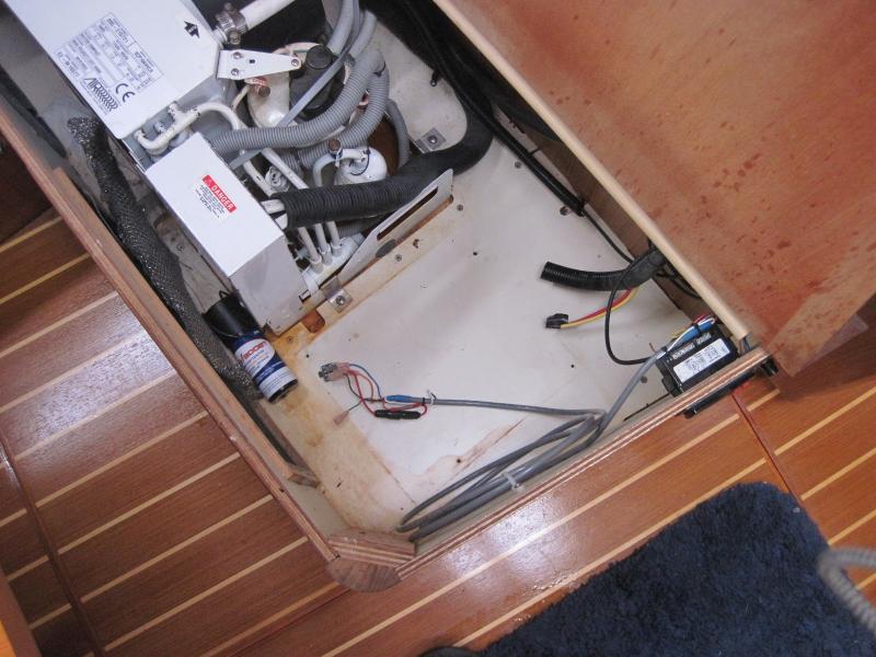

Refrigeration system is toast. Compressor failed. So I removed the Alder-Barbour and evaporator. Will be installing a new system Frigoboat in the next couple of weeks.

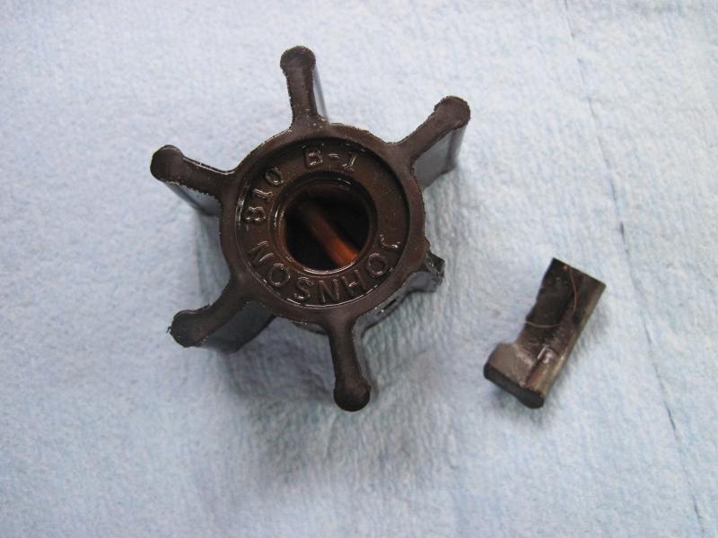

checked the impeller and found a broken vane which was wedged in the exhaust port side, was able to remove it. Installed new impeller.

Jim .......I also have 2002 H356....Very interested in your inlarging of the propane locker. I still have the original tank (1) right now and plenty of rust. So will be needing to replace tank soon. I have also lots of other fixes and improvement which I would be glad to share. Keep me posted. onecoolair@yahoo.com

Yes its toast. Had a leak at the connector- low side which dumped all the 134 on the floor while still running. Got a fellow boater who works on BIG Hvac systems stopped by to look at it. Turn the refrig on and about 5 secs later the fuse trips. Told me the compressor has seized up.
Called Alder-Barbour and they don't make a compatible evaporator. The one in the boat is obsolete and they don't make them.
Time to switch to a new system. Frigoboat make what I need...

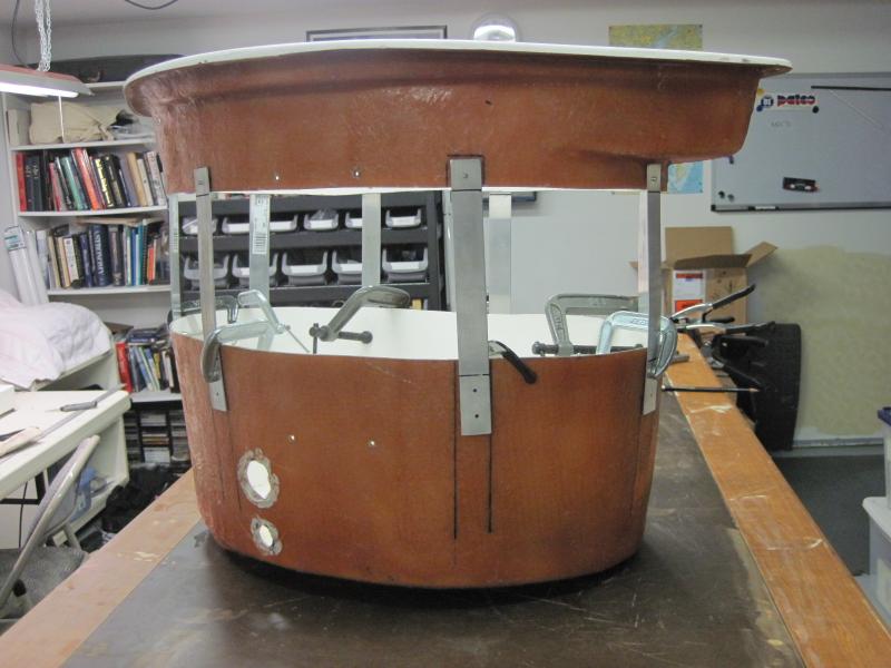

back to the propane locker....time to cut the fiber glass..

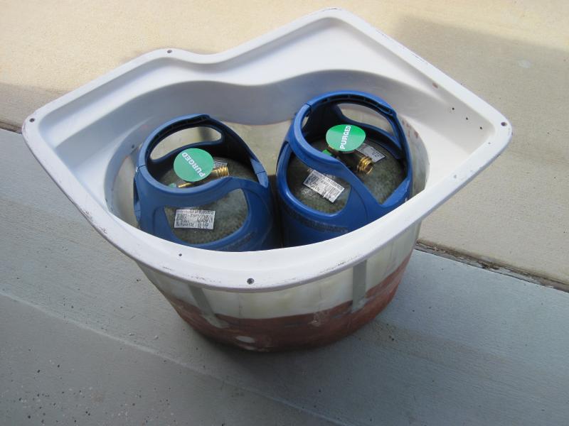

Propane locker

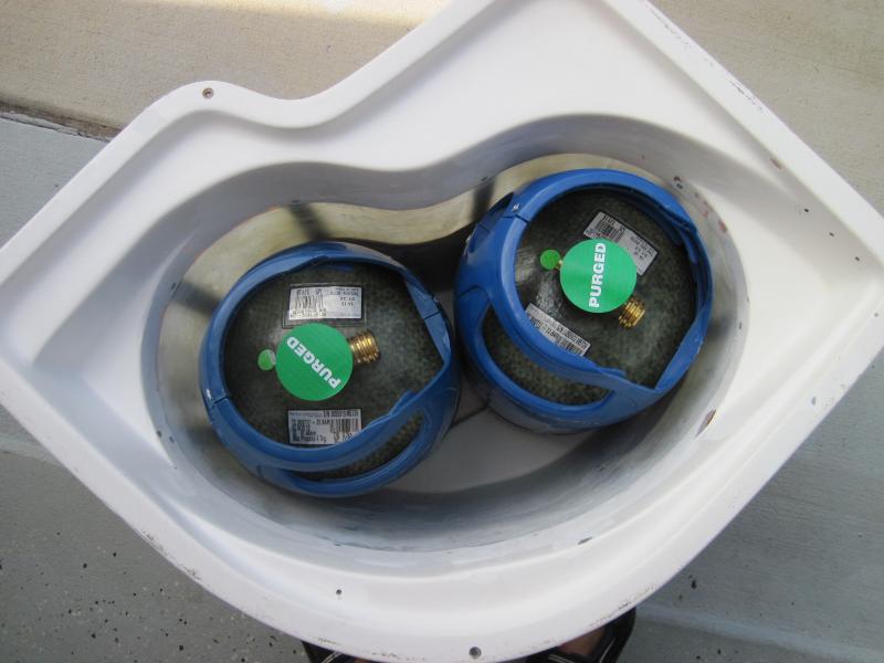

Locker has been cut and enlarged. Was at the boat this morning checking for fit. YEA IT FITS... small adjustment of a 1/2" since it was just barely touching on the bow side of the pan. Now the fun starts re-fiber glassing the tub back together...

YEA! they fit...
Just got my new fiberglass propane tanks and immediately popped them into the modified tank locker. THEY FIT GREAT...
Now all I have to do is paint the inside and maybe outside... cut the holes for the electrical and gas line. Then I'll be in business..

Since you're making the locker deeper, how are you maintaining the proper slope on the line that is supposed to run from the bottom of the locker overboard to let propane flow out of the boat if there's a leak?
Mar 21, 2004
2,175
Hunter 356 Cobb Island, MD
Robert, still plenty of room and slope for the drain. I Check that one...!
