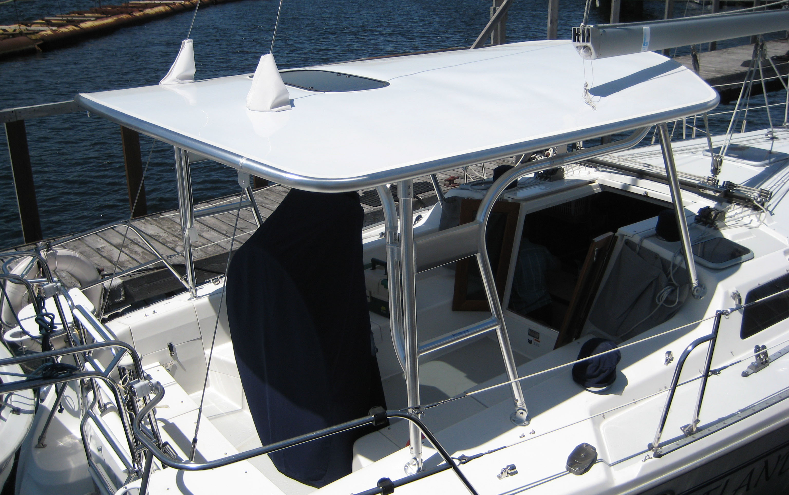

I have made a lot of changes to my Hunter Legend 40.5 built in 1987 boat since I bought her (6 years ago). The boat came with a rug/sunbrella cockpit enclosure (almost complete), but it is a nuisance to keep clean due to sea-birds activities in the area. No way to keep them out from high altitude bombing! Also season in Vancouver is rather short and weather can be cold. I am thinking about making a hard top dodger with extension for the bimini part going over the steering position. Plan would be to have rolled side enclousre to keep the cockpit "warm".
I wonder if anyone ever tried to make such a "roof over the head". Or know workshop that fabricates hard dodgers. The best will be made out of fibreglass. But an option could be an aluminium-made./ik

Yes, hard dodgers are great and many people, including me, have made them. Fiberglass would be my choice, and I would core it for strength and weight reasons if there is any overhead load on it.
You just make a template/mold of the shape and orientation you need using material like thin pvc board or doorskins, etc, with battens and stringers where needed to define the shape, then either use that as a male plug to build on top, or as a female mold to build inside. Choice would depend on both the situation and which side you wanted to work less on when finishing.
Search the web for youtube examples of people making these.

Thx for feedback. My choice would be fibreglass; the only worry is the cost of building the moulding, either internal or external for one off job. I wonder if anyone tried to use a core material to build the dodger on the boat and then fibreglass it? There is a lot of curves that must be "taken out" and straightened for building the shape and connection to the existing deck and cockpit form. Therefore making a plug will not be easy. Any experience with it?

I think that I have used a wrng expresion; what I am looking for is not the hard top but also the front and part of the sides and roof should go where nrmally bimini goes. Only side would have canvas with cellulite windows. Idea is to extend boating time, which in PNW is rather short. I should call a cockpit enclosure with hard top. Did anyone tried something like this?/ik
As aftertought I will try to down load the sketches with measurements that I prepared. I hope it works.

If I read the drawings correctly, it will serve as a dodger/Bimini combination. I will function much like the structures for many Catamarans. Several thoughts are involved. You will need to minimize the weight of the structure. So perhaps a foam core is needed. I have seen foam core used with a fiberglass skin on some boat designs. You will need to build an arch to support the hardtop at the stern. The design will hide the main sail, making sail trim a bit of a problem. The rig will raise the CG of the boat, making it a bit tender in a strong breeze.

I probably didn't describe myself well above, but I wasn't suggesting making a plug or mold in the sense that it could ever be used again, or cost a lot of money.
If you use cheap doorskins, or thin PVC boards, with some sticks and other random wood to make your shape, you then start building on that. The only thing this is doing is providing the needed shape. Spray the form with PVA just to make things easier, fasten core material around the form, then glass the outer skin on. This is pretty much doing what you suggest above, but using just core material to make a shape often doesn't work well unless the core is thin enough to take a lot of multidirectional bends.
Once set, the shape will hold, so you remove it from the form, then glass the inner skin on. Now it is a matter of cutting out any windows you want, and creating any flanges needed to fasten it to the deck or other structure.
If this dodger won't see much loads from solar panels, walking on, etc, then you might consider using thin PVC board for the form, and glassing the outer skin right to this. The form will be the core, but it won't add a lot of stiffness like structural core would. Nice thing about PVC board is a heat gun will allow it to form almost any shape.
