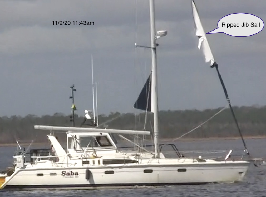

Yes, after a storm you will find some tattered and destroyed headsails. That is not a problem with the furling units but a problem with the owners who don't properly furl and secure the sail.
I did the 3 turns which normally works, but many Hurricane have stronger winds.
So the wind got underneath my 3 turn rap.
Jim...
