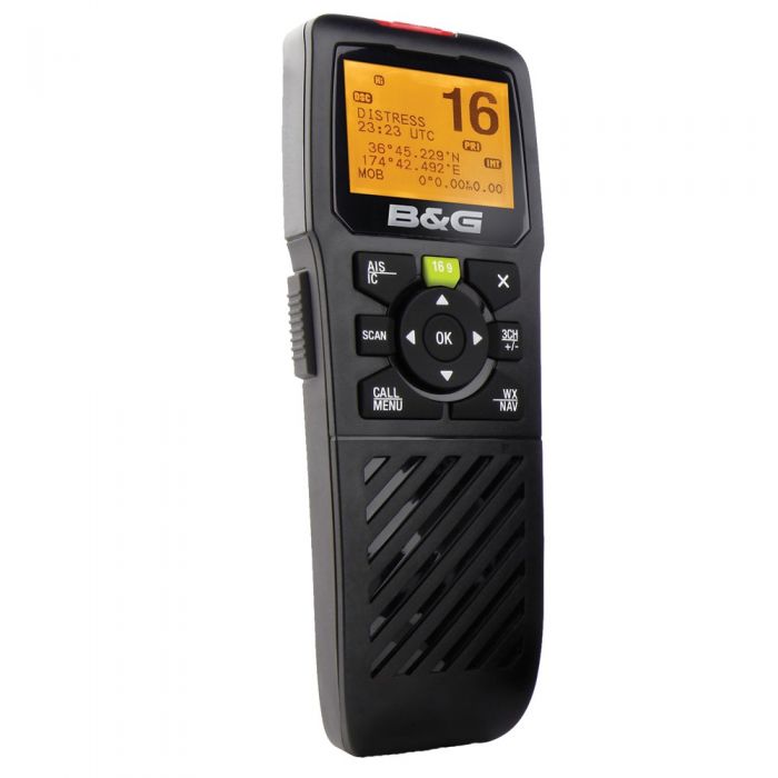

I compromised with the B&G V50 base unit and the H50 handheld unit.
The H50 actually “talks” through the V50 base unit, using the mast-top antenna.
It allows me to have a “walk about” handheld in the cockpit or on deck, but use the power and range of the base unit.
I have had it a few years now, and have had no issues with it. Mine has built in AIS, so I have it networked with my CP so I have AIS on my CP, and the chart plotter provides GPS coordinates to the radio.
Now that's what I'm talkin' about. So the V50 base can act as a repeater for the H50? You have masthead antenna output for an MOB situation, as long as the top of your mast is within sight? After that, you have a standard output hand-held, I assume.
-Will (Dragonfly)
Not quite. The handset repeats the base station, but doesn't have its own VHF capability. It just passes data via Bluetooth or similar protocol to the base station which then forwards it. Works great walking around the boat, but I wouldn't count on the handset/base link to hold up if I went overboard.
