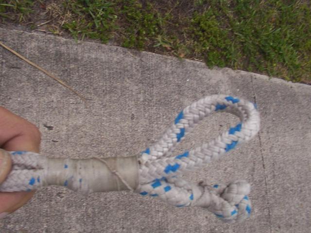

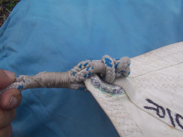

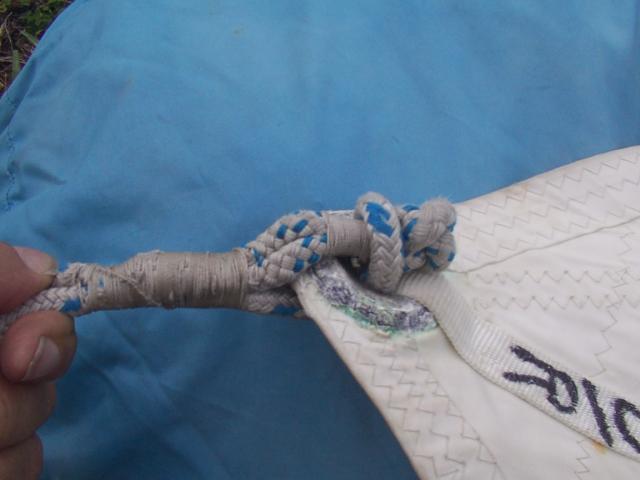

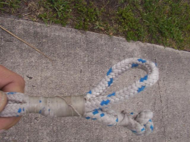

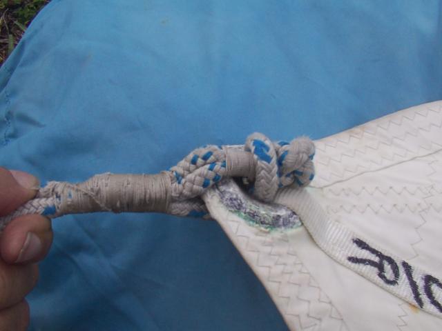

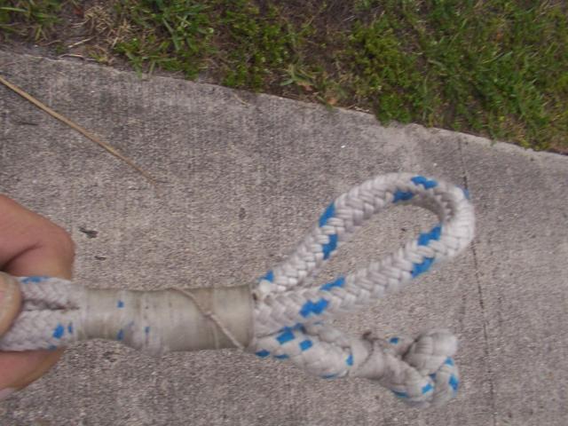

As I posted earlier- I use this. .Have used it for years and have never had it come loose
Apr 19, 2012
1,043
O'Day Daysailor 17 Nevis MN
That's clever. But because the sheet is still one piece, I don't see a real advantage of that over a straight luggage tag. Thoughts?
Would this "luggage tag" you mentioned be the same as a "cow hitch" aka "girth hitch"? If so the advantage that I see is being able to swap headsails without having to re-run the sheets.
Jun 4, 2004
392
Hunter 31 and 25 and fomerly 23.5 Stockton State Park Marina; MO
Looks to me like a section of stopper line whipped on to the bight of the folded sheet allowing the the connection to be broken right at the cringle without unreaving the sheets from the jib blocks to pull the ends through like a traditional luggage tag. I like it.
My jib has reef points that reef it down to storm jib size. I can move the sheets up or down in less than a minute.
Also when shifting from the (normal) working jib, to the Genoa, takes about the same time. Genoa is seldom used here. I really bought it for sailing on the east coast with the lighter winds there
