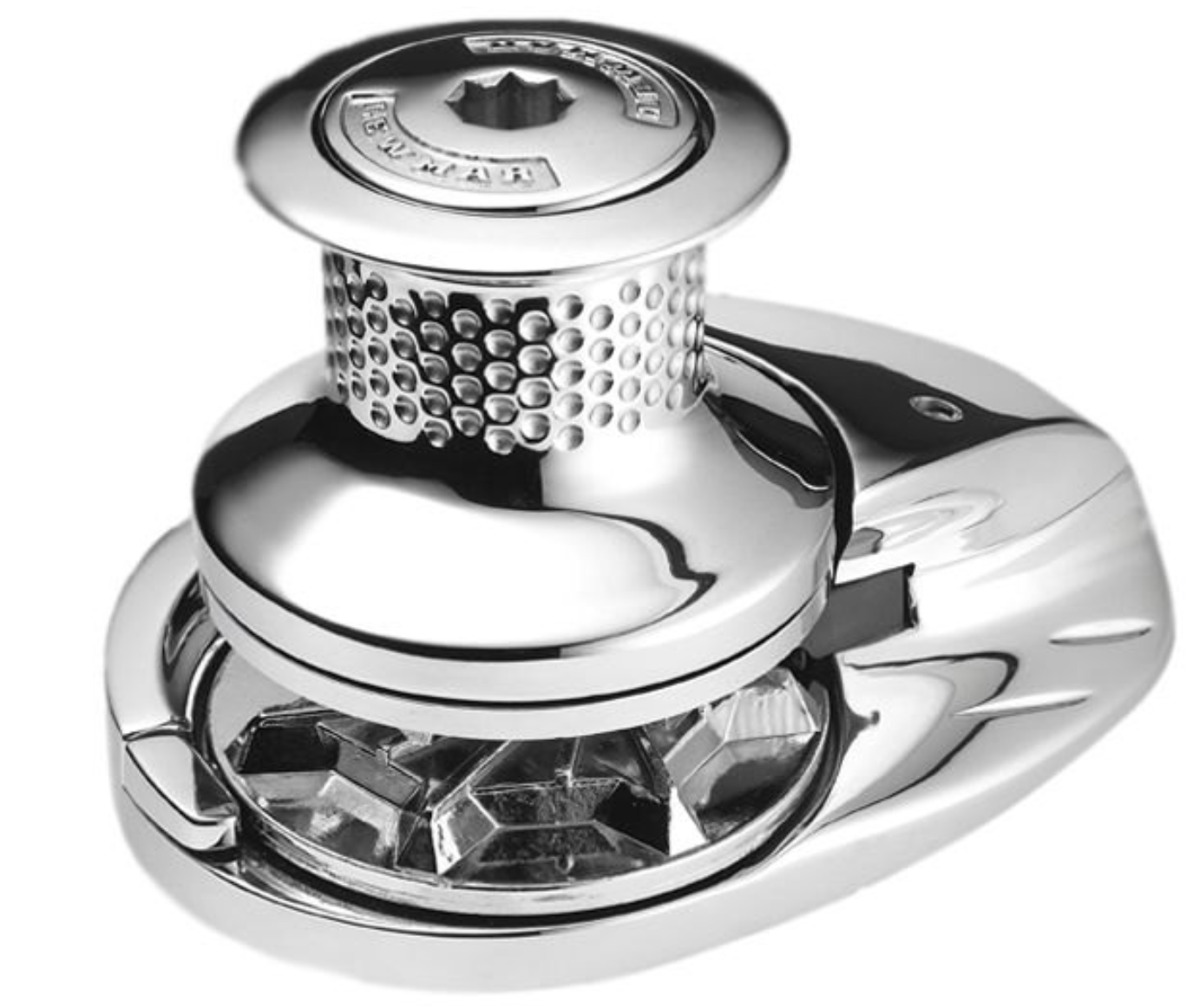

I have a Lewmar V2 vertical with the drum kit...I haven't used it yet because we've been in the yard, but I'm guessing the drum turns with the gypsy for line rode (maybe?) which would mean I could use it as a fairlead of sorts to a bow cleat. Even if I just tied the line from the chain to the drum I don't think it would put pressure on the gears, it would be a straight-on pull, no torque.

I agree with your plan. I have the V-3. Love it. My concern is with the anchor moving about as the boat bounds thru a wave. The drum is stout, but it is a length above the deck giving it a bit of leverage if it is yanked about while attached to 35 lbs off the bow.

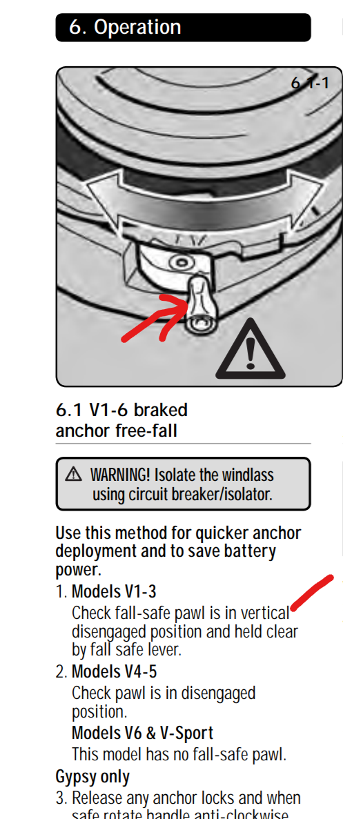

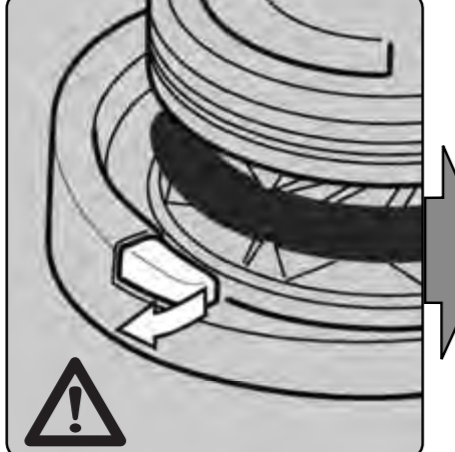

Cool, I've read good things mostly. Maybe you could help me! I can't figure out what this is for. Mine looks like below, but that isn't consistent with what the manual shows for the V1-3 models. It looks more like the V4-5 model pawl which just has engaged or disengaged. As-is, it doesn't appear to engage (like a ratchet) but maybe that's only the case if you have the manual recovery kit, which I don't think this one has.
