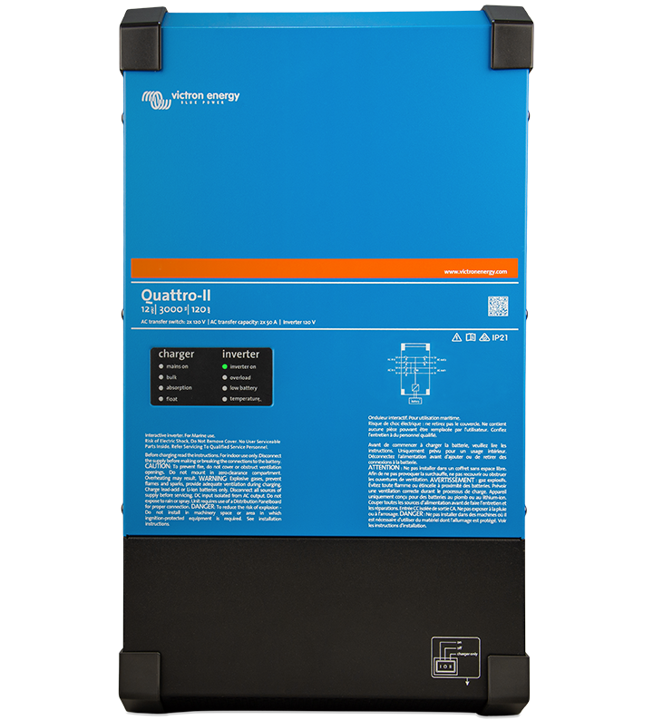

Just found a Victron Quattro II inverter/charger that might work. $1600. Let me know if you have any thoughts on this.

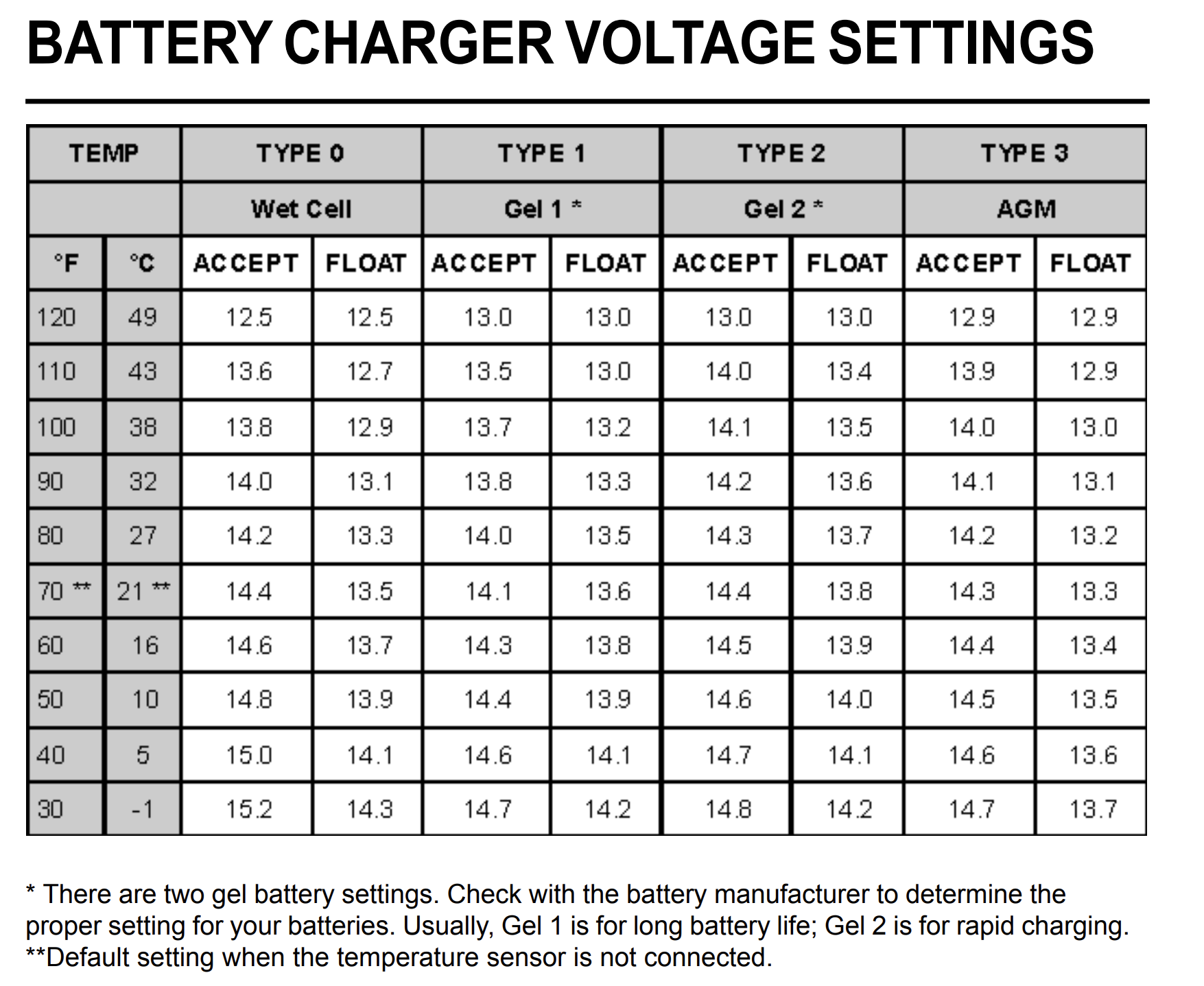

We have the older generation Freedom 20 from 2008. I couldn't see anything in the manual that mentions lithium charging or any advanced programmin.

From that long ago it will not say anything about LFP because it was not a thing back then. What you need to look at is the bulk, absorb and float voltages of the different battery types that you have available and any means of changing them if they are not suitable. You do not need any equalization or temperature compensation because they are not suitable for LFP. If you Freedom has a temperature probe it should be disconnected because they raise the voltage settings. Can you post the page from your manual that lists the different voltages for the battery types?

I'm not sure that generation is adjustable in any shape or fashion.... he would have to pick one of the pre-sets, all of which would be a compromise with LFP...

AGM type 3 would work great with the temperature probe disconnected. It defaults to 70º so it will bulk and absorb at 14.3v which is 3.575v per cell. This is safely under the max of 3.65v but close enough to get balancing done. It then floats at 13.3v which is a very nice float level.

According to Epoch, the batteries should bulk charge at 14.6 volts and absorb at 14.2 volts. Would the 14.3 volt setting be high enough? I guess it’s not really critical since almost all of our charging is done with solar. We are on a mooring for most of the year. We spend the summer at a marina, but don't need to plug in because the solar works so well. At times, with the current AGM bank, we need to run the generator while spending a week at Catalina, but we’re hoping to avoid that with the new lithium bank. We mostly want to avoid damaging the batteries with our inverter/charger set-up and alternator program. Thanks for the continued input.
