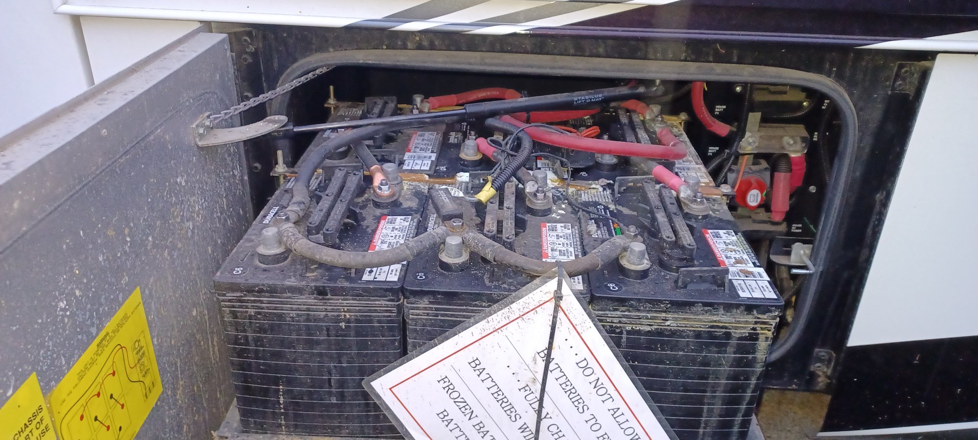

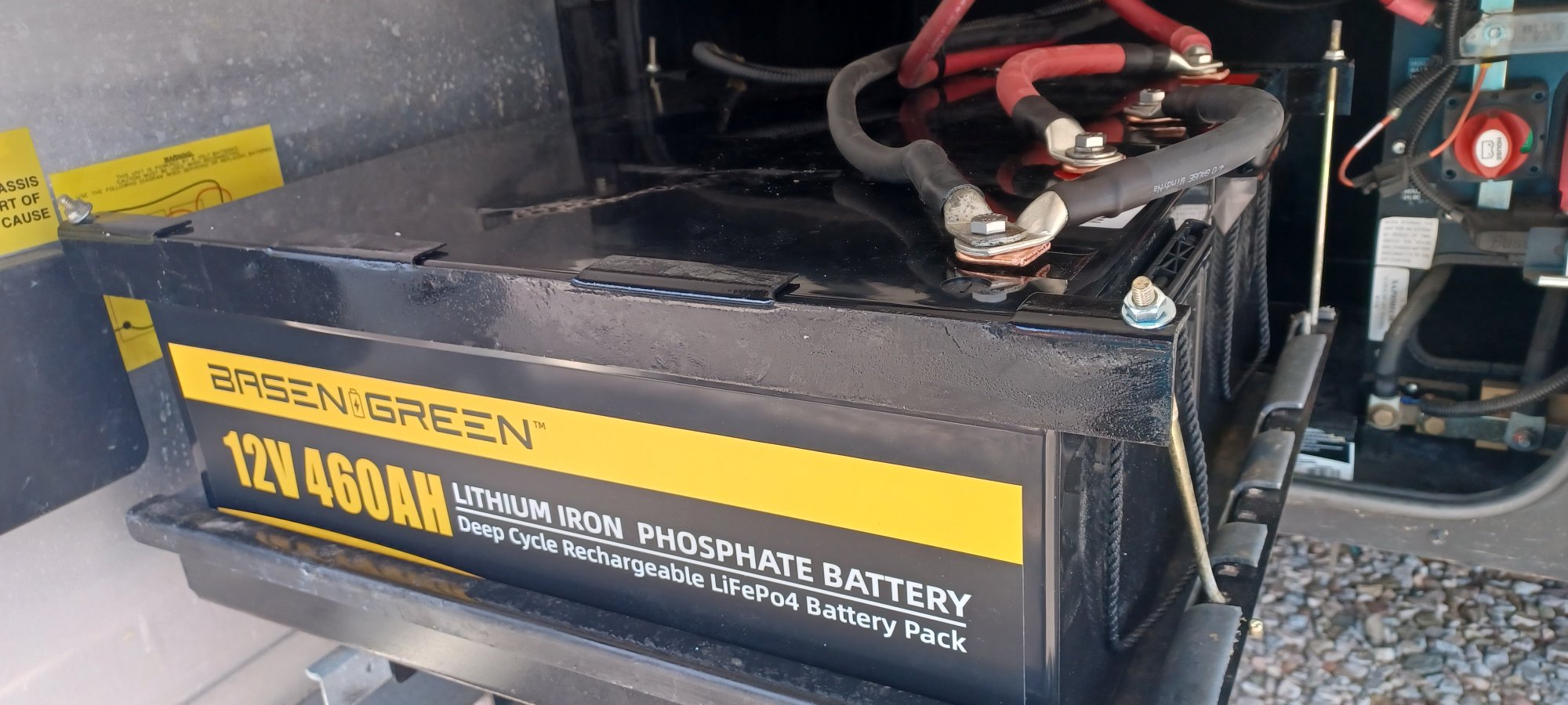

In my motorhome, I replaced (6) 215Ah golf cart batteries with a total usable capacity at just over 300Ah [W50% SOC] with two 460Ah LFP batteries from Basen Green. They cost $1200 each with all shipping and fees. After I did some balancing, they each have tested out at 480Ah for a total capacity of 960Ah and I can use about 900Ah of that so the two 8d batteries gave me 3-times the capacity of the golf carts.

..., I am reluctant to go lithium due to the complexity and expense. These boats run the thruster off the house bank requiring a properly designed system. Self sufficiency is very important down here and simpler is often better.
Depending on what you currently have, you may already have what is needed for a swap to LFP. I make the change to both my motorhome and boat and needed very little in the way of new stuff to make it all work together.
The motorhome required no changes. The charger was a 2000w Magnum and it was easily set for LFP and the 90' round trip run of wire from the engine to battery compartment limited the current to the point where the alternator self-limited.
The boat already had an external regulated alternator, so I just added a digital thermostat that turns off the regulator when the case gets too warm.
