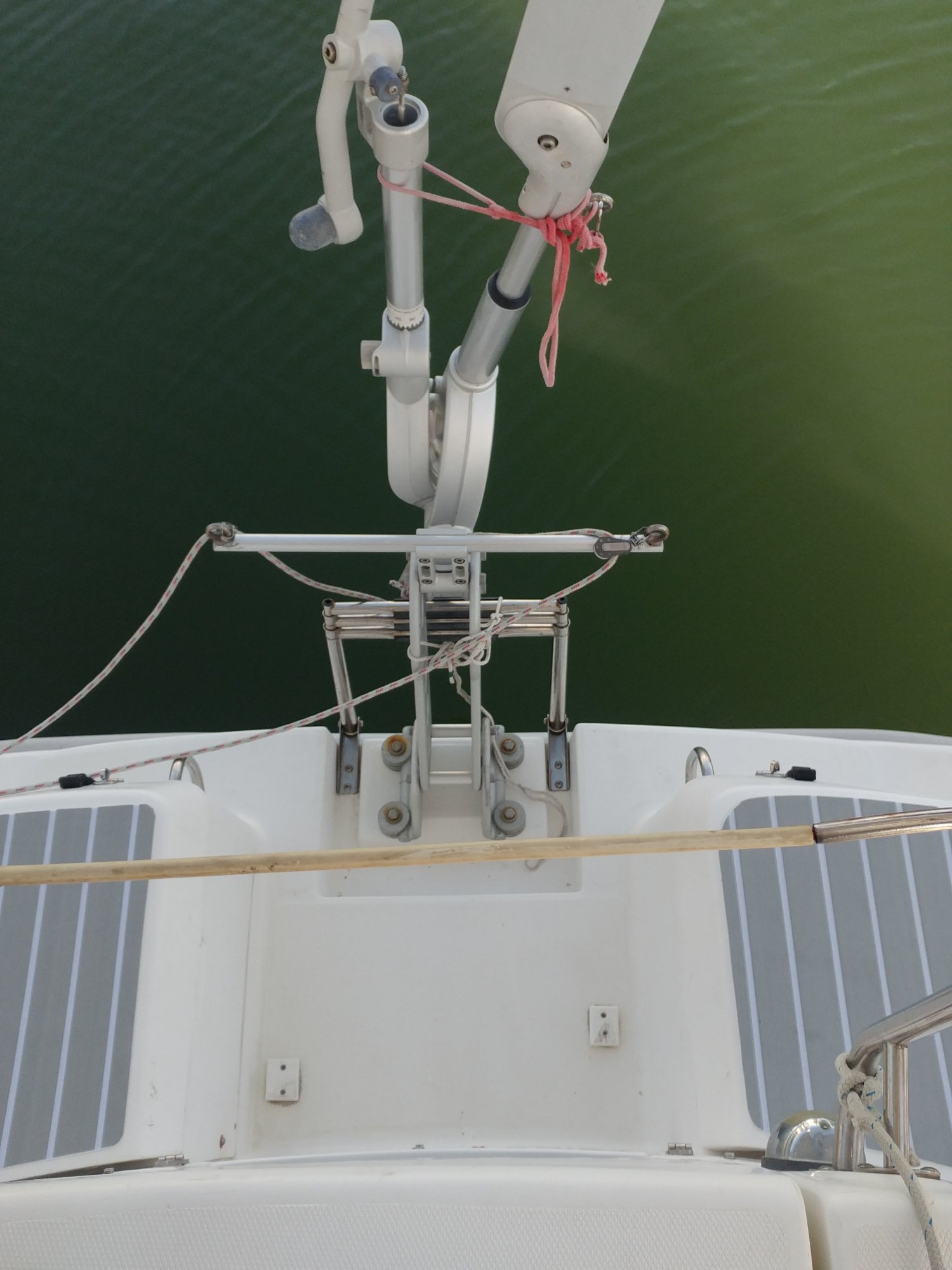

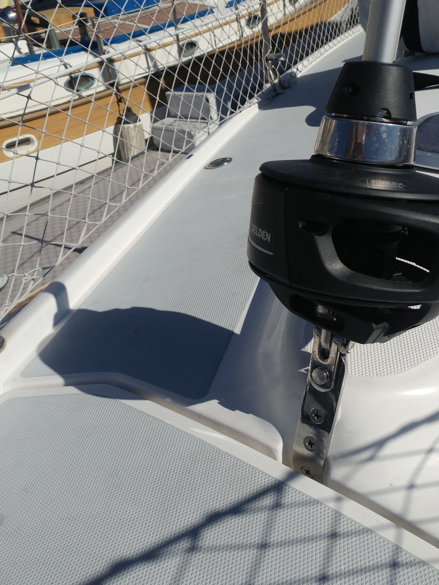

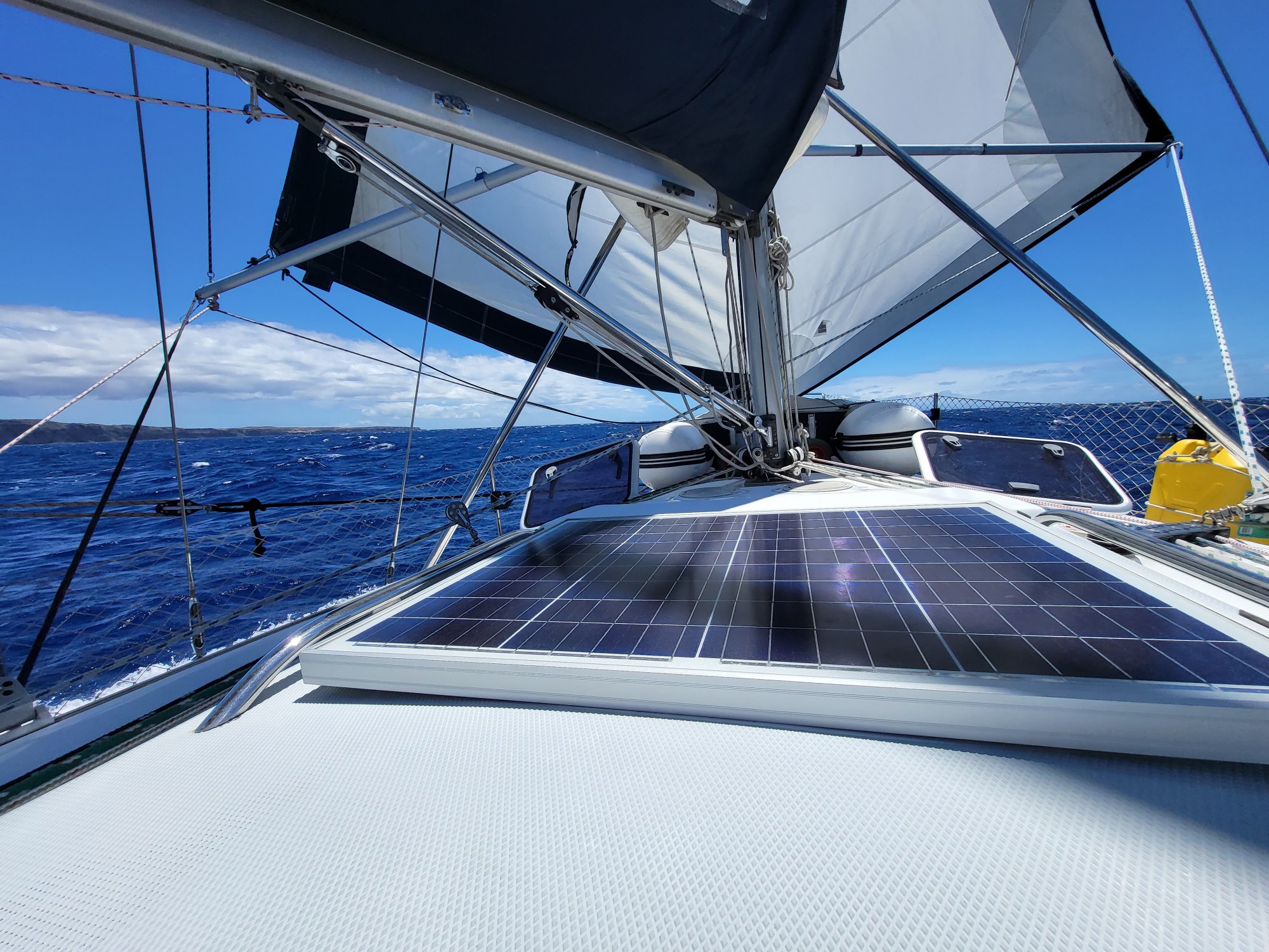

I'm going ahead and doing it. Mast comes down next week, new rigging and additions. 1st problem is no chainplate kit available, Seatek in CA will need to make custom. Hunter 410 Selden Mast.
Expensive with furling, I hope I use it enough or need it to justify, I really want that extra forestay security also.

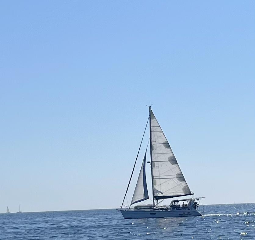

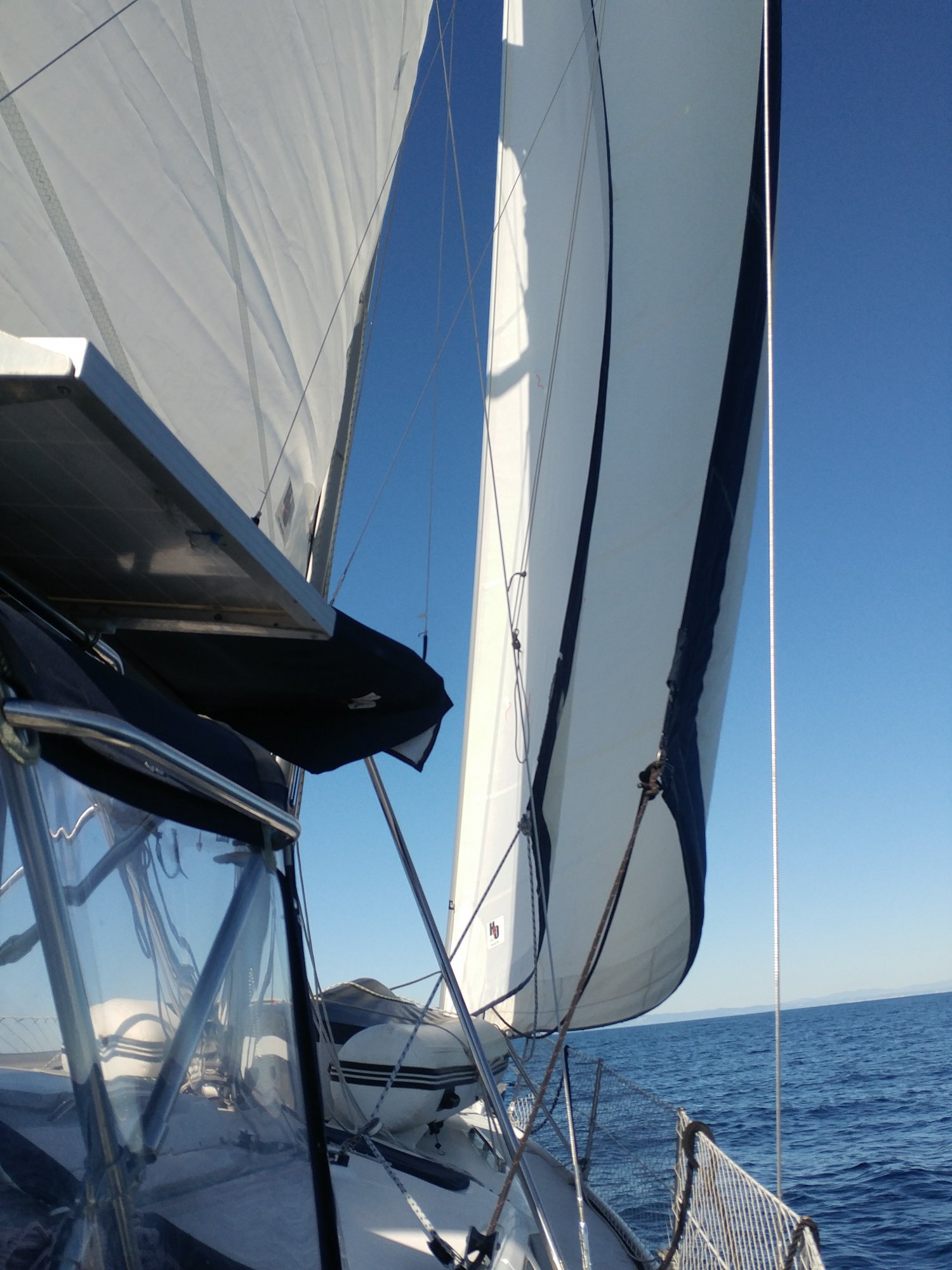

That looks GREAT! And, it's a great set-up for dead downwind! How is the custom SeaTek Chainplate after some time with the tensioned stay & load of furler? Any crazing topdeck? Any issues with tension on the rig? Any recurring noises? Clearly, you use it- so, the upfront cost has paid for itself.
Aug 18, 2018
163
Hunter 410 MDR

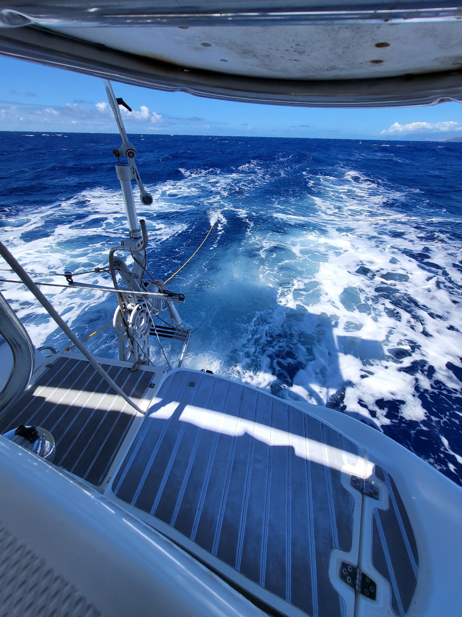

No crazing or noises I've noticed yet. DDW in up to 26k, no main is fantastic! May get a 2nd pole. Inner sail real easy to handle, I don't even need a winch handle.
Had some issues adjusting forestays so one or the other does not go too slack depending on what you've got up and wind force.
Bad things are many more lines on deck and obviously the problem tacking with regular jib up.
Good, on top of what I expected, if the wind comes up i roll out and blanket the jib with the Inner foresail and it rolls up easier, same idea as using the main to do that but even more effective.

Wow, great job you have done, Windpilot !!
I'm tented to do the same on my 99 H410 but I have several open questions. Can you share some more pictures of your setup ?
For instance, how do you routed the staysail sheets ? and the furling line ? have you installed additional sheet blocks on deck ?

B&R rig does not need running backstays, i don't have the dimensions, I had my sailmaker design it.
There was a lot of deck gear I added, extra organizer on deck, double turning blocks for the sheets etc.
But well worth it.

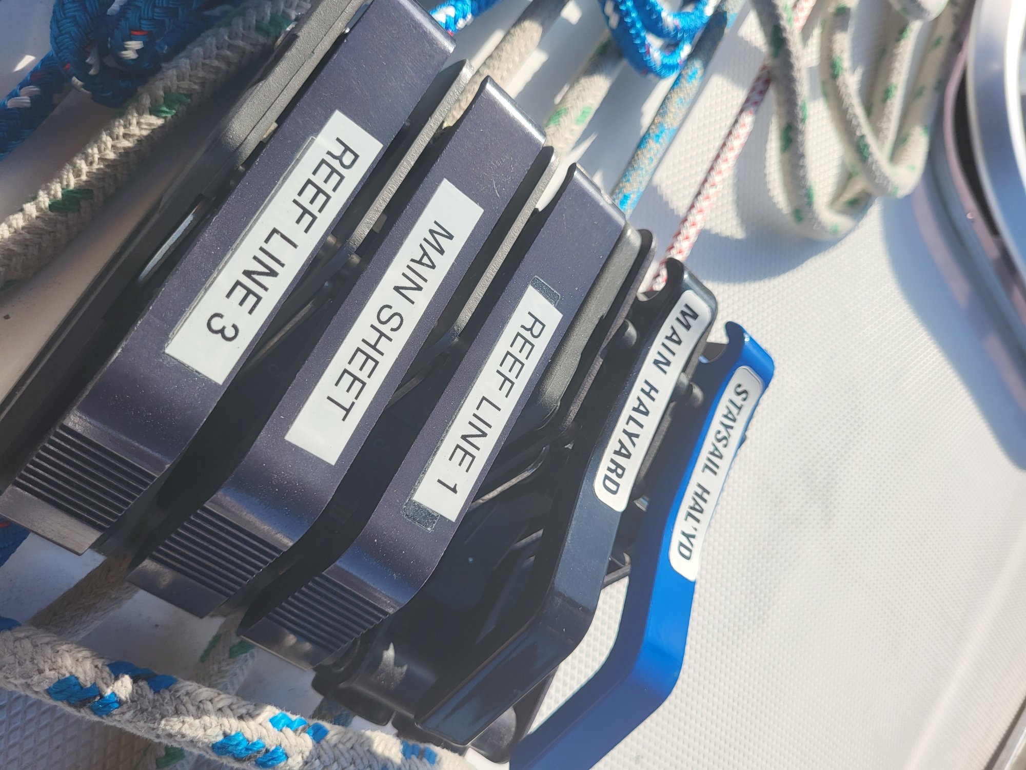

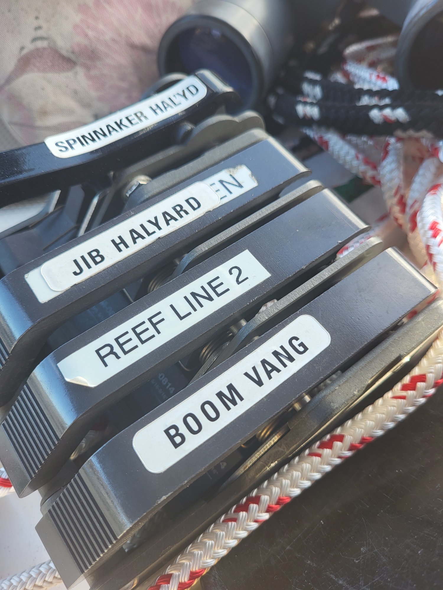

Couple of questions, ....was there an aluminum plate for tapping where you mounted the chain plate for the new forestay?
Also, sounds like you went for 5 clutches a side.... I'm guessing staysail and Spinnaker halyards, what are you using in the 5ths?

The forestay spot did not have anything imbedded. I was disappointed.
They used large washers. It seems to be pretty thick glass in a structuraly strong area at the anchor locker bulkhead.
I just sailed 2300 miles to Hawaii from California in June, used it extensively, no issues, up to 25 knots wind 19 days.
Will sail back in a couple of weeks, I'll let you know I had a problem.
As you see on the clutches, I have a 3rd reef line on for this trip, lots of lines to contend with on mainsail but so worth it for the third reef.
Often had 3rd reef in to steady rolling, keep the loud flapping/banging of main while rolling in lighter air while both headsails were polled out going DDW.
I have no kind of light spinnaker because I am, from past experience, very afraid of a forestay wrap 1000's of miles away while singlehanded. Mine is a set it and forget it system if I'm using the windvane, allows me some rest. Also easy to reduce sail on any point at any time. Inner foresail is easy, don't even need a winch handle most of the time.
