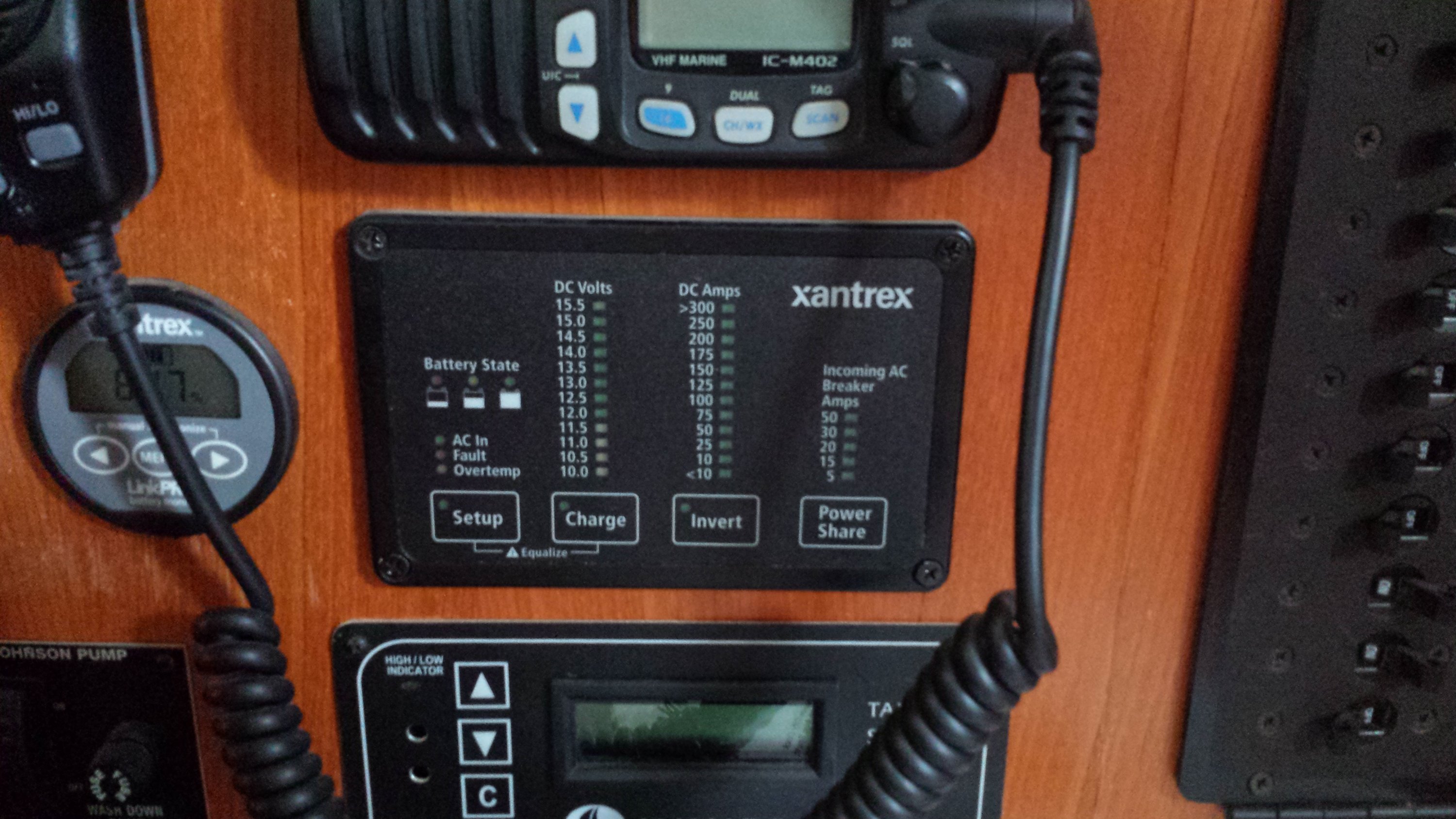

Interesting.... ours is a 2006 and here is what the original readout looks like in the lower part of the picture attached?

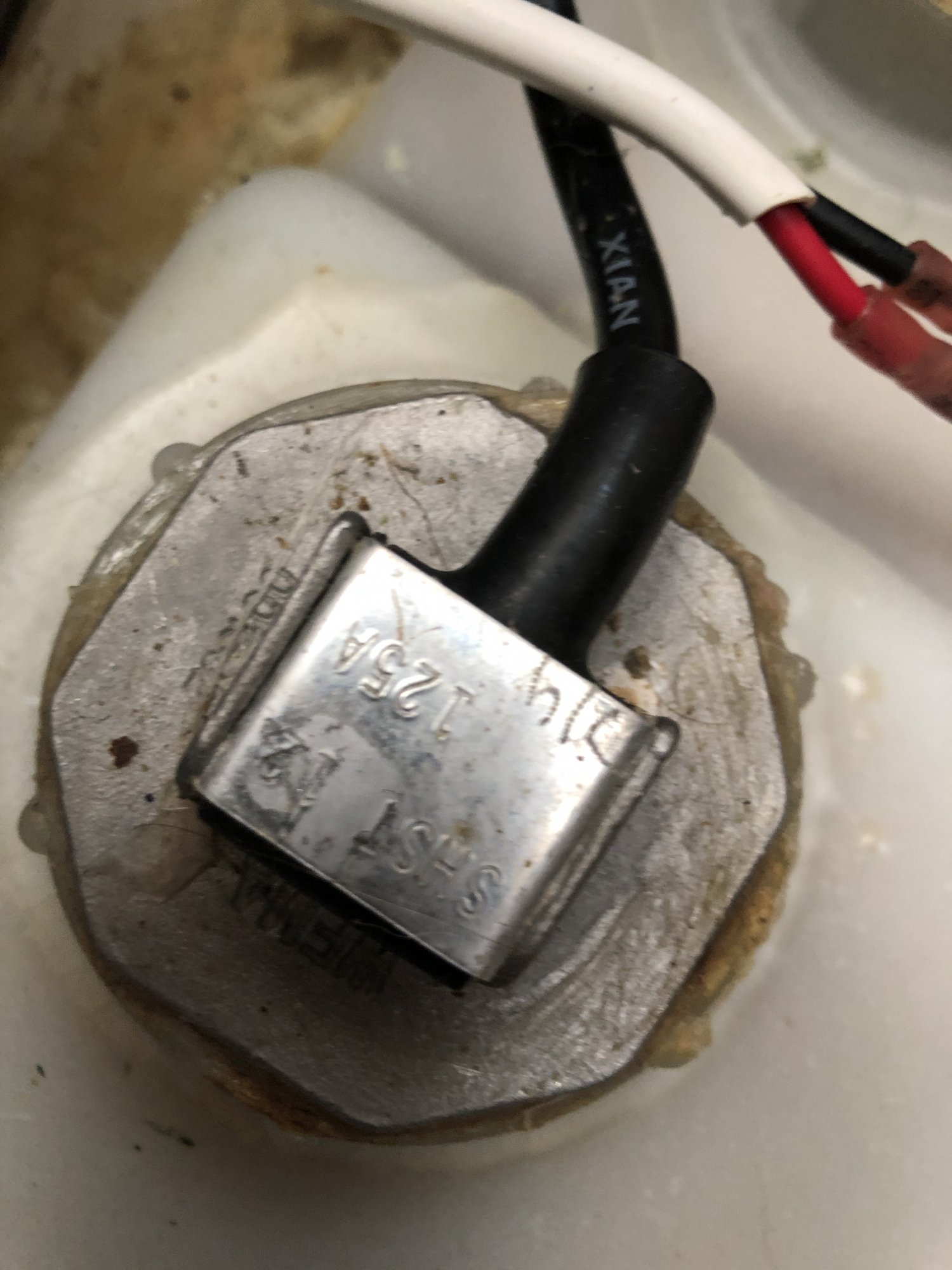

So I have a 2007 hunter 41 and need to replace the holding tank sending unit, I have the new sending unit which is the same length but the top looks different ( new is round with screw holes, old is hex and no screw holes). not sure how to remove the old one and hesitant till I get advice on removal and if I might not have the correct gauge. The new one seems to have the same model number what 12. Picture attached of the old one. many thanks Bill86D912C2-B211-4D61-8EA3-8F32ECAB1542.jpeg
Apr 1, 2018
68
Hunter 41AC 1 Charleston
So I have a 2007 hunter 41 and need to replace the holding tank sending unit, I have the new sending unit which is the same length but the top looks different ( new is round with screw holes, old is hex and no screw holes). not sure how to remove the old one and hesitant till I get advice on removal and if I might not have the correct gauge. The new one seems to have the same model number what 12. Picture attached of the old one. many thanks BillView attachment 175781
It appears you have a non-metallic hold tank, so it is bedded with some sealant
By the SHST on the picture, this is most likely the sensor in the tank.
WEMA USA
You can Call Wema then...
You can send your picture to Wema and they will tell you the rest of the info meaning and how to install the new gauge.
Jim...
PS: the 12 should be the length of the probe in "inches", I am guessing
JamesG161
Feb 14, 2014
7,815
Hunter 430 Waveland, MS
I am guessing again, but I have the 8" version.
The top Square part is threaded into the glued in base. You can verify that by looking under the "Square"
If it is threaded, then using a channel lock pliers, you can remove the old one and then thread in the new one and make sure the wires match.
Jim...
PS: The new "bracket" is meant for more space on the tank to install it. My bracket worked fine on similar install on a metal water tank.
