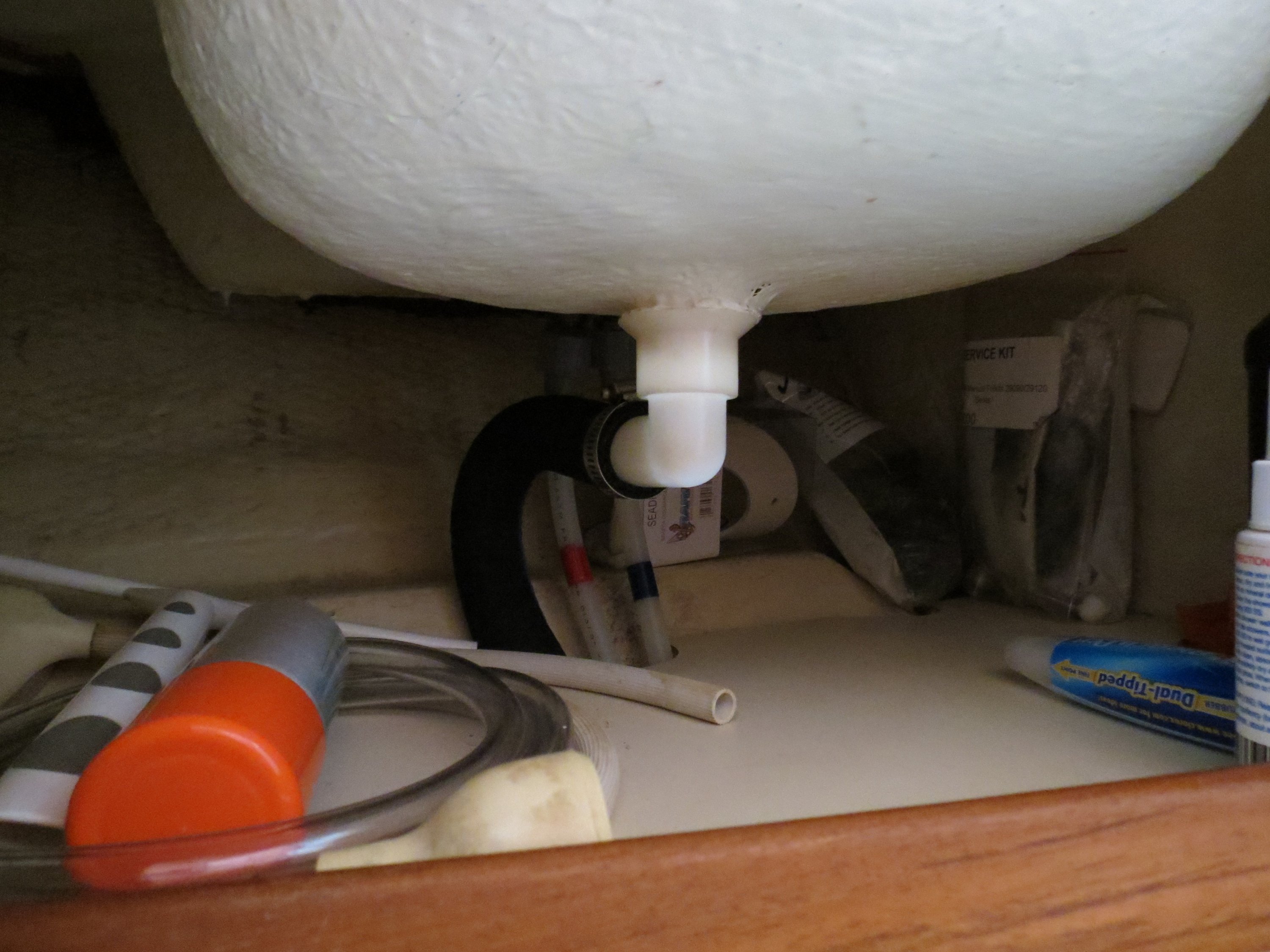

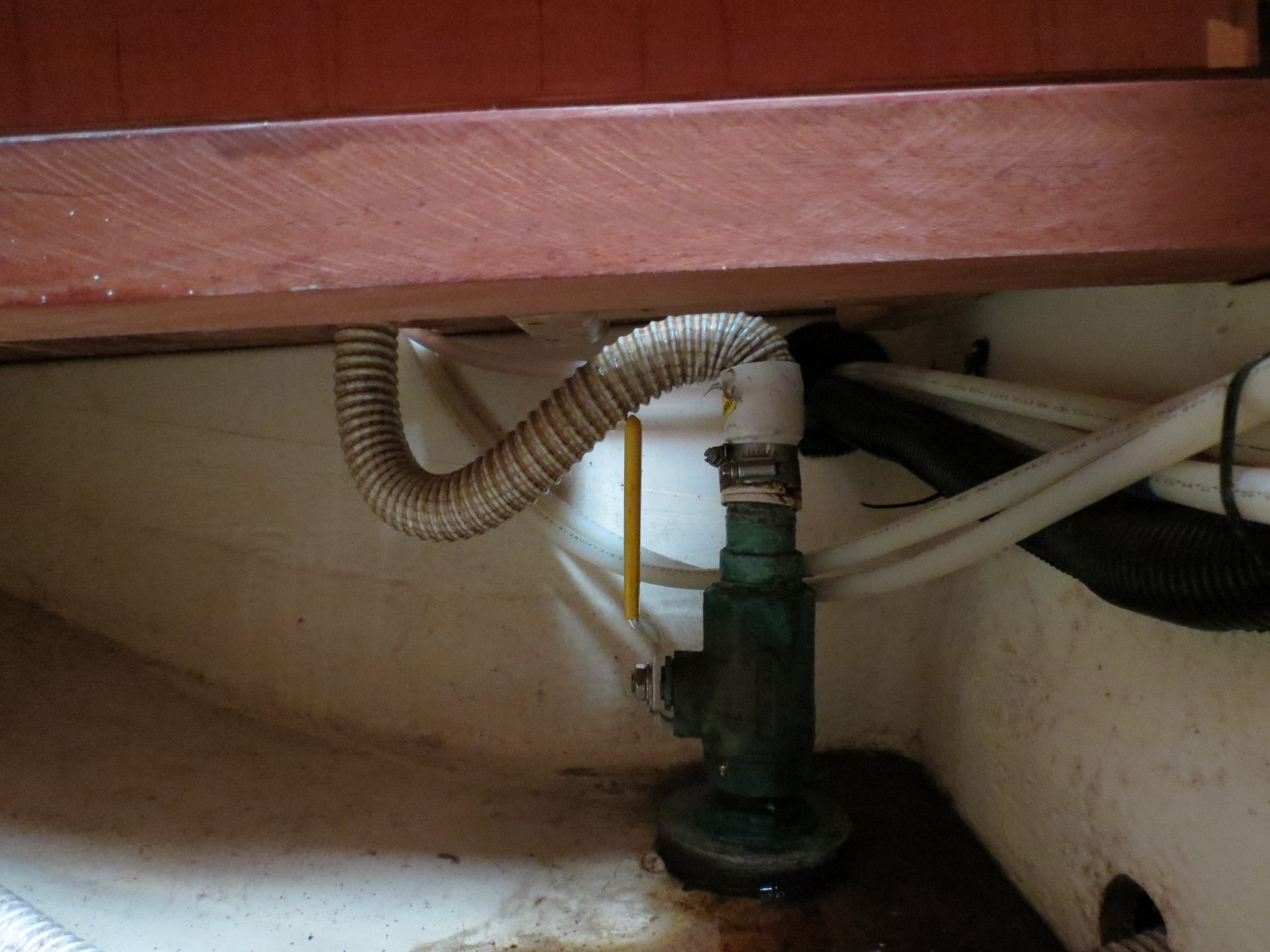

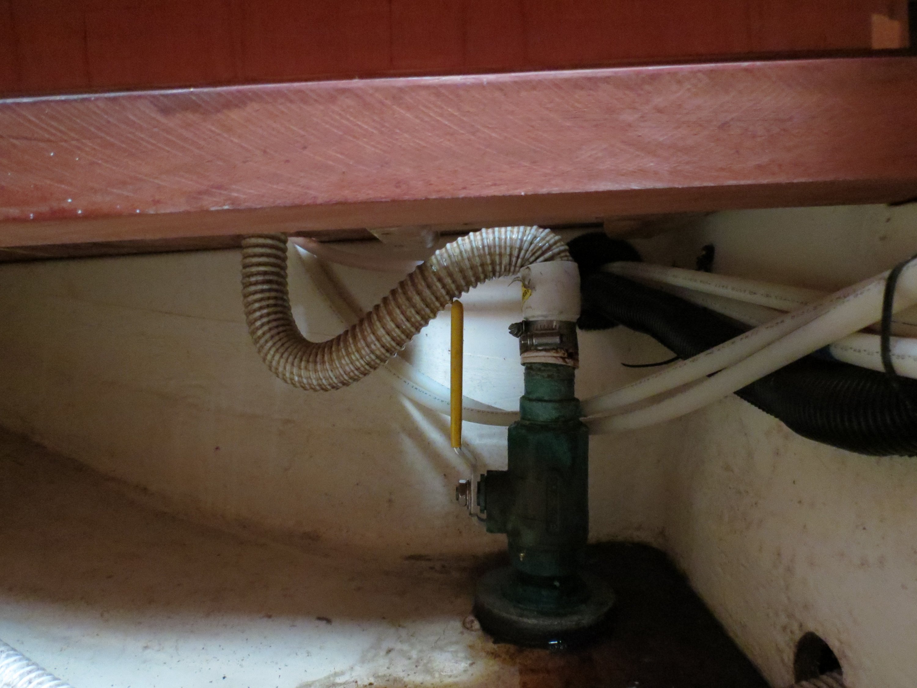

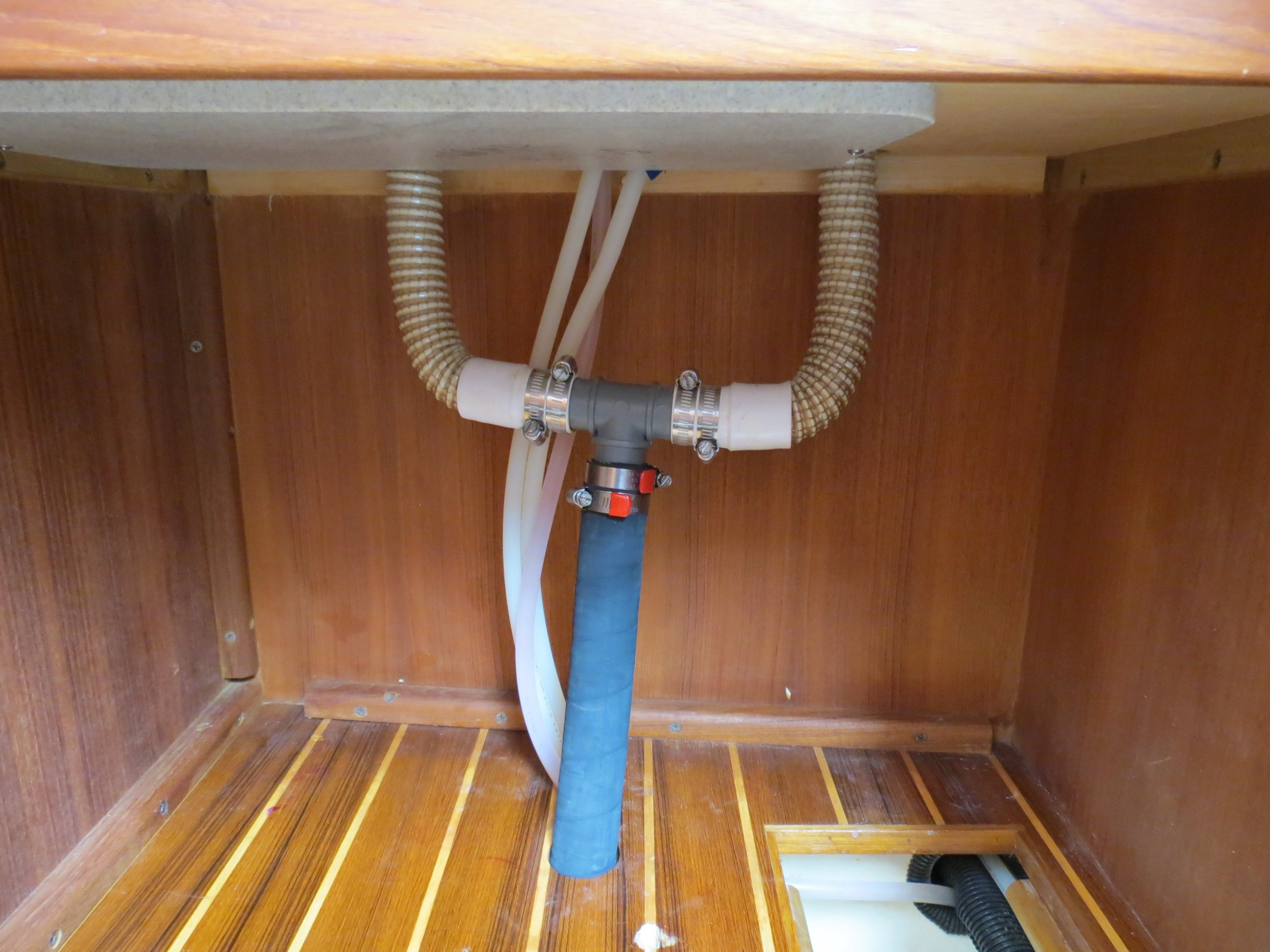

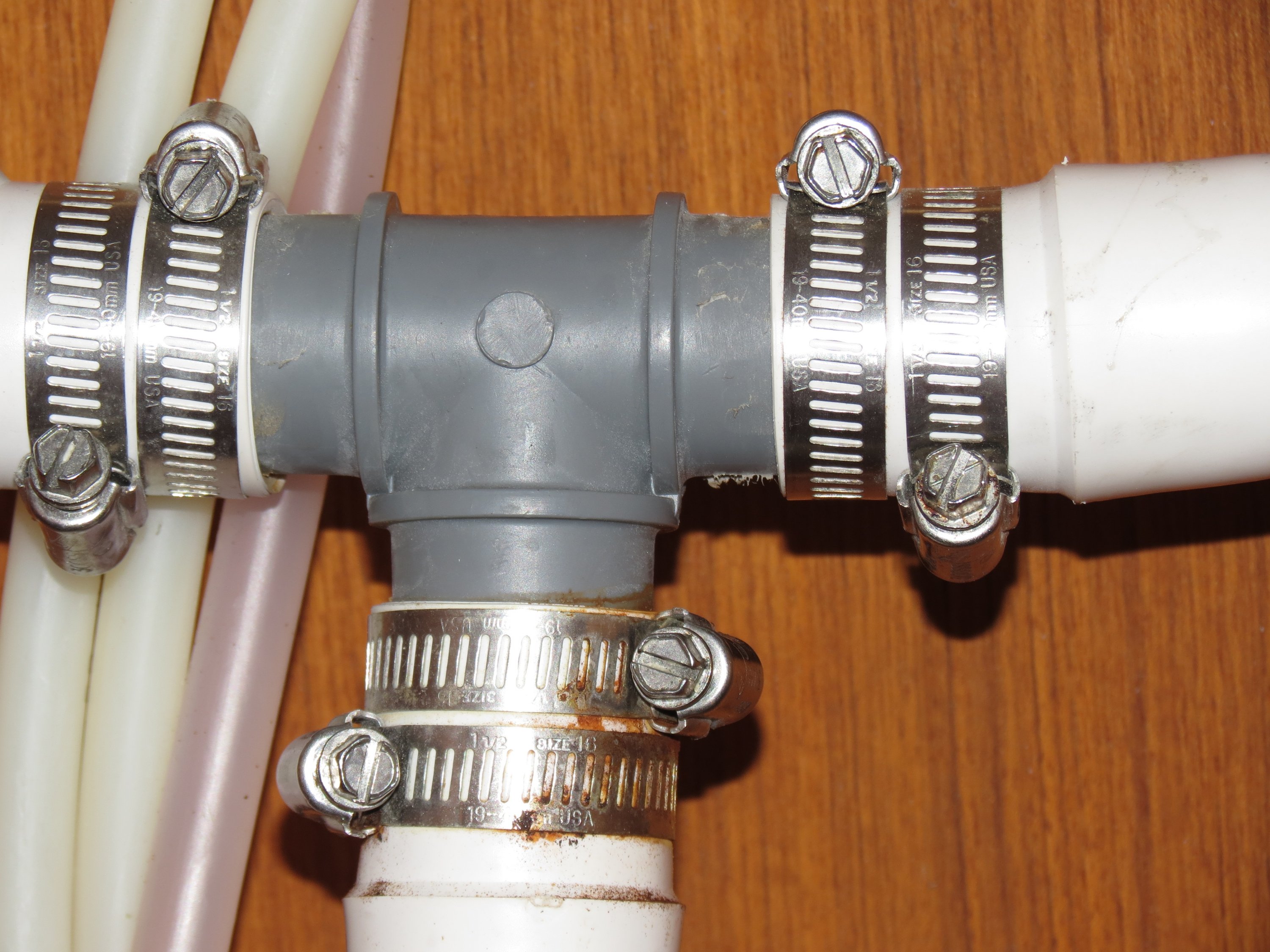

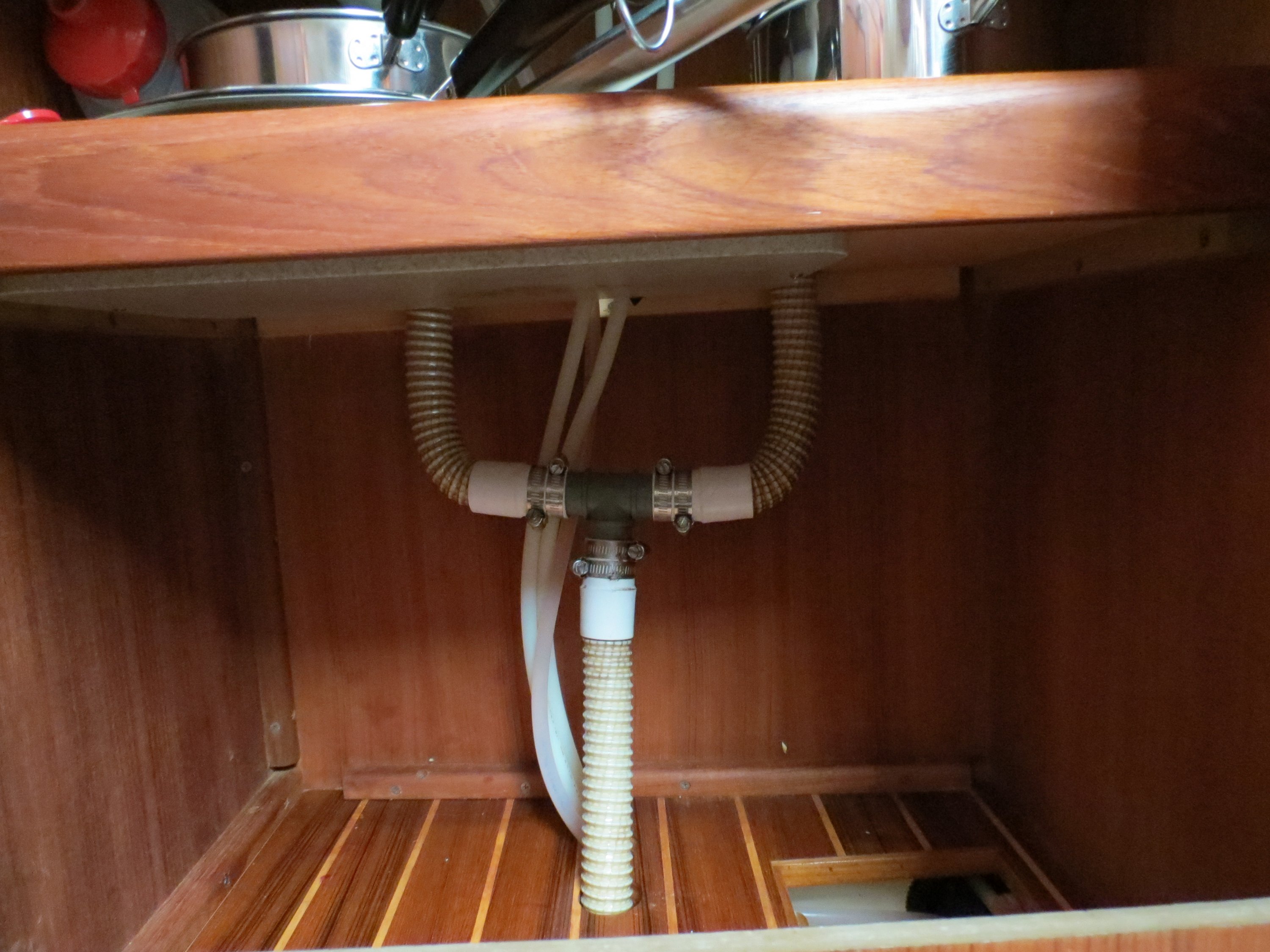

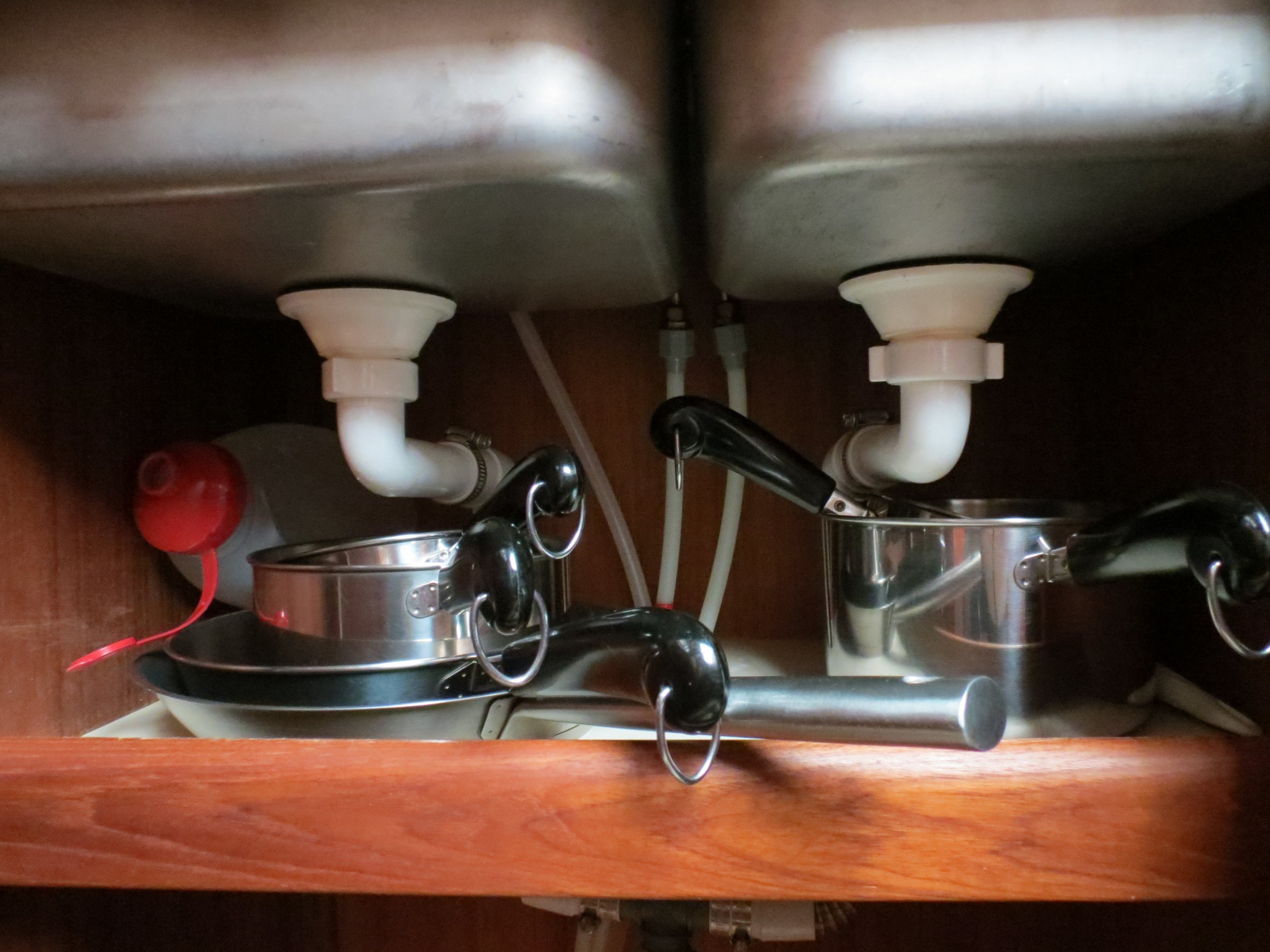

An update for the h40.5 owners:
At my fall decommissioning, I took a closer look at the galley hoses and thru-hull. Attached are pictures of everything.
Here is some information for those of you who are going to replace the corrugated hoses. The OD of the sink tail pieces is 1.25". Some of the info in my original post is wrong- First the hose is connected to a straight cuff, not a right angle cuff as I originally thought. Also this cuff is connected to a hose barb that is attached to the ball valve- I originally thought it was just a short nipple.
In my case, this ball valve is EXTREMELY hard to operate, and so I wanted to remove the valve and bring it home to see what could be done to get it to operate freely. I was unable to remove it because I did not have appropriate tools. The size of the nut that secures the thru-hull and the size of the flats on the valve are both 2". The distance from the bottom of the valve nut to the bottom of the valve is 3/4". This means that the wrench on the thru-hull nut cannot be any thicker than 3/4". The inside diameter of the thru-hull is 1.125". I did manage to twist the thru-hull and break the seal to the hull. I will remove this valve in the spring and re-bed the thru-hull. If I find that the threads are mismatched (NPS vs NPT) I will correct that issue also.
On the subject of hard-to-operate ball valves, most of the ones that I have do not operate easily. Out of nine valves I think only one operates easily. The galley sink valve is especially difficult due to it's hard-to-reach location. Over the years I have tried every suggestion I have found to lubricate these valves to no avail. So if any of you know of a method that actually works (meaning you have actually performed the solution) please let me know.
2016_1016_131010.JPG 2016_1016_131132.JPG 2016_1016_131226.JPG 2016_1016_131038.JPG 2016_1016_150718.JPG

Mine work fine. Not too difficult on any of them. As to maintenance: basically none. I have them lubricated every haul which is about four years on average which simply is greasing them (hopefully with a synthetic) by way of a long swab and opening and closing them a couple of times. In general I am very pleased with their durability and ease of handling.
Looking at your photo of the hose to valve, that's a pretty radical change of direction. I would thing a 90 degree barbed fitting there would be appropriate at the (small) risk of clogs.
Jan 4, 2006
7,870
Just looking at that corrugated hose and particularly that tight turn at the thru hull brings back the heebie-jeebies.
When I redid mine I had the same tight bend. Replaced it with a bronze 90 deg. elbow and solid sanitary hose. Never had a clog in all these years since.

Attached for @Rich Stidger is the detailed drawing of the ball valves found on my boat. Note, that you can replace the Teflon® ball seat and more, which is normally the anti-friction part, but the stem also has a packing glad of Teflon® too (that may be too tight). I don't rebuild them because (minus labor to rebuild) only $5 difference.
Tip: Stuck ball valve. Loosen the packing glad very slowly (don't remove it) and work the valve. It is rare that the ball seat wears out. At worse you will get a small leak through the packing gland.
________
Flex hose...
This cheap drain hose has been used, for years, behind your home washing machine. It was NEVER designed to make a piping angle greater than 120°. In other word a ≈180° turn is too much.:yikes: (post#35)
Standard piping angle fittings are 45°, 90°, and 120° (Wye).
I would use a 120° Wye for a double sink drain. Pick one sink has the potential of small food particles and the other for wash/rinse. The straight part under the "food" sink and the other sink using the angled input.
When I re-pipe, and need flex hose, normally for angles <45° and I sometime uses them for minor vibration control/isolation.

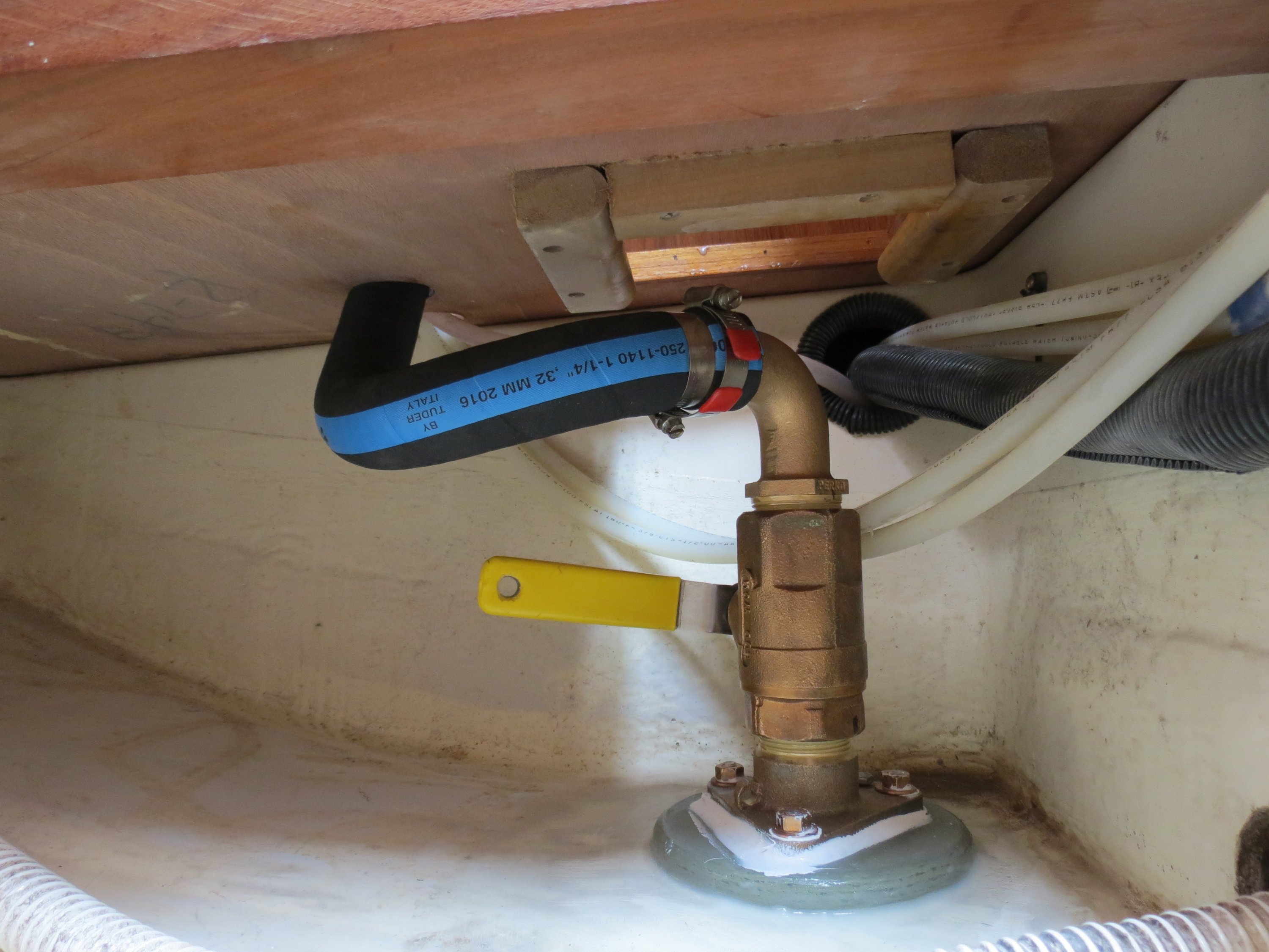

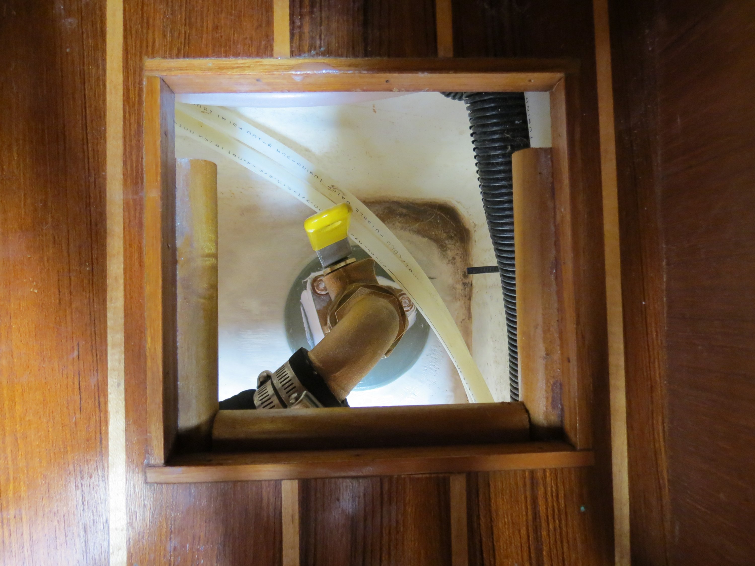

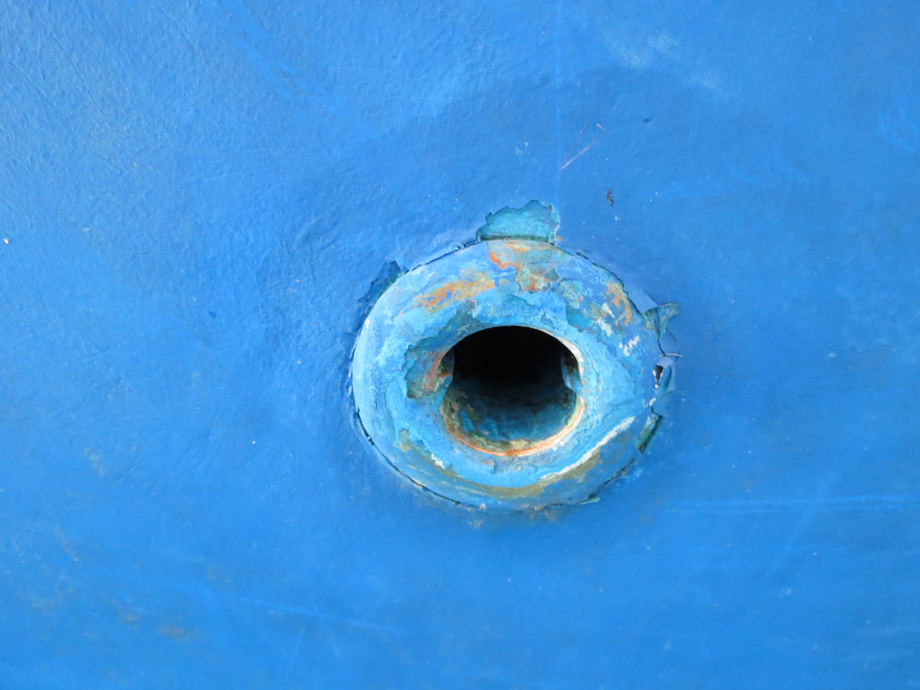

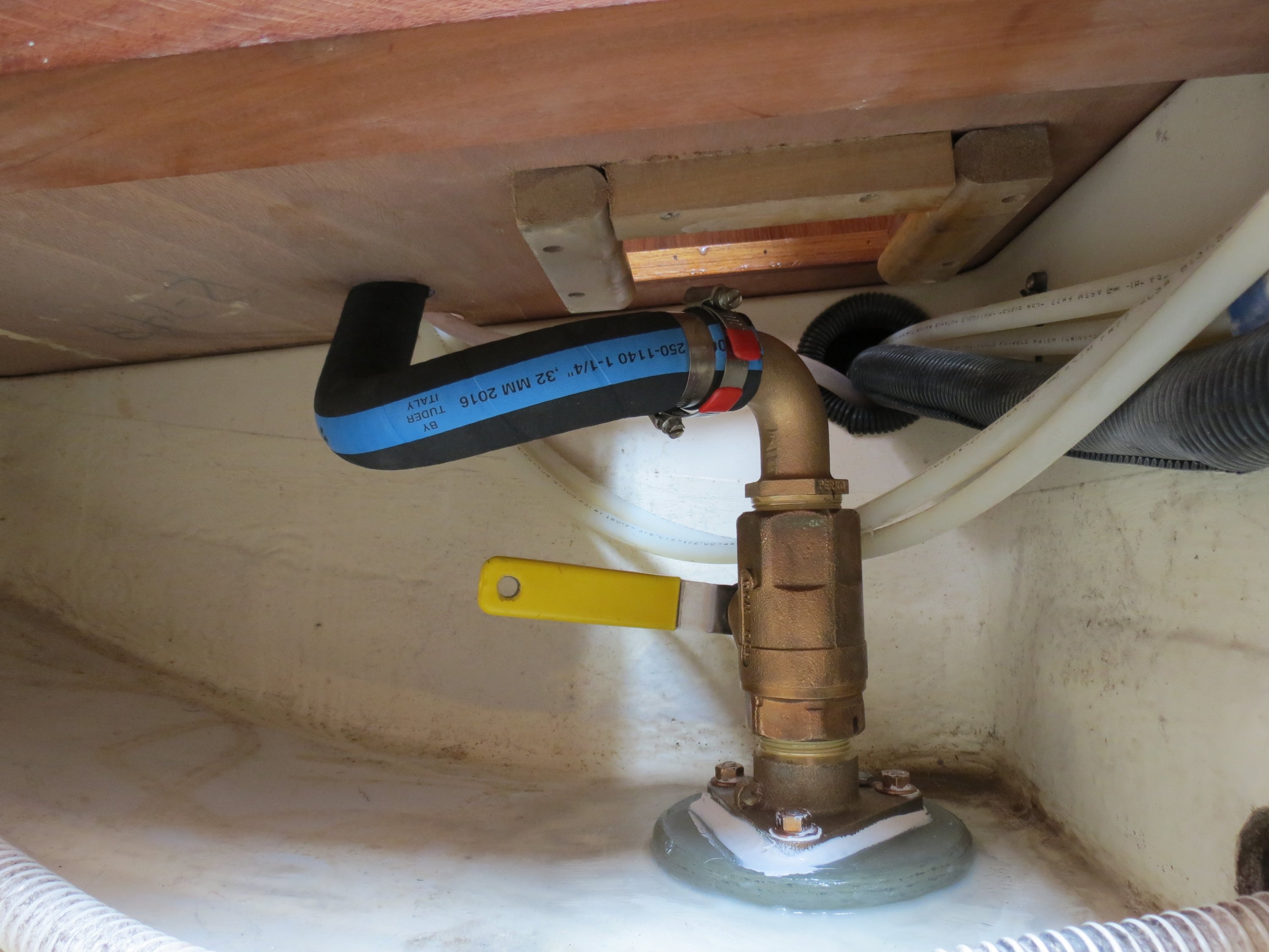

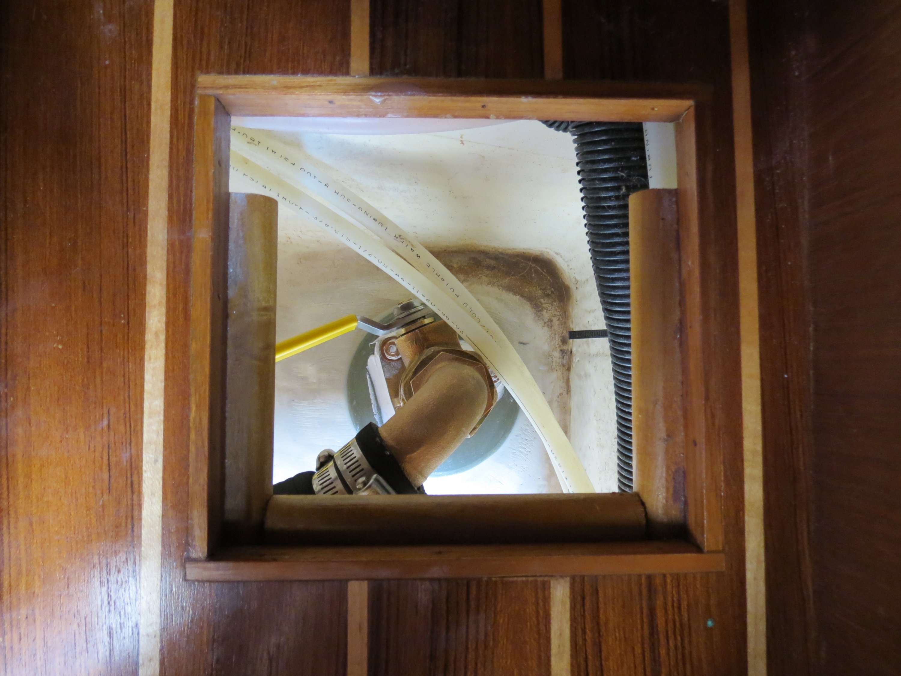

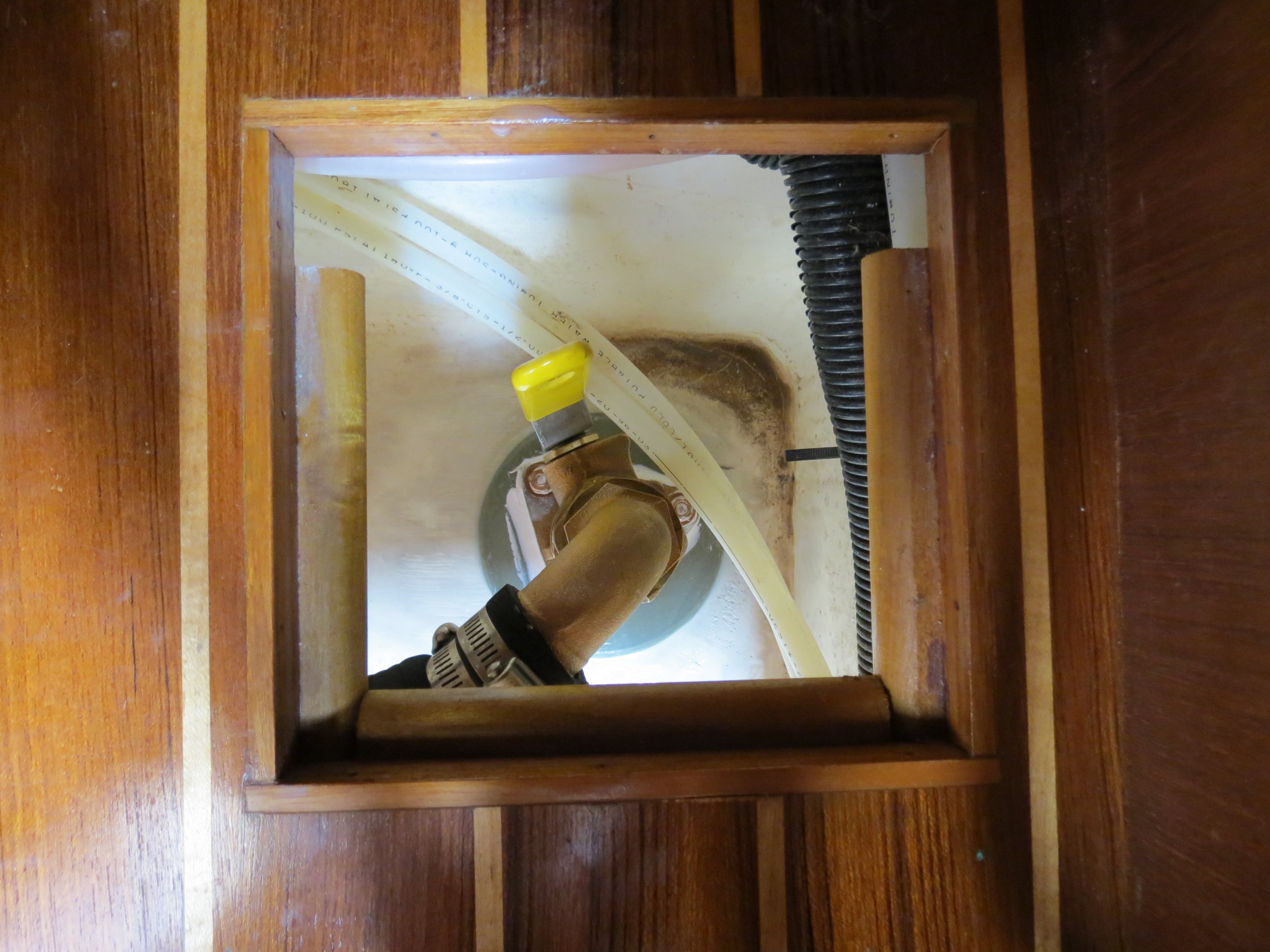

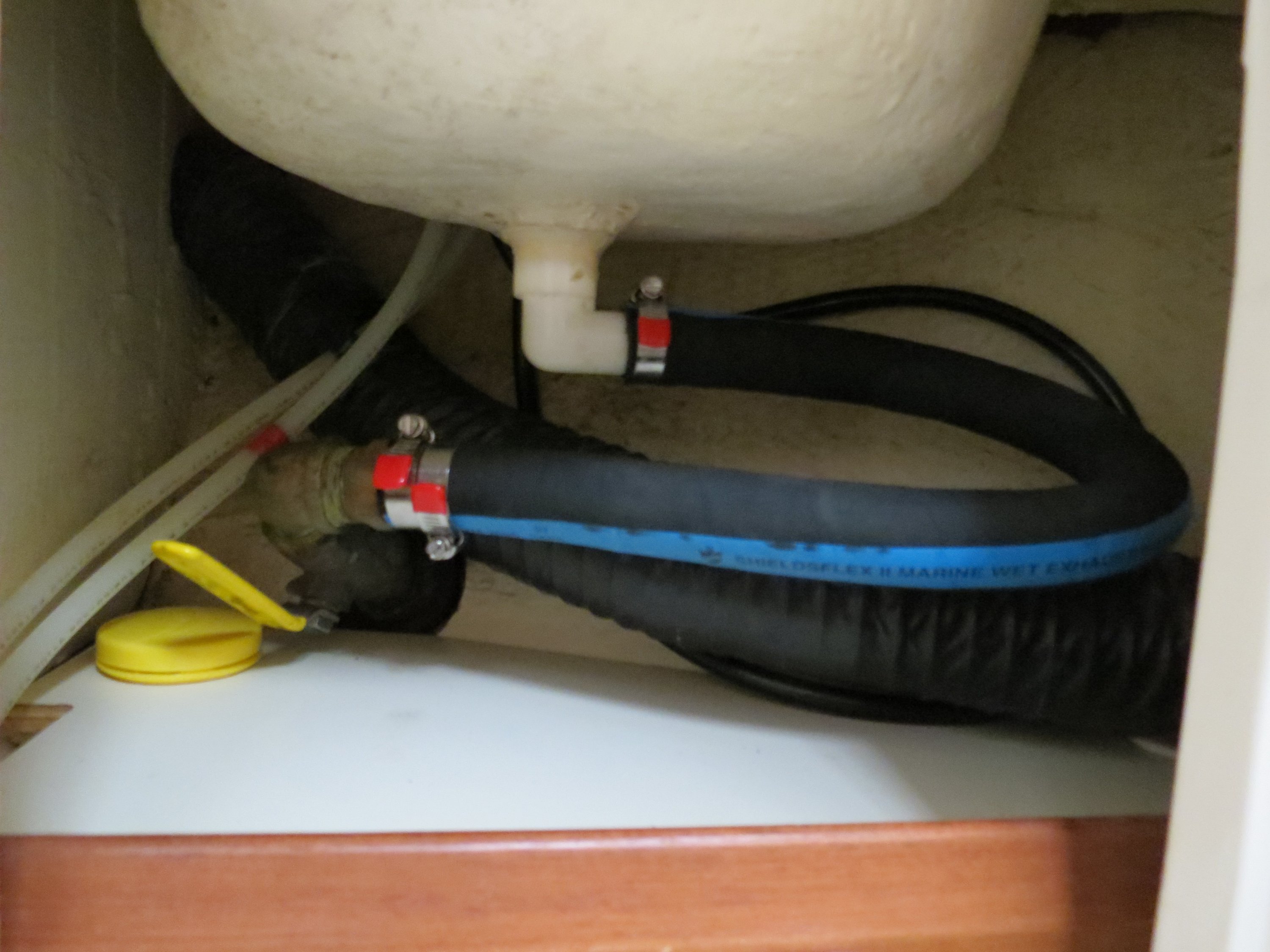

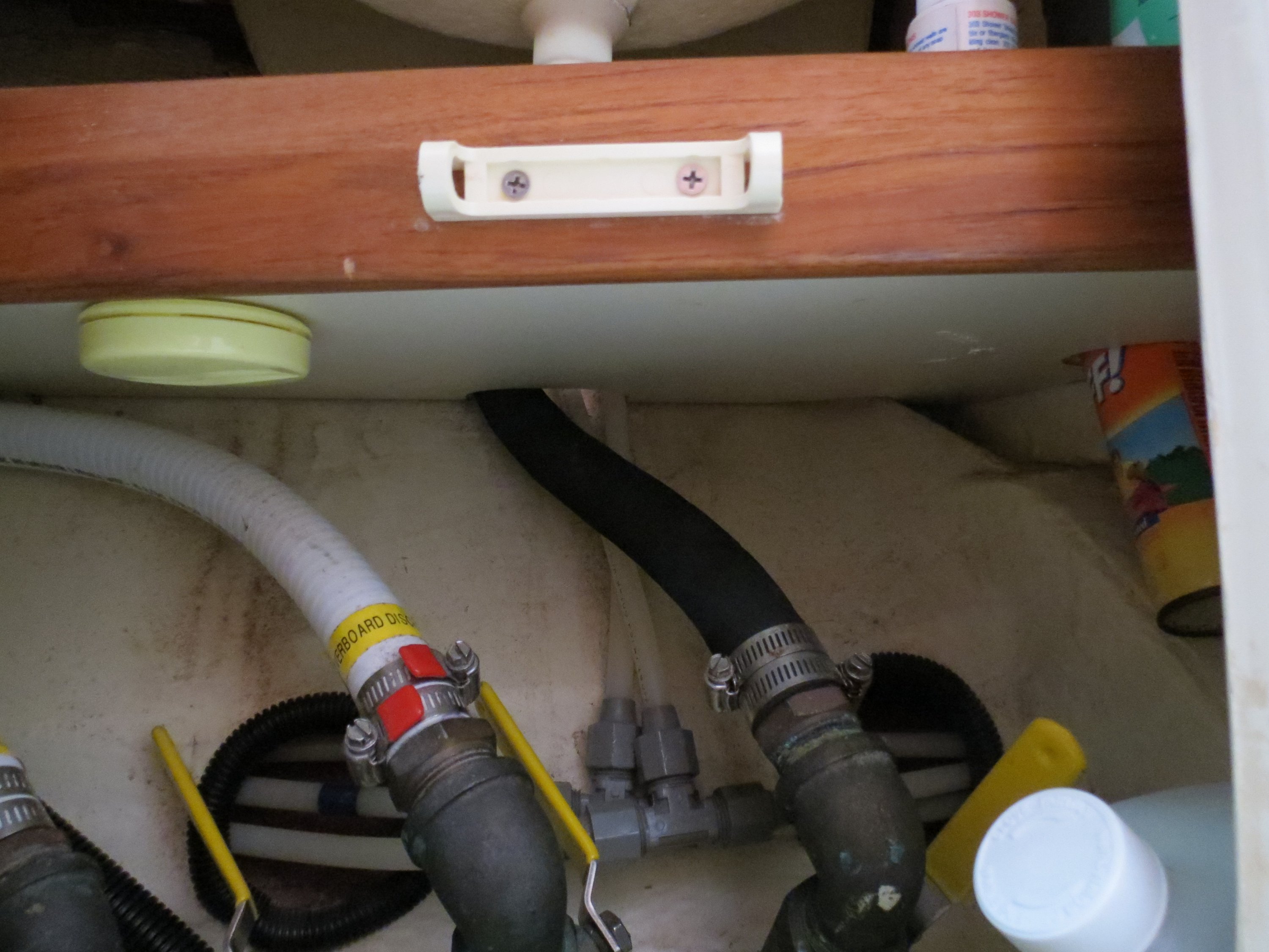

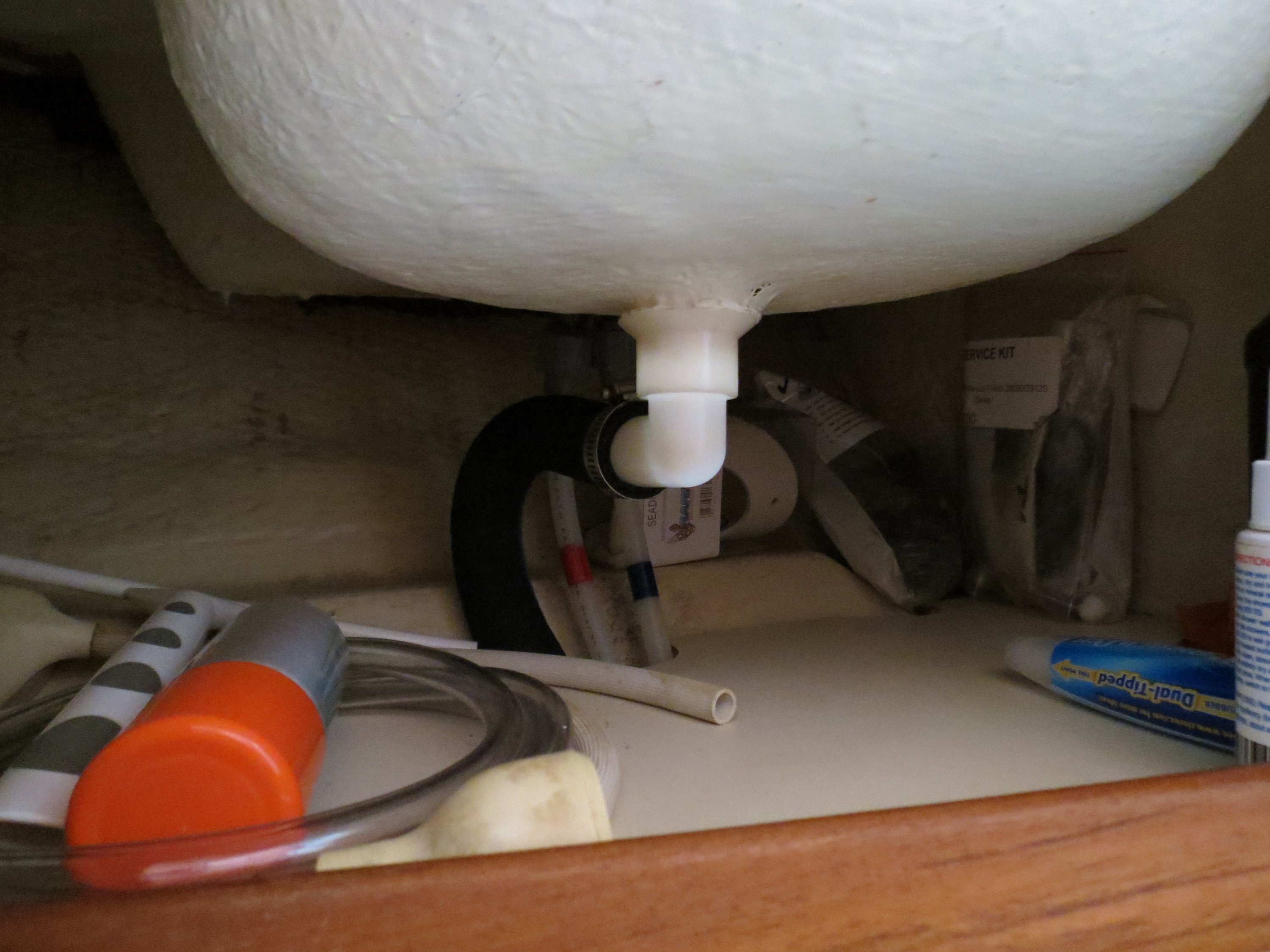

I have just completed the hose replacement for my galley and head sinks in my 40.5. The OEM corrugated vinyl hose with cuffs is not rated for below-water-line use. I ended up using some ShieldsFlex II wet exhaust hose that is wire reinforced. 1.25"ID for the galley and 1" ID for the two head sinks. There may be a better hose choice, but this was all that was available to me locally and in a timely manner. The hose was flexible enough and the internal wire kept the hose from collapsing at bends.
Additionally, I re-worked my galley thru-hull. As is very typical the thru-hull with NPS threads was directly screwed on to the ball valve that has NPT threads. The other problem that I had (mentioned in post #32) is that the galley ball valve was extremely hard to operate. Having it in a very inaccessible location worsened the problem. So last fall I removed the valve and thru-hull completely. My first thought was to simply replace the ball valve with a real flanged seacock. But after getting one of these seacocks I discovered that it was even harder to operate than my existing ball valve.
My solution was to free-up my existing ball valve. It took several weeks of soaking both sides of the ball with PB Blaster, but finally the valve began to operate much easier.
I then got a Groco IBVF 1250 flanged adapter that accepts the NPS threads on the thru-hull and the NPT threads on the ball valve. I removed the wood backing circle that was OEM and replaced it with a 1/2" thick 6" diameter fiberglass circle. After cleaning the inside of the hull and wiping with Interlux 202 and then roughing the surface, I dry-fit everything together and marked the proper alignment for the valve handle. I drilled three holes through the hull for the flange mounting bolts following Maine Sail's procedures. I epoxied the backing plate with West System epoxy, then mounted the IBVF adapter with the three bolts and bedded the bolts and thru-hull with SilkaFlex 291. I installed a 90 degree street ell on top of the valve and fitted a piece of 1.25" wet exhaust hose to the existing tee below the galley sink. This tee is above the water line so I did not replace the vinyl corrugated hoses from the tee to each sink.
Now the installation is complete and I can now operate the valve lever with one finger!

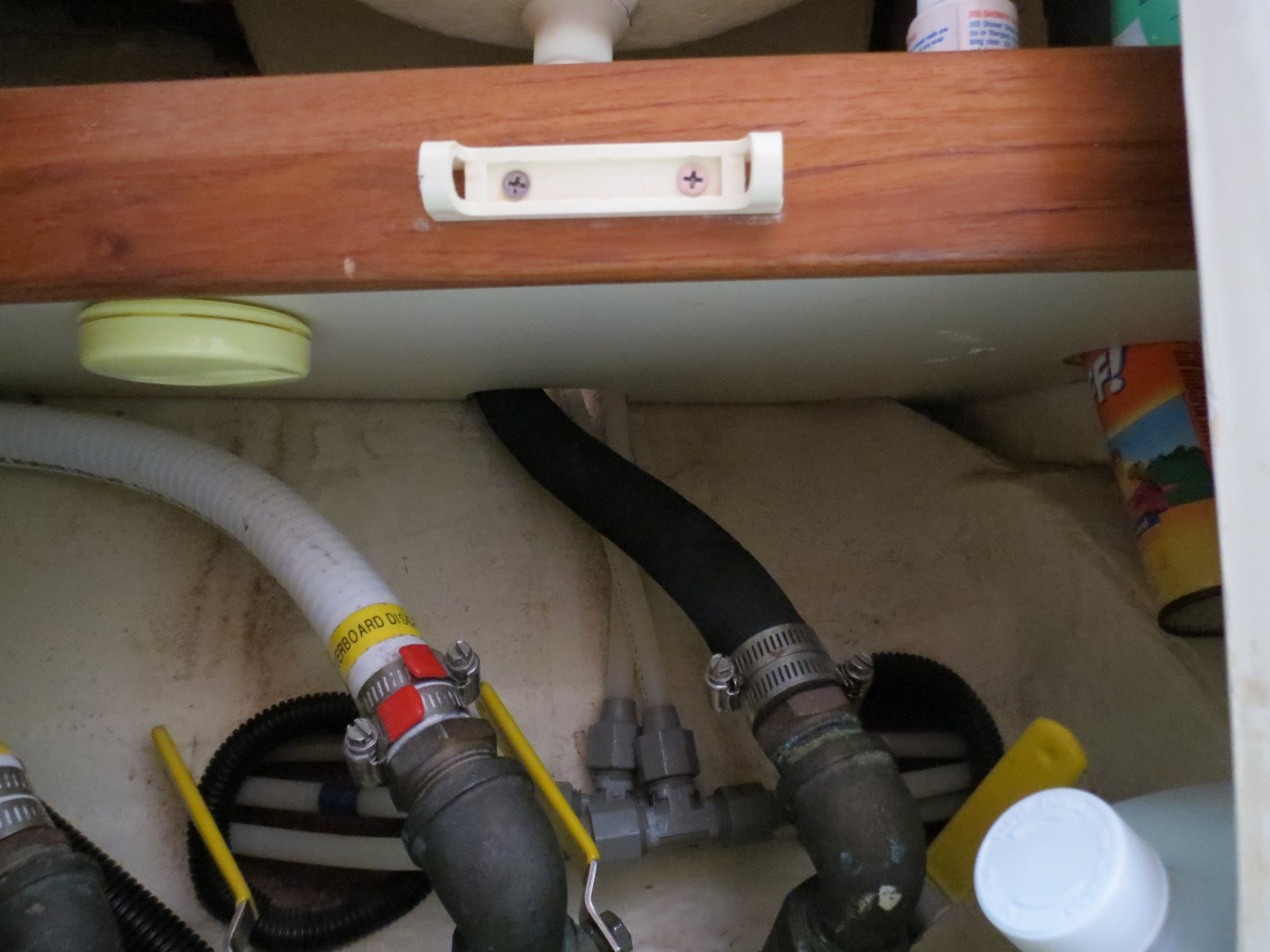

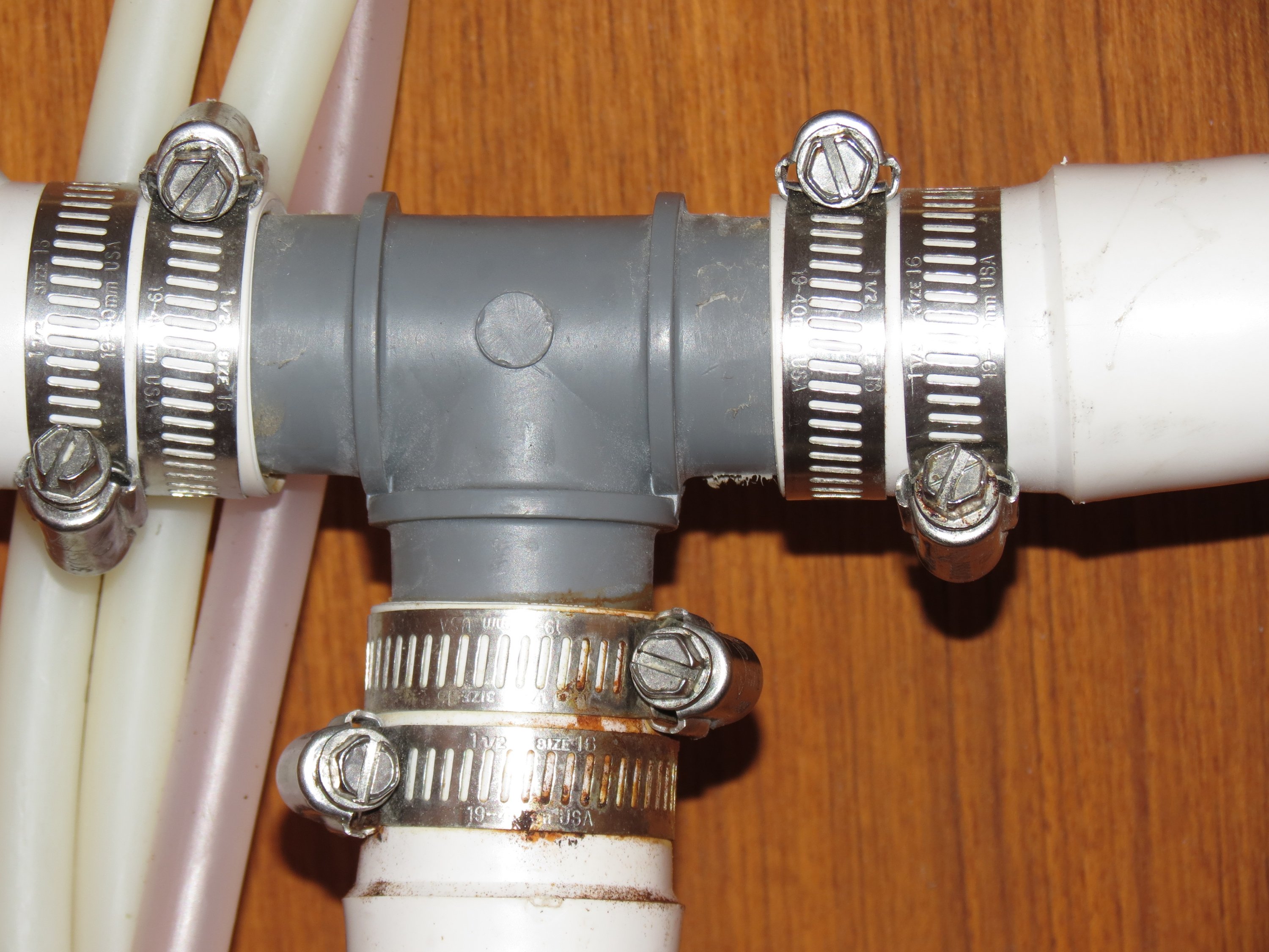

While I was at it, I also replaced the hoses on each of the head sinks with 1" wet exhaust hose, so I have eliminated all of the OEM vinyl corrugated hose below the water line.
See pictures below for details- For the benefit of all the 40.5 owners, the first four pictures are of the galley sink and seacock. The next two are the aft head,and the last one is the forward head.
