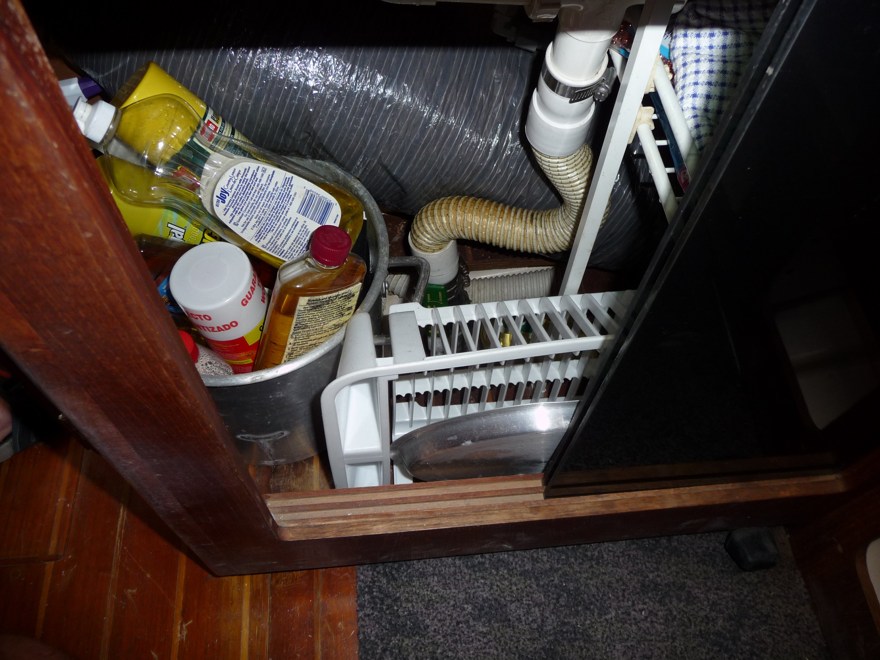

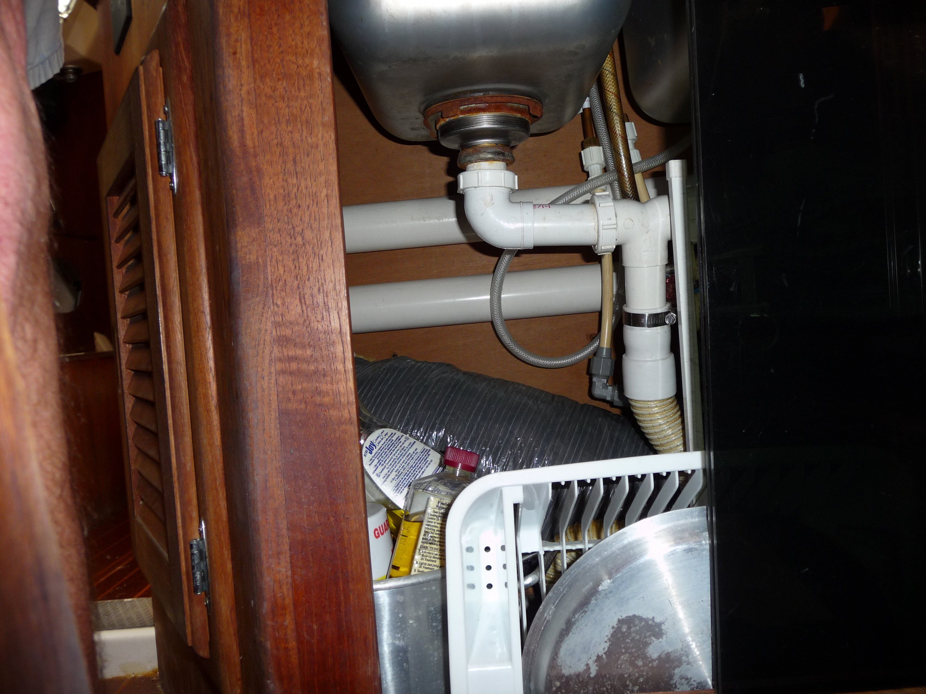

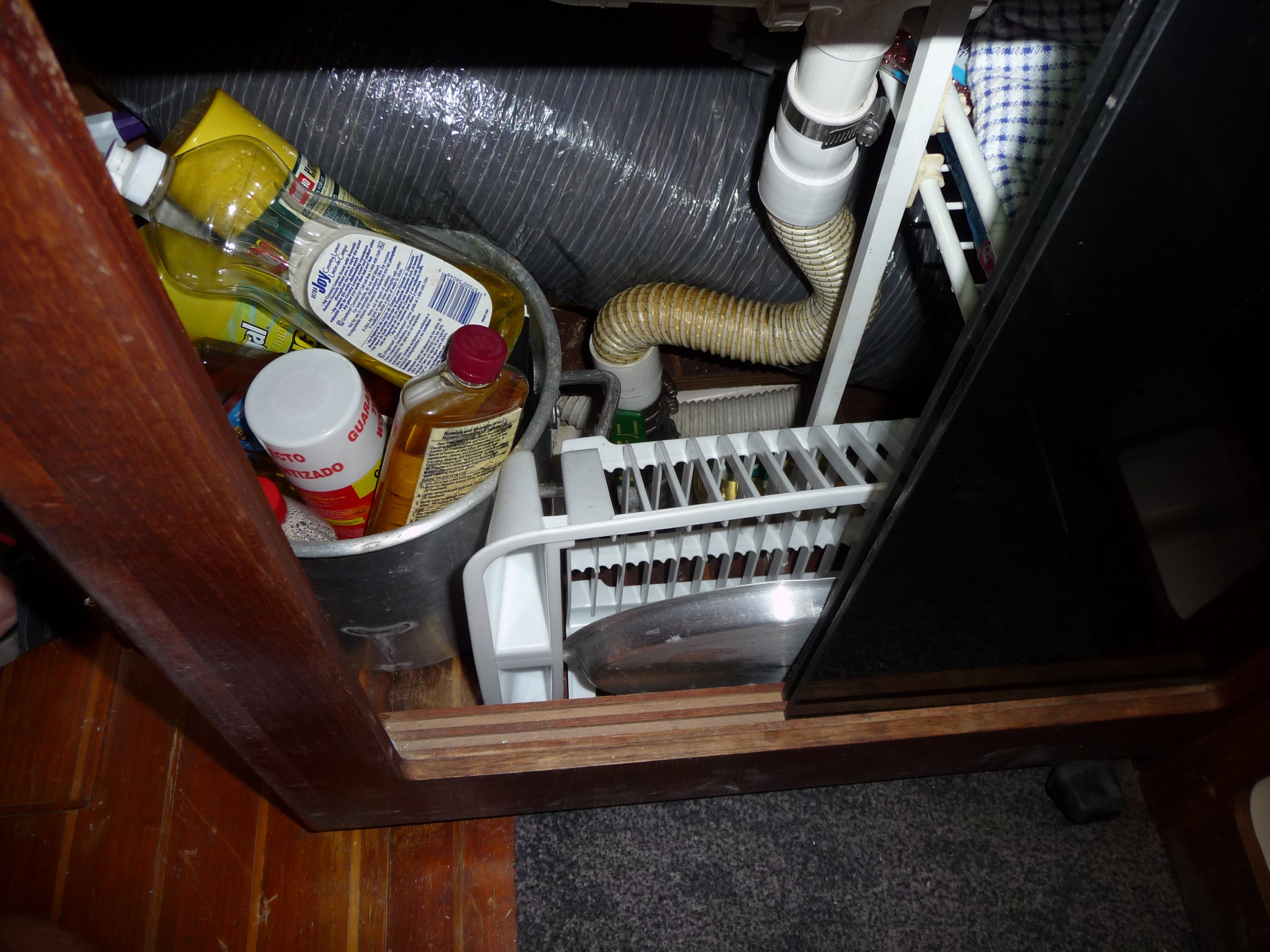

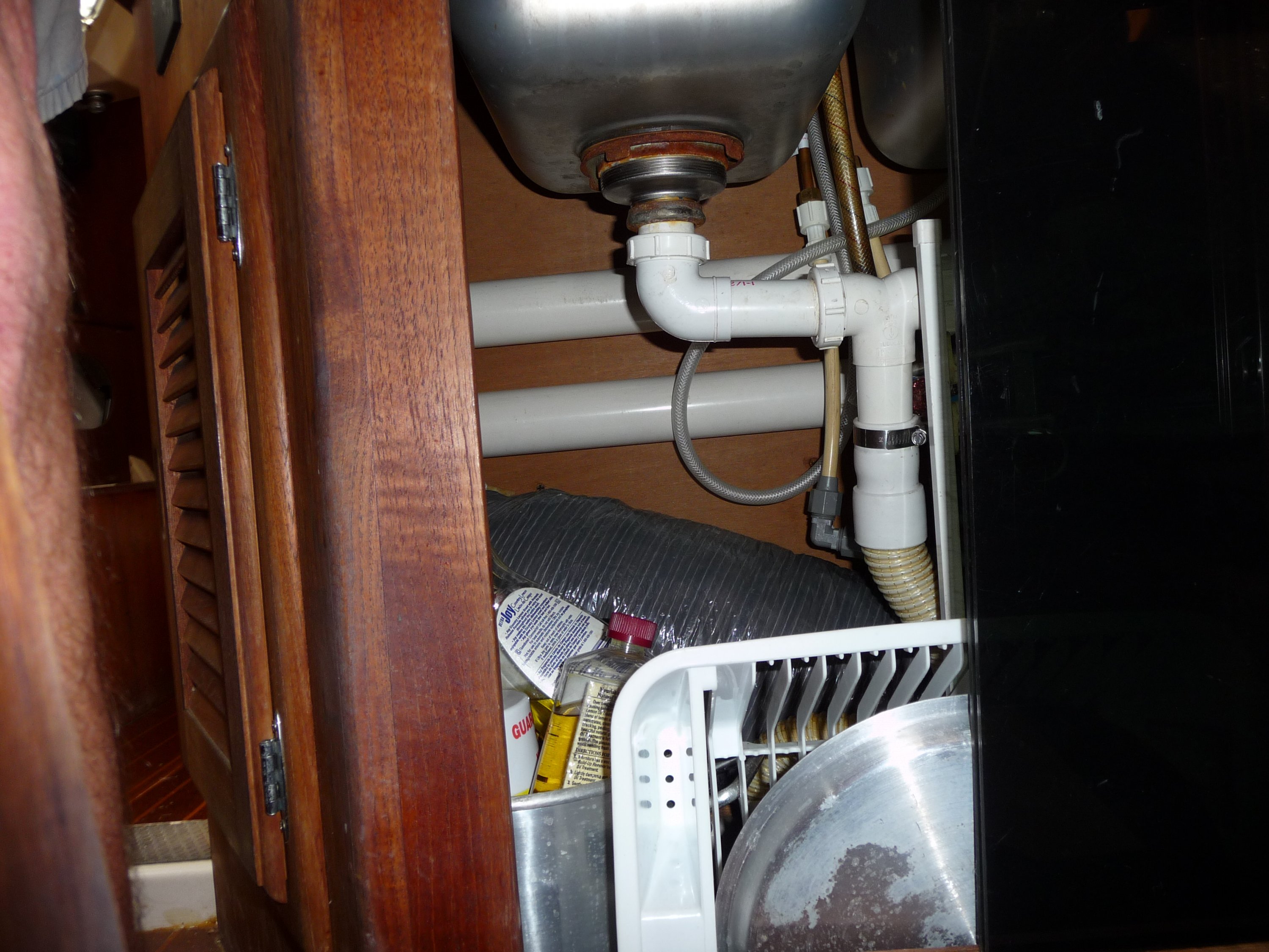

Was common practice, I think.. Attached is what it looks like on my '85 H-34.. The other thing that can do ya is the attachment ring under the sink, where the drain manifold attaches to the sink. These can rust clear and drop the whole manifold below water level, sinking the boat.. I secured my manifolds (sink and head basin) to the underside of cabinet so they can't fall below water level.
