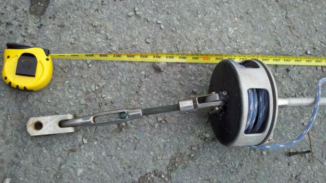

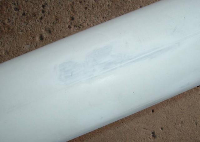

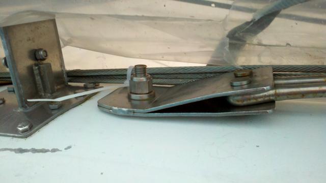

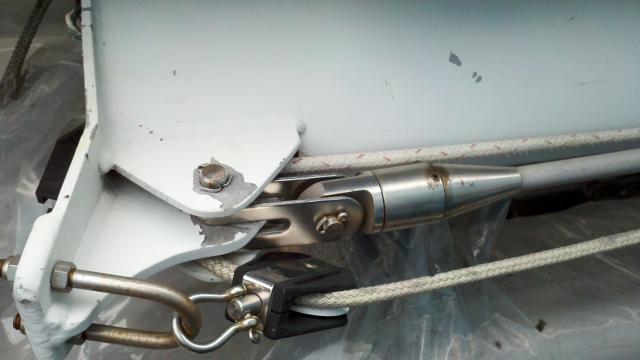

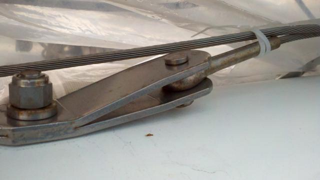

Yesterday I pulled some rigging off of my old Kenyon mast. I brought home the backstay and one each of upper and lower shrouds to get accurate measurements. I measured the furler while there since it is also my forestay(47' 9.5” pin to pin). While climbing around behind the mast rack I also took some pictures. I wrote an article for 'Owner's Mods' as a place to save the pictures and measurements for future reference. The stays are still in the trunk so the lengths are forthcoming.
This is only the second time the mast has been horizontal in the twelve years that I have owned Ladylove. I remain impressed by how beefy the mast and connectors(tangs) are. Since I don't know how old the wire is I will replace it all except for the running backstays and babystay. I had an expert tell me that the turnbuckles and U-connectors are fine. I will send the information out for some estimates but will probably end up at Seco South. But now I have the data for ordering my new Harken furler from Phil and Company.
Note: that forestay length of 47' 9.5" does not include the 'U' connectors seen in the mast top and furler photos. It is pin to pin. The second photo is the upper shroud, the third photo is lower shrouds.

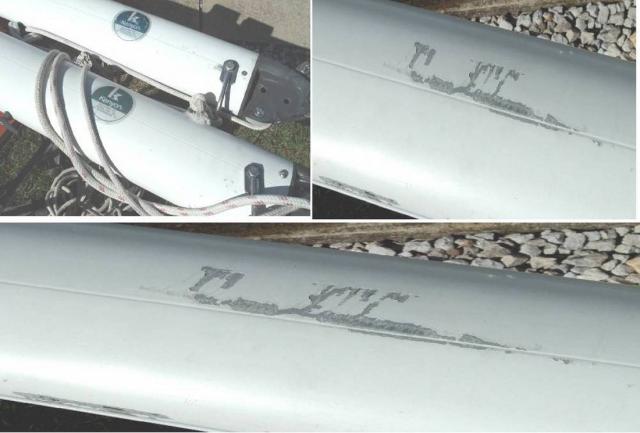

While this mast is horizontal I will naturally be checking the lights. I ran all new internal wire in 2001 and added the wind transducers. So besides the new standing rigging is the issue of "ugliness". I don't have time to paint the mast but would like to touch up the bare spots. Any suggestions on what to use to get a decent match?

nice pix Ed. I washed and primed my mast both sides 2 coats in a couple of hours. Finished with 1 part Interlux urethene (brightside?) on a 3 inch roller. By the time I reached the end of the mast, it was tacky. Went back to the other end, diid that side again. Total about 3 hours. next trip, Ii rolled the mast over, put 2 coats of urethene n the other side in about 20 minutes. Not perfect by any means but it shines like crazy from 20 feet away.

I too have to do my mast the next time it's horizontal. I have done the booms. Used Interlux Brightsides Hatteras White. Pretty close.

Looking forward to pictures of the hull/deck joint Jim. That must be a lot of work getting the stanchions and toerail off. Pulpit and pushpit too, right? I'll try the Hatteras but I think it is called Hatteras Off-white. I'll just sand, prime, and use a touch up brush. I would like to paint the whole mast but time does not permit.

Here are the numbers that I sent to Seco South for an estimate. As you know the shrouds are 1/4" and the backstay is 9/32".
Four lower shrouds: 23' 3 1/2" or 267.5"
Two upper shrouds: 43' 9" or 525"
Backstay: 48' 2 1/4" or 578.25"
But I am unsure about the forestay. Those of you with a real forestay. Is it the same as the backstay with a stud end into a turnbuckle? My Hyde forestay is : 47' 9.5" or 573.5". But that is top to bottom, pin to pin. The part of the forestay below the drum is 10.25". So I am hoping Seco South can figure it out.

When you do the mast JC, do you strip it bare to start? What about the hardware, is all of that taken off? When I took the shrouds home I tried to remove the tangs for the upper and the lowers. The bolts came out but there is a stainless shoulder that goes into the mast. I could twist or turn them in the hole but not pull them out. So to get the shrouds off I had to pull the cotter pins and then the big pins.
