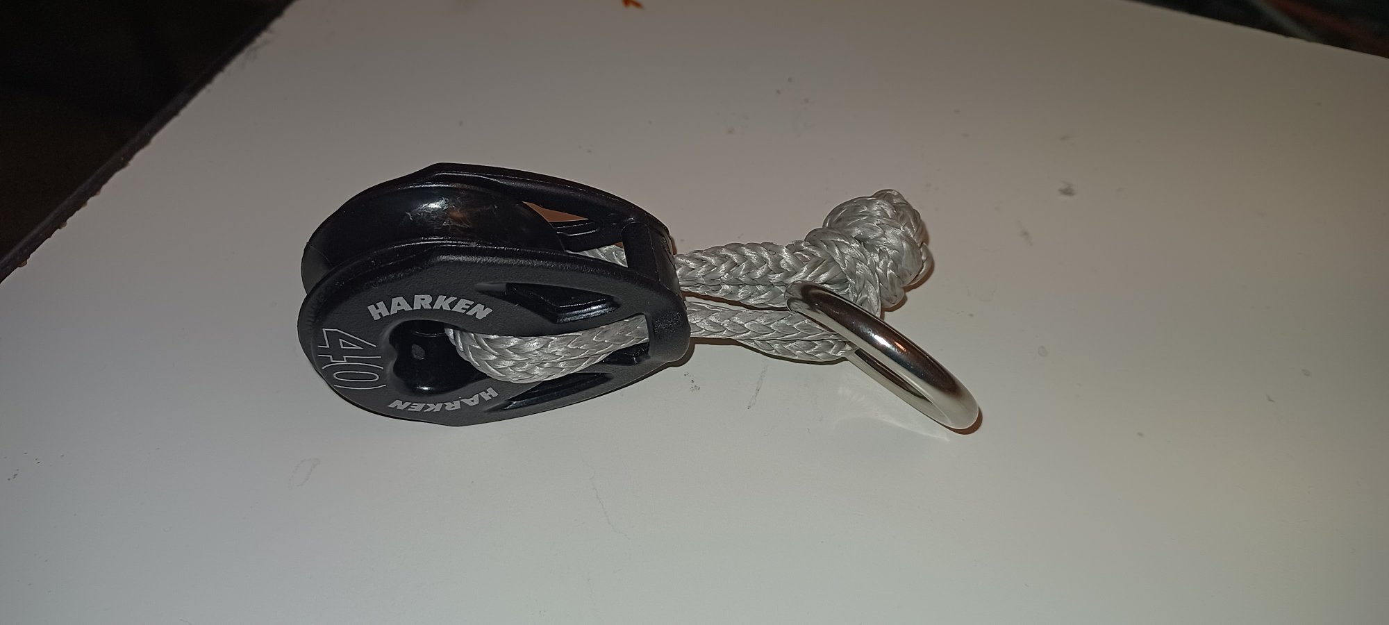

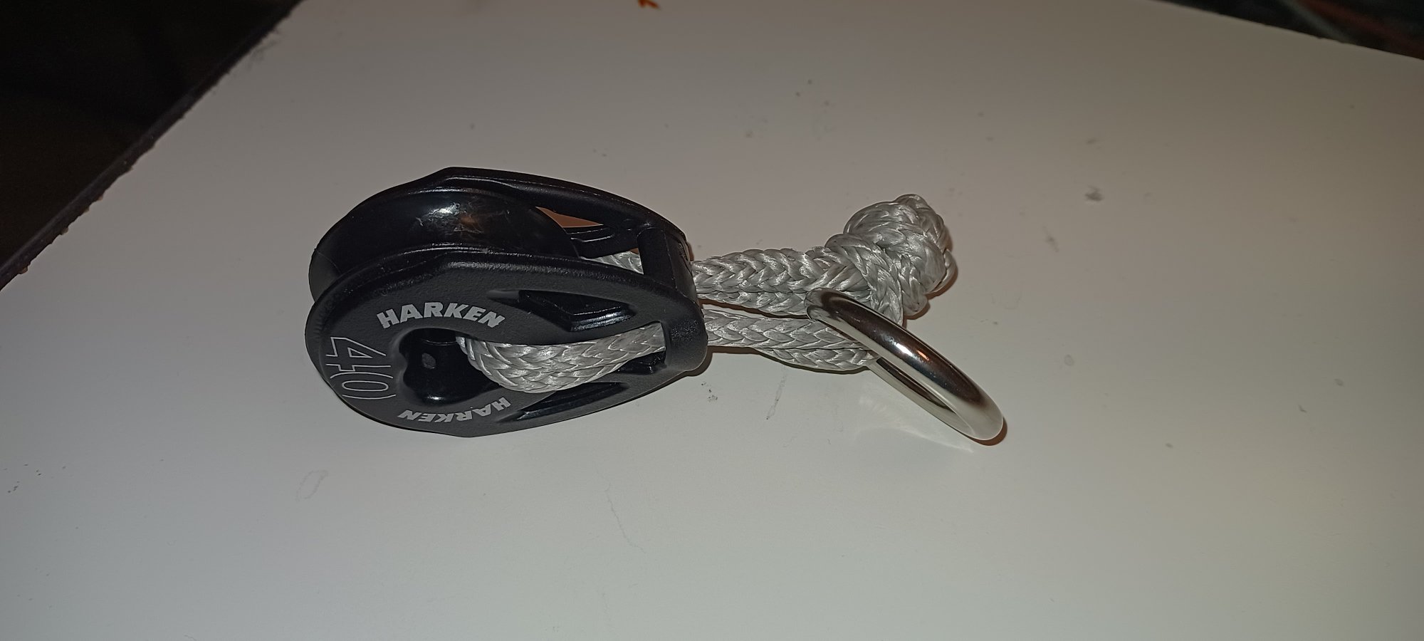

I use a Carbo bearing block with a soft shackle to a SS ring for by reef lines. The ring goes on one side of the main and the soft sackle goes through the cringle to the block. Makes a very low friction connection.

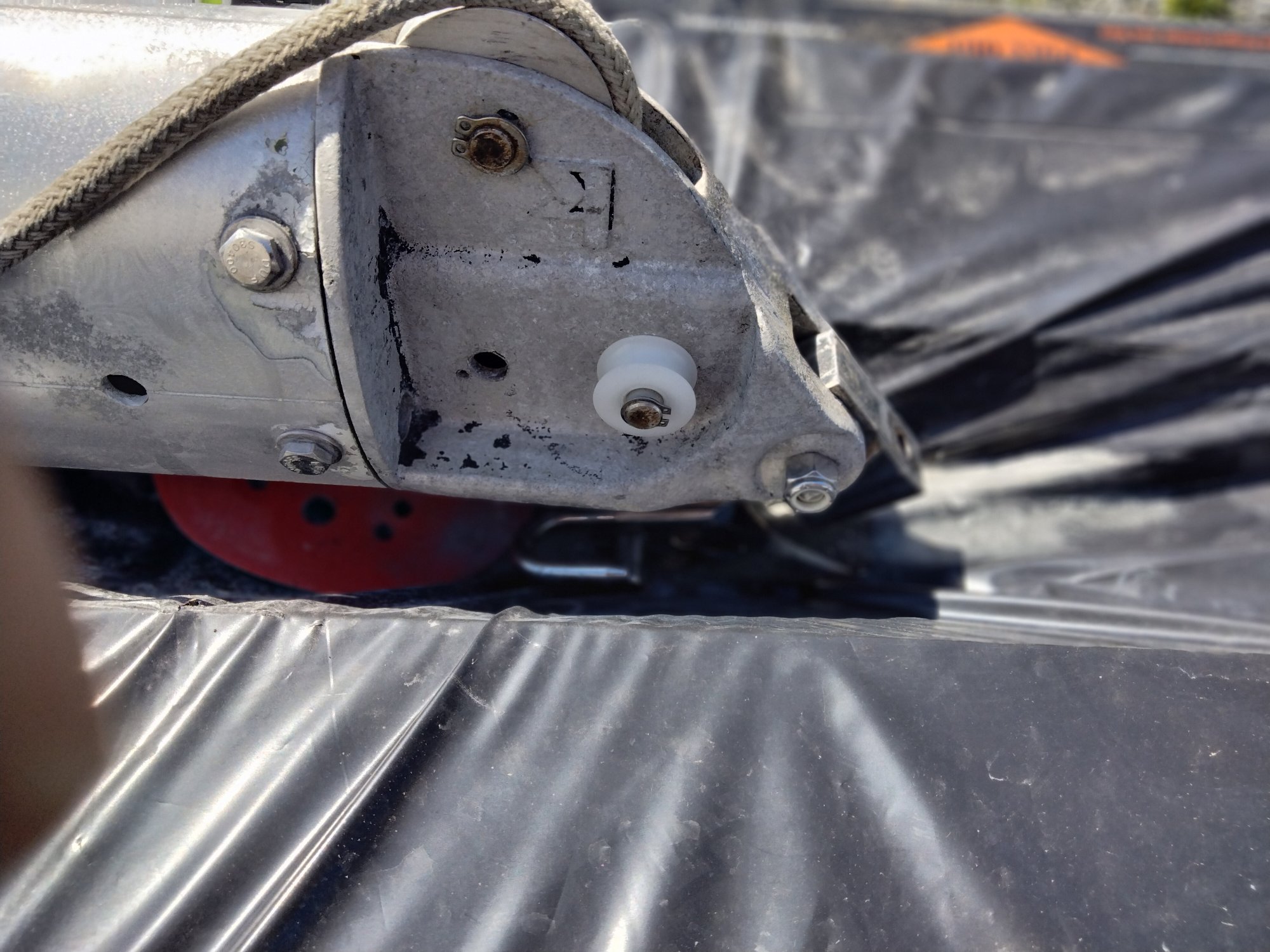

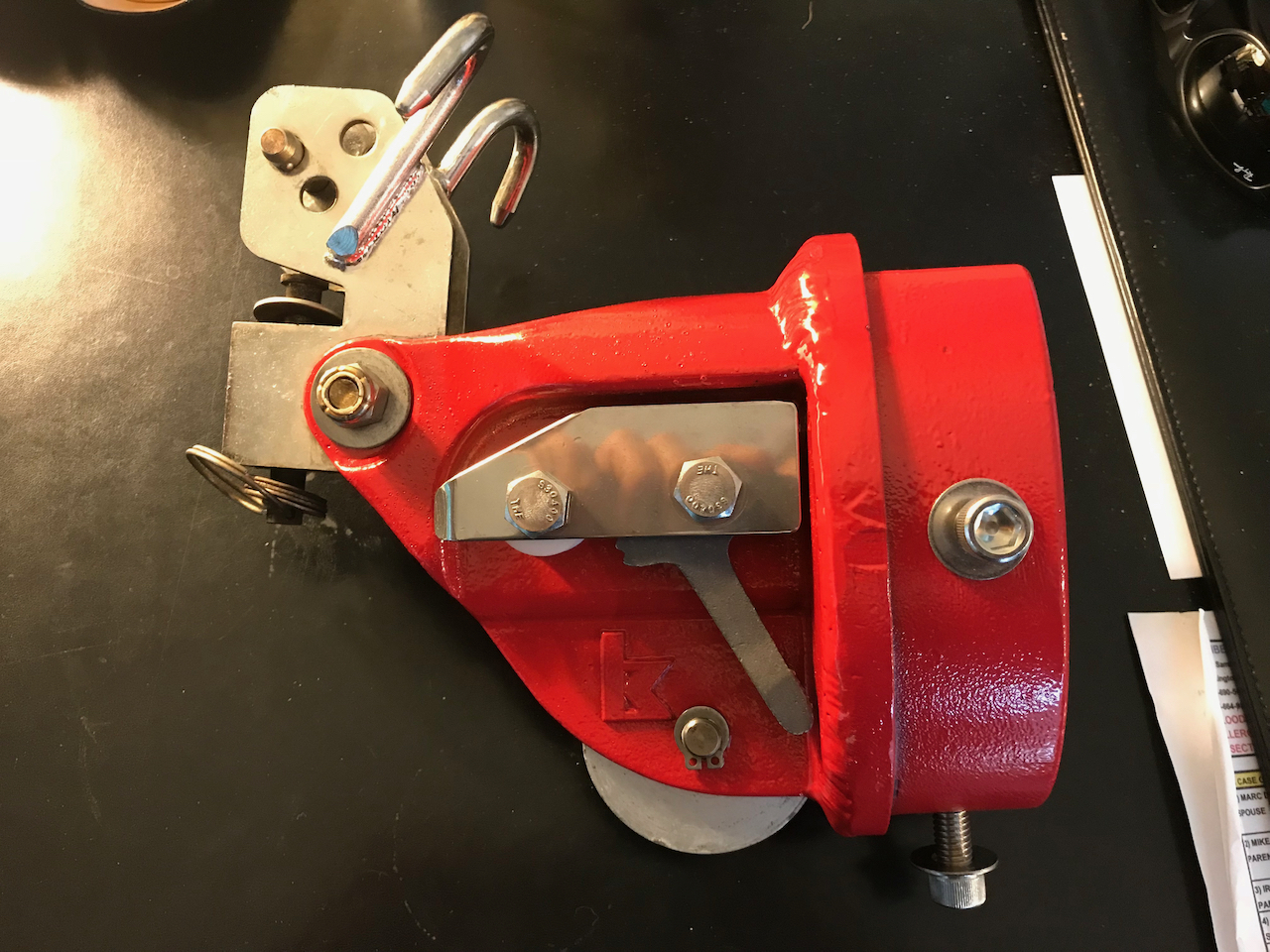

This is encouraging me to try and get the original system working my gooseneck looks like this. And is clearly missing some parts. @chichiflys is the ss part a rigrite part or custom fabricated
1,078
That hole through the gooseneck (to the left of the sheave) is for another pin that carries a jammer cam with a handle on each side of the boom - one for each reef. My gooseneck did not have the SS cheek plate - I suspect it is custom and its not strictly necessary. The parts are/were available from Rig Rite but not cheap! You could probably improvise with some parts from an old-style jammer like this:

I use a Carbo bearing block with a soft shackle to a SS ring for by reef lines. The ring goes on one side of the main and the soft sackle goes through the cringle to the block. Makes a very low friction connection. View attachment 214012
Cool - so if I'm following you that goes on the leach of the sail (in place of where i have my low friction rings)

I have them on both tack and clew cringles. I have a single line reefing system and friction made it impossible to get the line in. I now lower the halyard to a marked point that holds the tack block about 6" above the turning block in the boom and that lets the forward end of the line run freely through the Carbo block. The same thing happens at the clew.
My new main has rings for reefing so I just use the soft shackle to attach the block to the sail.

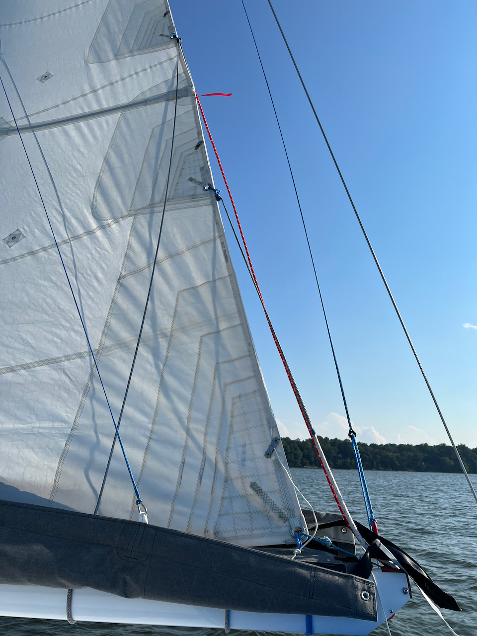

A mod that I made many years ago to my 1980 Cherubini H36. Been pretty satisfied with it: Here is the cut-and-paste of a post I made in 2013:
" From memory, believe that the OEM reef line jam cleats at the goose neck are the same as my 1980-82 Cherubini Hunter 36.
Buying the boat in 2007, I never liked the stock reefing setup at the goose neck. So I modified as described and pictured below ... which had the benefit of doing away with the jam cleats. For me, setting the reef was ok, but the springs would pull the cleat into locking position even when the line was slack. The reefing line would not run back through the boom when shaking out the reef. And also the line would not stay over the ridiculously small OEM sheave. Once off the sheave, the line would not feed well into the small opening at the goose neck.
The attached pictures show the original design (included so you can compare if it is the same as yours) and the modification I made. The large fender washer prevents the lines from jumping off the small sheaves. From inside the boom, the lines run down to blocks at the base of the mast, then back up to securing cleats on the mast. Pulling up on the lines before cleating allows for pretty good body tensioning position to get the clew close to the boom.
Subsequently I've replaced the fender washers with anodized aluminum cheeks salvaged from a nautical flea market block I purchased. The cheeks are larger in diameter than the fender washers and work better. The setup performs great for me. Items needed are: A 3/8" SS bolt (or maybe it was 5/16" ?) of the right length and a couple of washers and nuts. An old block for the salvaged checks. Couple of blocks at the mast base. I already had several cleats mounted on the mast."
