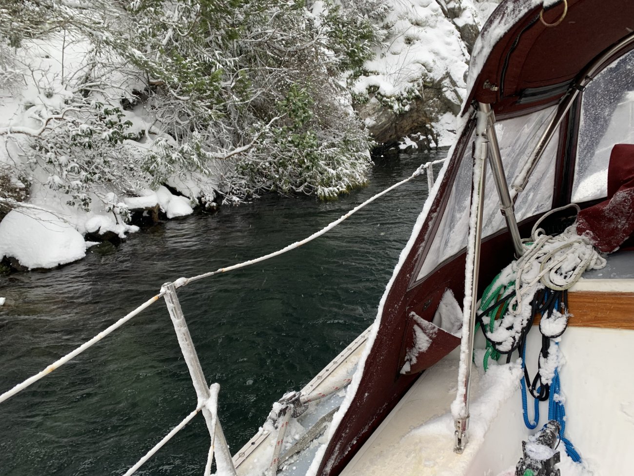

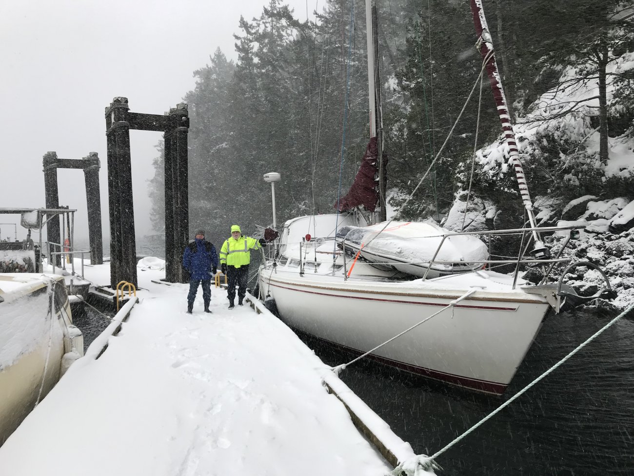

One important safety issue when using the generator is to have a Carbon Monoxide Alarm. The wind can shift and blow the exhaust to wards the cabin creating a gas poisoning hazard.
:plus: This is a true scenario. I got an opportunity to experience it first hand with my sailing mates @LeslieTroyer and @Ward H. It was blowing 25plus. Temps were below 20 degrees F. Snow was blowing up from the south east. We were sheltered in the lee of a 40foot high rock face just 6 feet from the boat. Secure to the dock on the other side. Went to bed about 22:30 and we were rudely awakened by a screaming alarm about 02:35.
first one then both CO alarms went off. Les climbs out into the wind blown snow to shut down the Honda. The wind had shifted and the exhaust found a path into the cabin.
During our Extreme Cruise this past winter.
