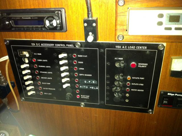

Here is a picture of my panel. The fuse is at the bottom and the light beside it is for the automatic bilge pump. The control for it is to the right of the panel.

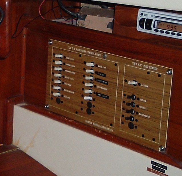

My pannel is like the one on the last pic. The fuse is for the bildge pump and mine does work, the light comes on when the pump runs on auto, and the light near the manual switch comes on when the pump is turned on manuall.

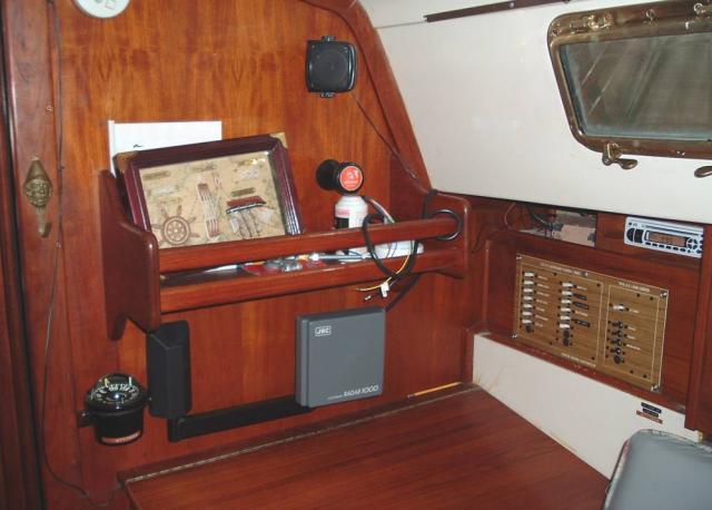

But where is your panel mounted Don? That's does not look like the area on port just above the end of the nav table.
I Think a great addition to any boat is a digital counter for the bildge pump. You leave the boat you set it to zero. when you return you can see how many times the pump has been runnig while you were gone. It is also great on long trips expecially when motoring because you cant hear the pump run whith the engine runningl.
I guess my next step is to open up the panel and see if the wire is connected to anything. My automatic pump wiring is over to the right more with a fused switch more like a breaker. My manual pump is another breaker that I turn on to use the pump.

Looking at the picture of your electrical panel, to the left of it, you have compass
It is not the flush mount type, and I have 2 of those
Great idea to have it monted on the wall, but how is it secured?
A strap around it, and then screwed on to the wood panel?
Quite curious, I think I asked same question once...

Got it !
Thanks Ed
I have a couple of compasses, but none of them have that bracket
But I like the idea: I have also 2 very nice, red and white Ritchie compasses, that are supposed to be installed in the cockpit, but I am reluctant to drill there, because you cannot sit there and rest your back
But have a very nice binacle compass, complete with a casing and a stainless steel cover that slides across to close it

It looks like a previous owner modification to me. Good Luck!
