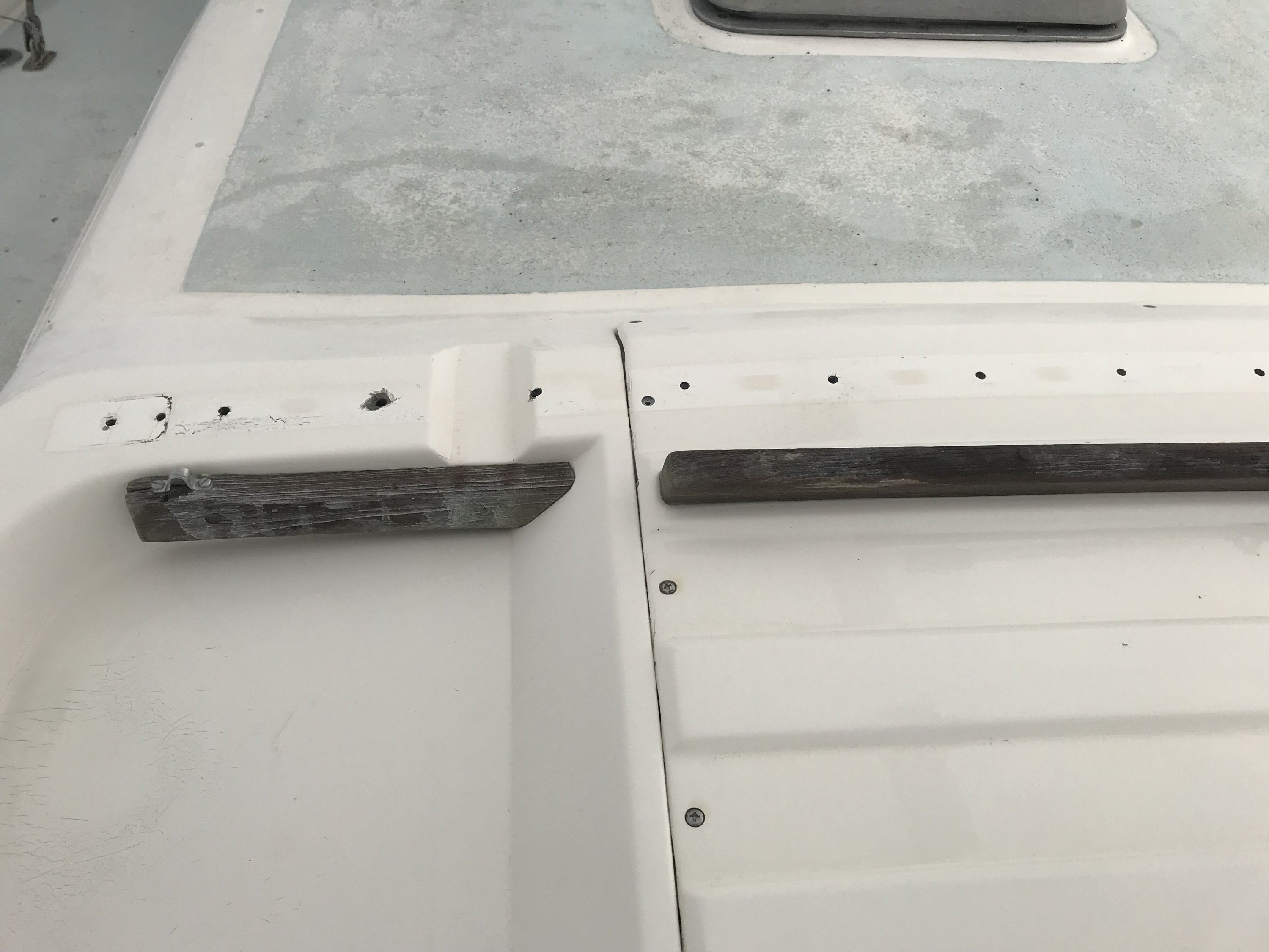

Thanks again. I'd be really interested to know the number of screws each side of the companionway if you have a chance to note that. For various reasons I have concluded that, for the most part, I will be drilling a tapping new attachments. I'd lie to minimize it so it'd be good to get feedback on this if I can before I go ahead and finalize the hole layout for my new track.

The Garhauer traveler for my C36 has 5 1/4-20 unc per side to attach the riser to the cabin top. And another 5 per side of a larger dia(IIRC) to attach the traveler to the riser.

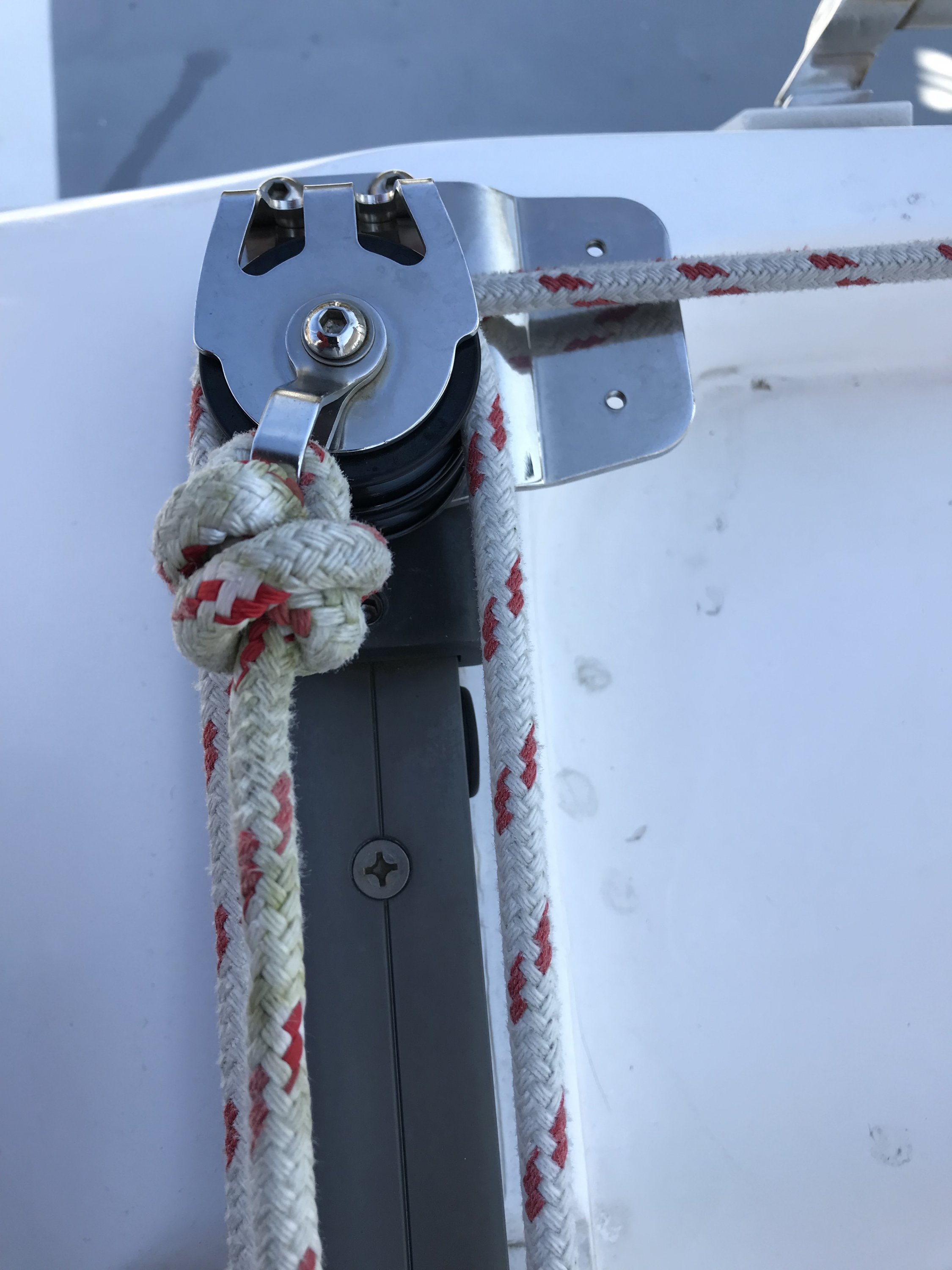

i love bowlines. use them all the time. using a bowline in this application is great. however, have you ever used a halyard knot or halyard hitch. same great strength, just a cleaner look. you just might like learning a new trick for the fun of it.
So I looked it up - I agree makes sense to use a halyard knot there - definitely cleaner...and might get a little more reach out of the traveler before it hits the knot. Thanks again.

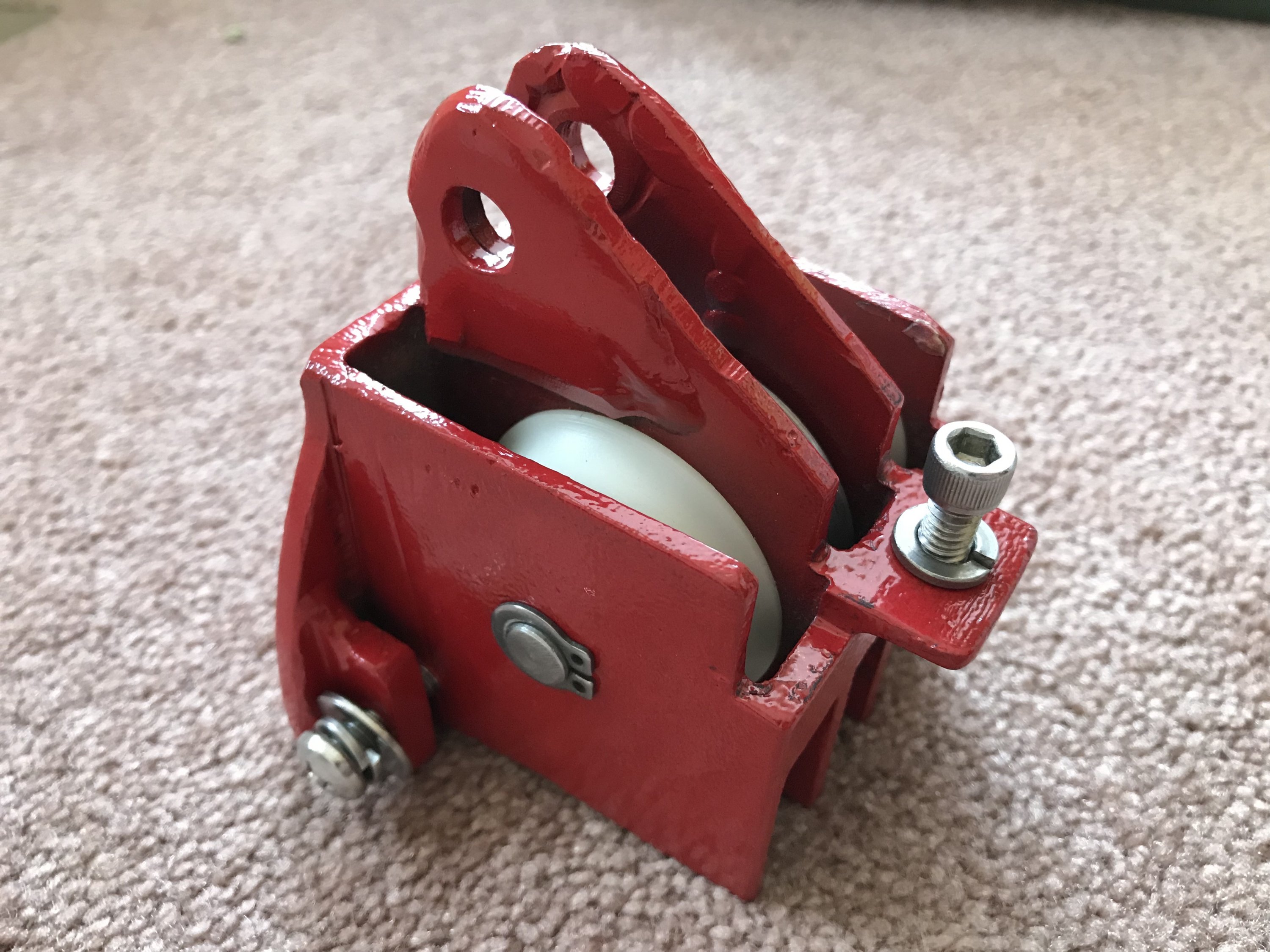

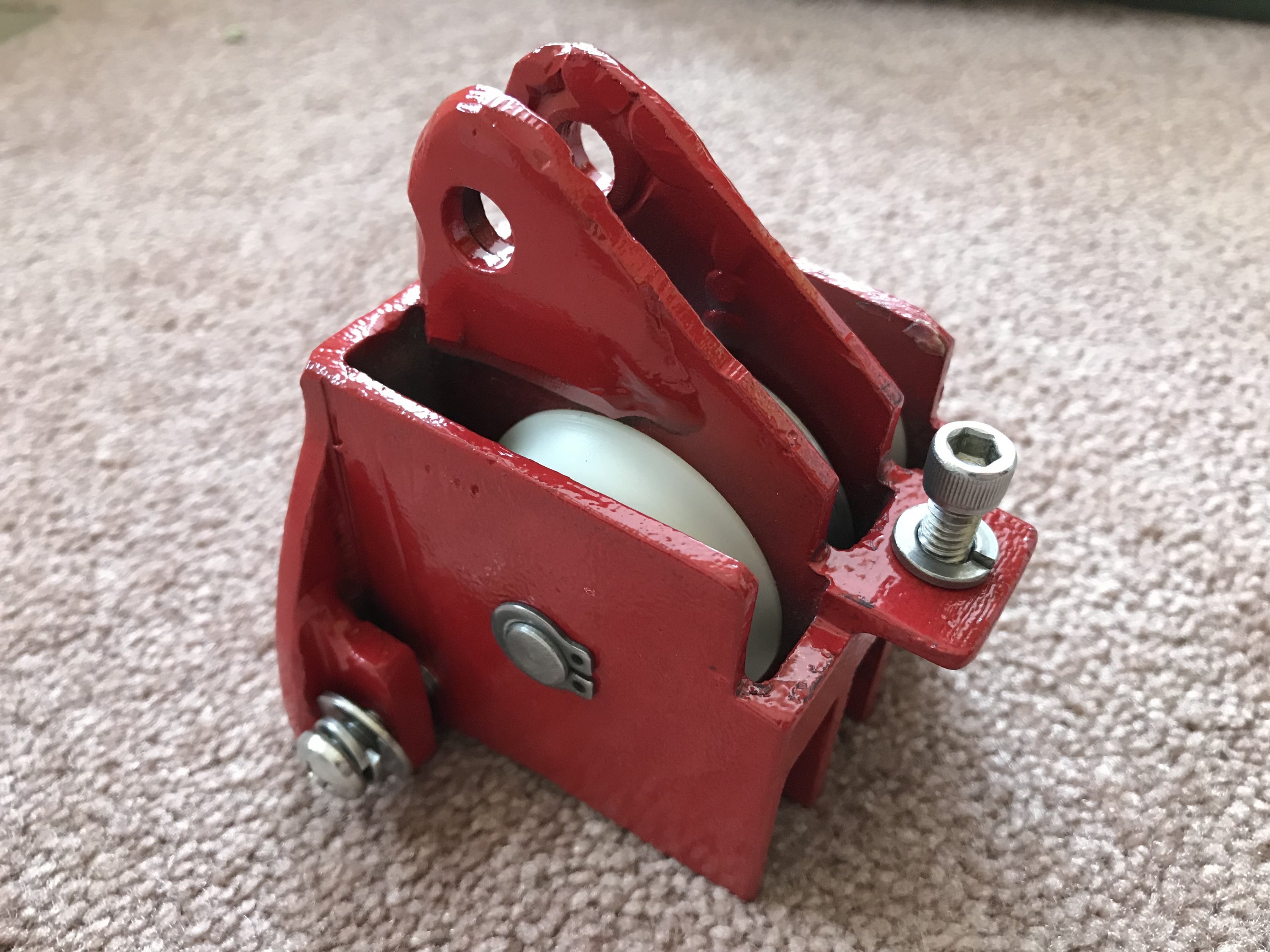

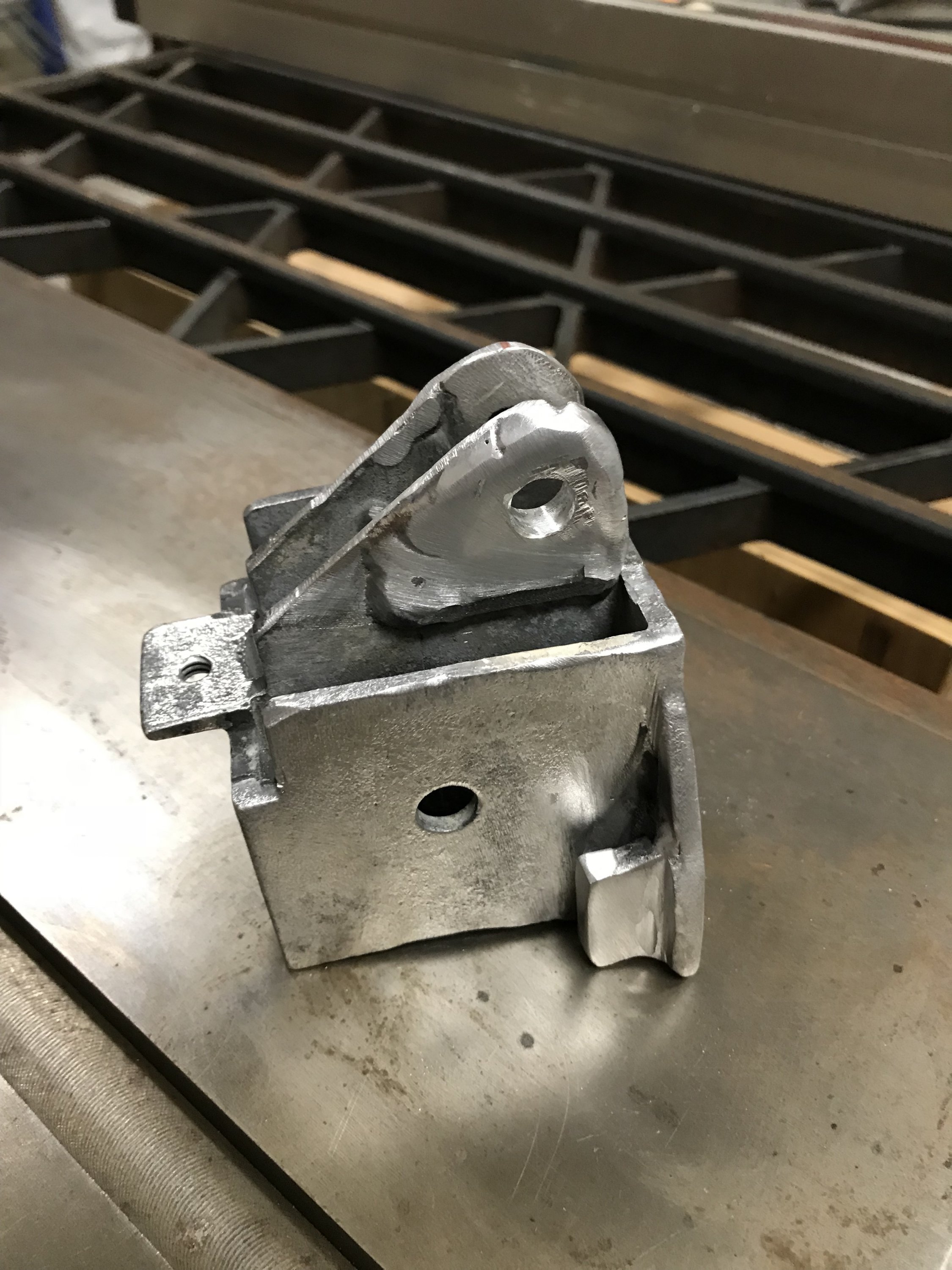

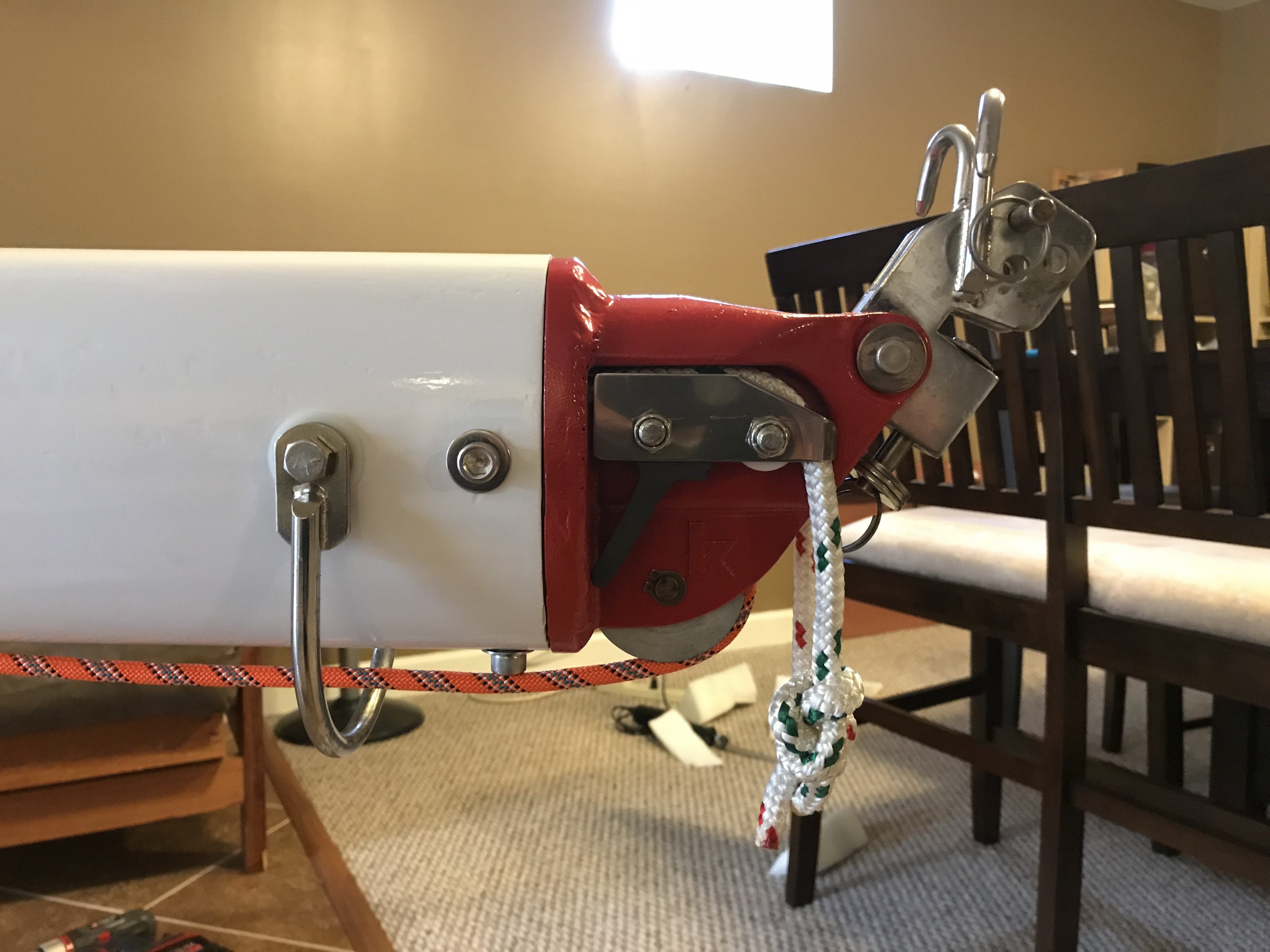

Quick update. Finally received my outhaul cap from the welding shop. Not exactly as I imagined, but it should suffice. I needed them to weld on new tabs to re-tap on the side for attachment to the boom end, and then I asked them to build-up the "ears" that protrude on top that the topping lift attaches to. The shackle on the topping lift had worn out some of the material and it was looking thin. Here it is before powder coating...gonna have to be red again to give me an extra 1/2 knot on the upwind leg!

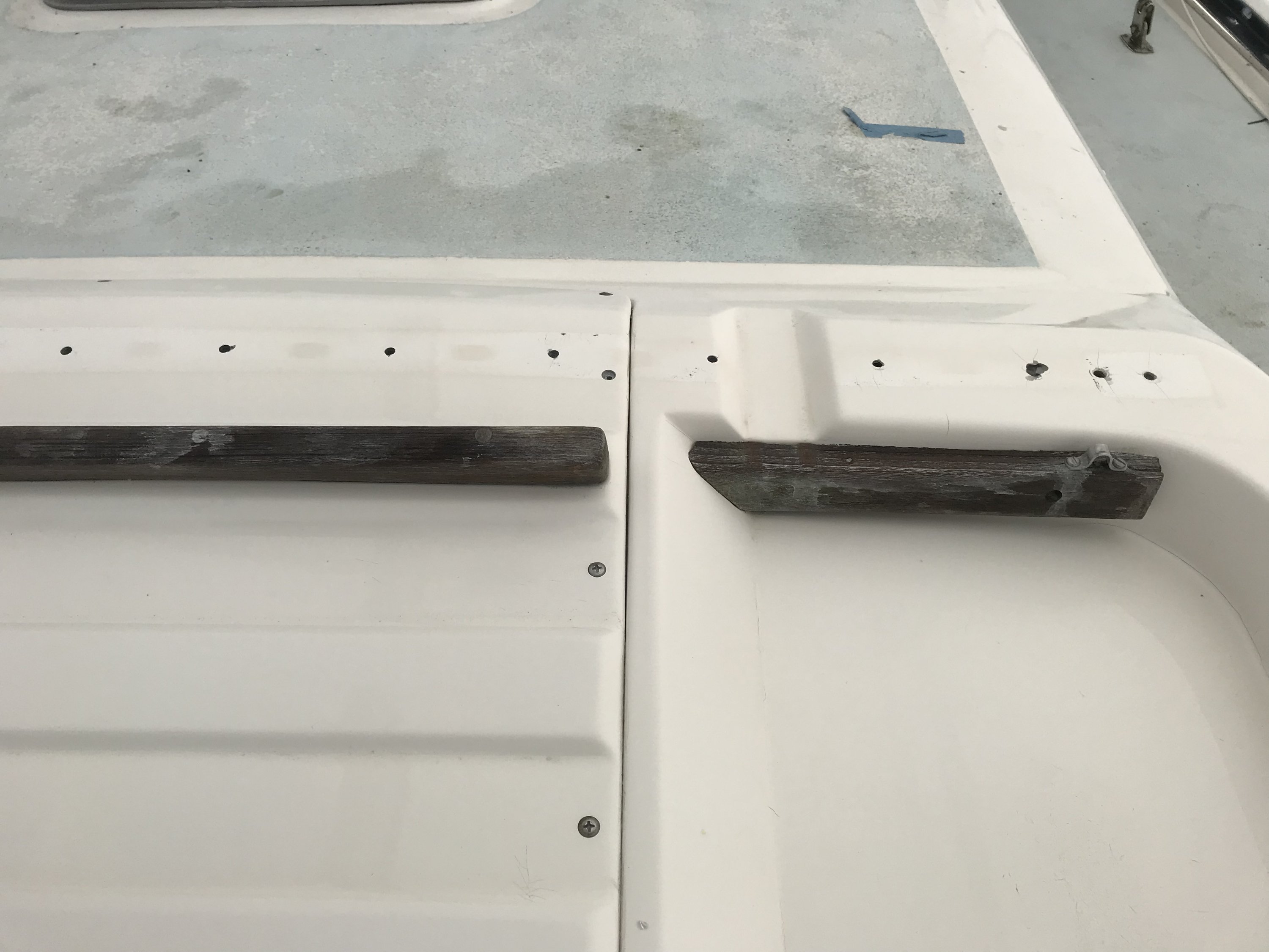

Yes there appear to be aluminum plates embedded in the fiberglass in the mount areas on each side of the companionway hatch cover just like at the mount areas for the cabin top winches.

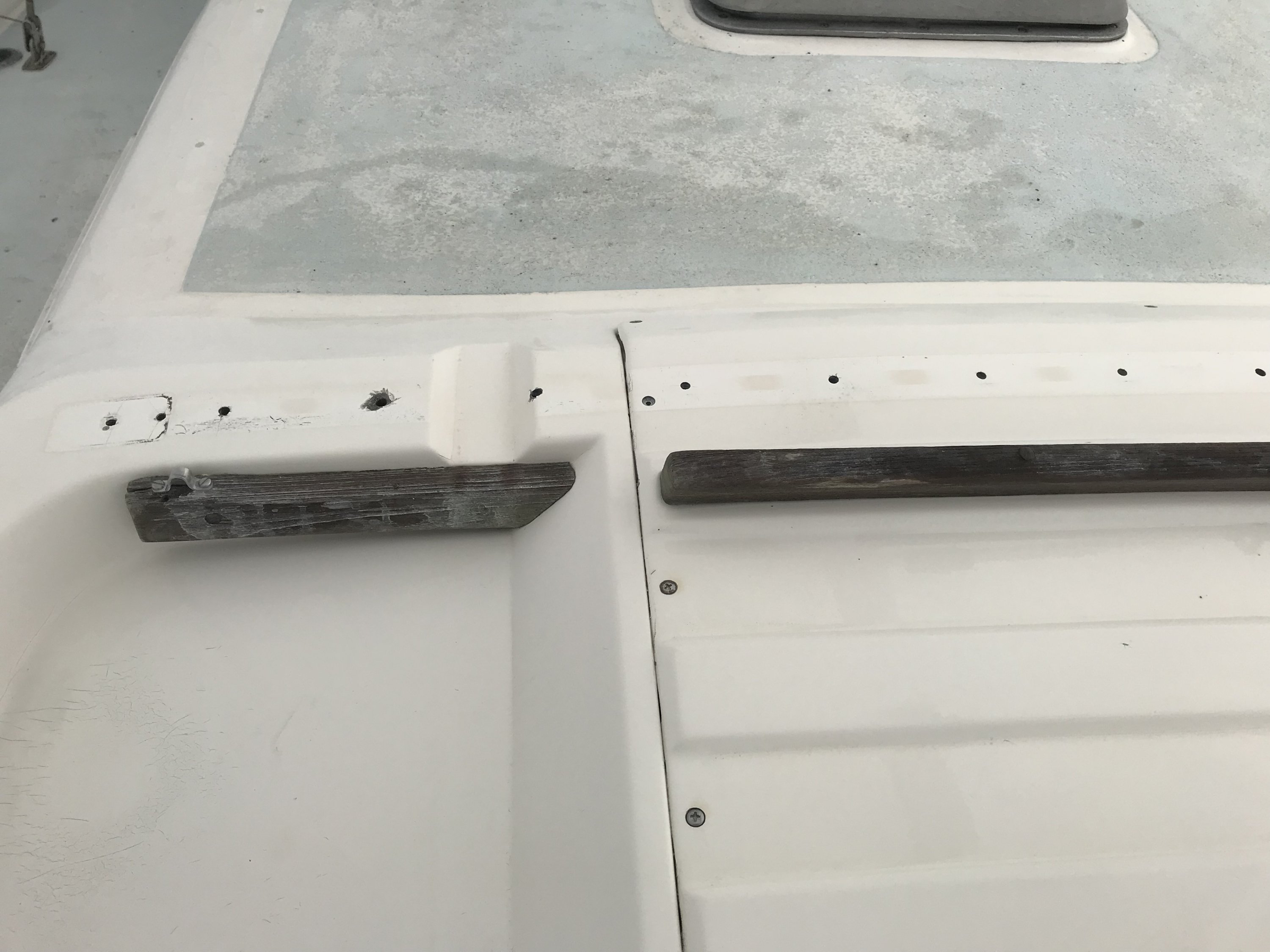

All screws are 1/4-20. My traveler had two at each of the end fittings with the sheeve. The track itself had three on each side of the companionway hatch cover and then a total of eight between the track and the hatch cover that in my option have no strucutral worth since they only attach to the cover which in turn is attached to the cabin top by a minimal number of small screws.
In addition I had one screw each side of the companionway the thread of which was almost totally non-functional and the ones each side immediately adjacent to the channel where the halyards pass under the track did not appear great either I think because the hole was made at the top of the sloped surface of the channel and probably close to it at the edge of the embedded aluminum plate. So there was not much holding mine down either - plus the camber of the track was about a third of what was required and they just screwed it down as much as they could further stressing the attachments.
This is what it looks like now:

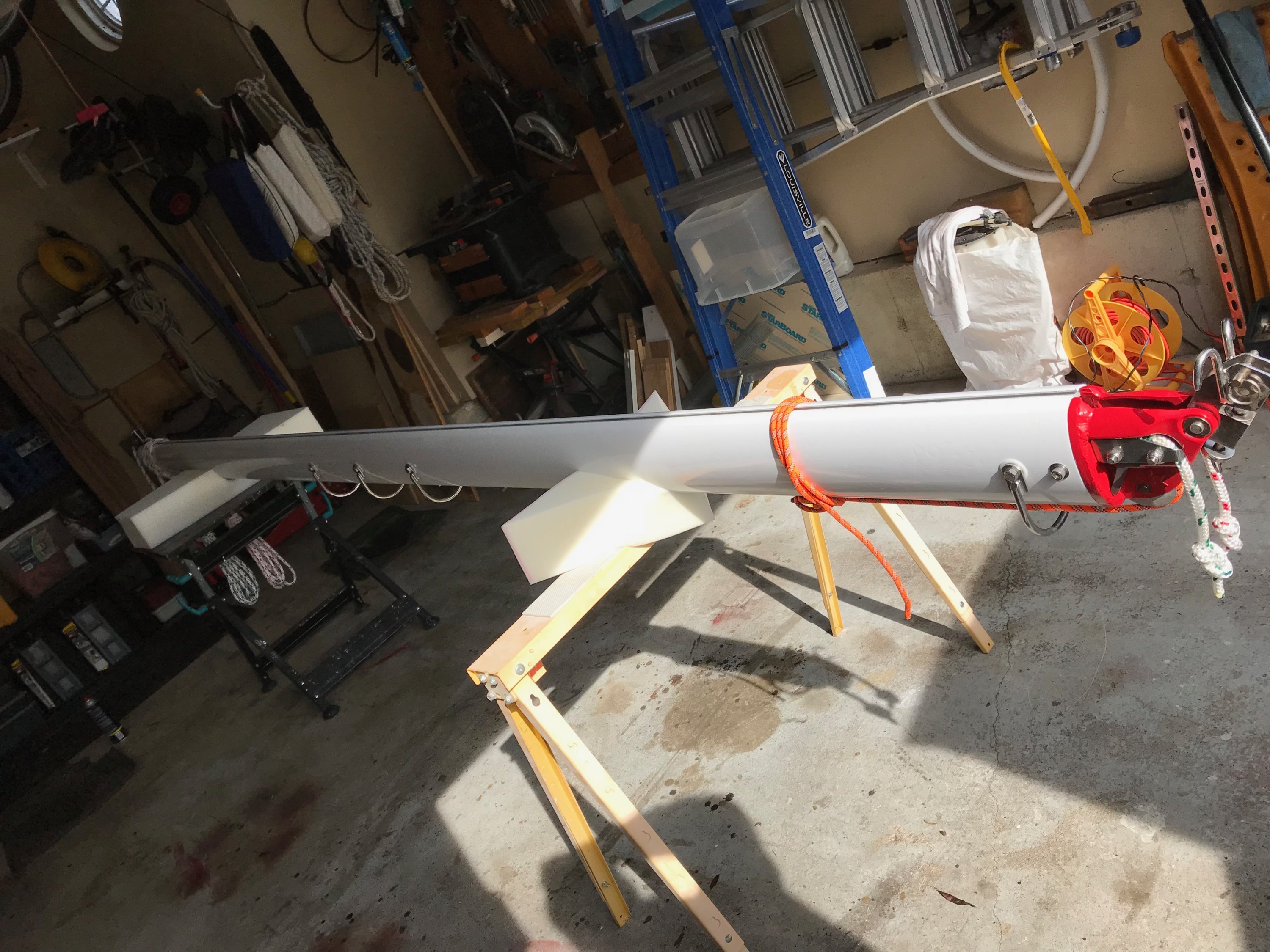

Finally got the outhaul cap coated and ready for install. Once I get some warmer weather I'll finish painting this boom and put it back on the boat. It's pretty much sailing weather here on the Bay.

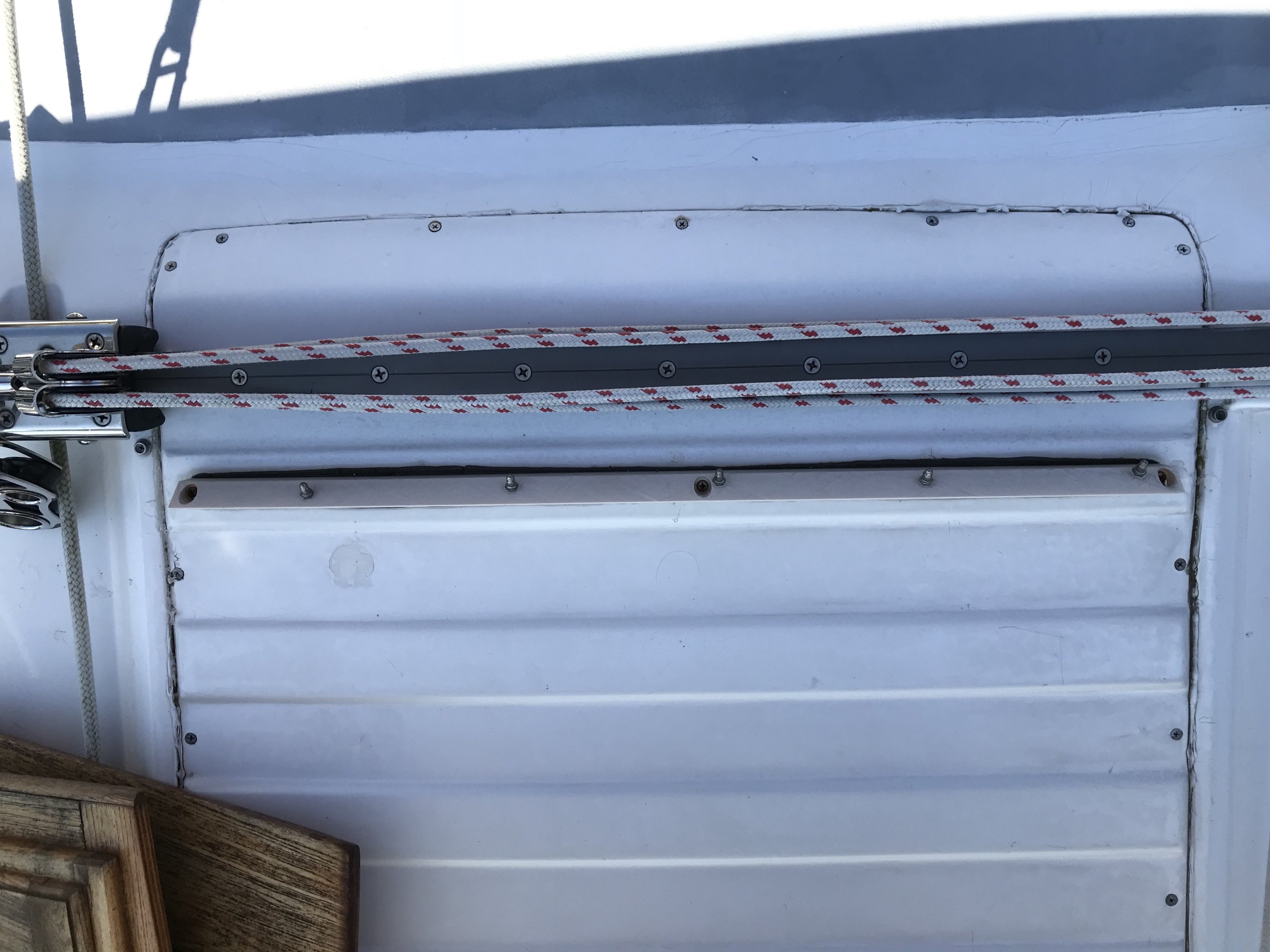

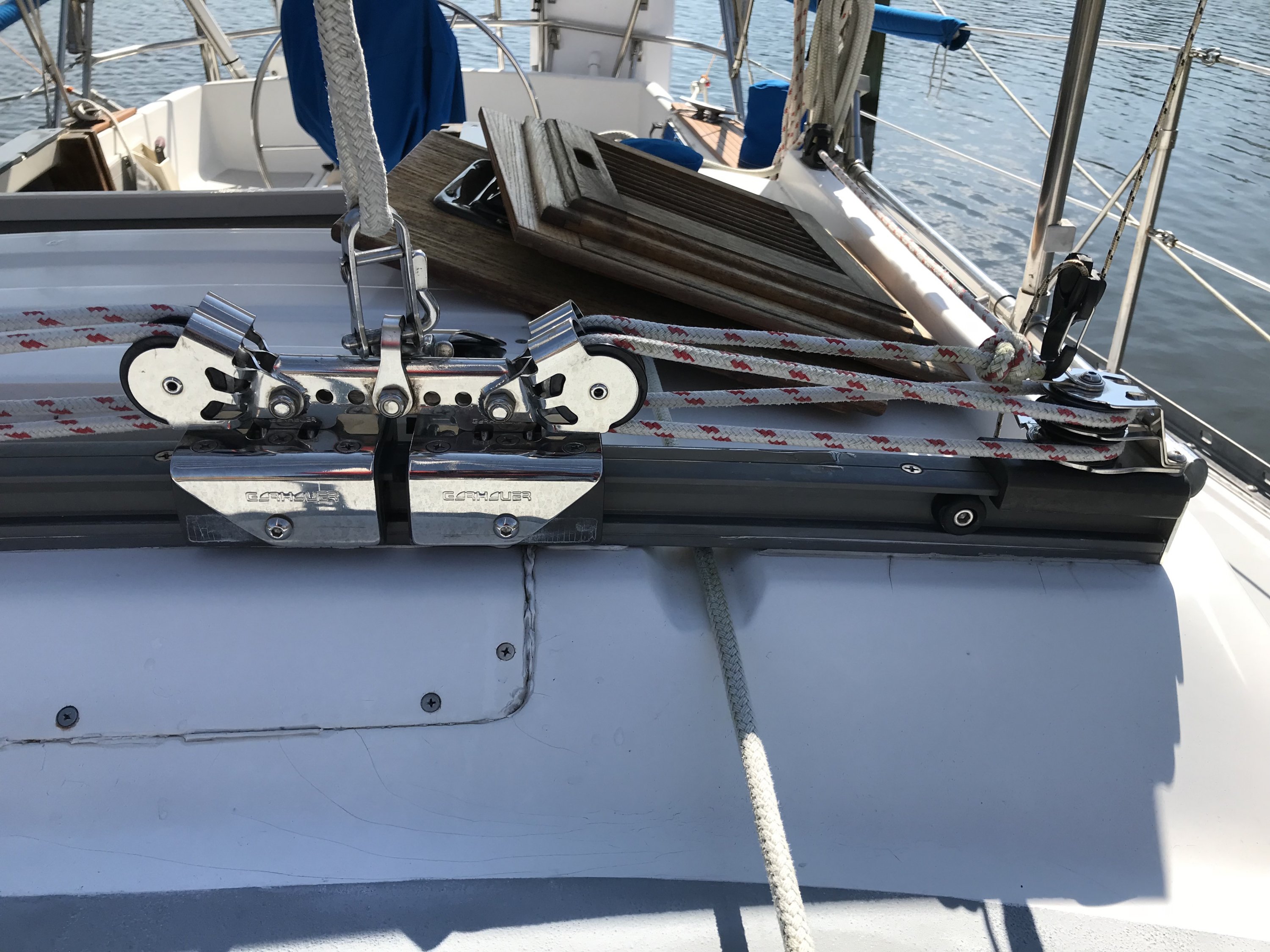

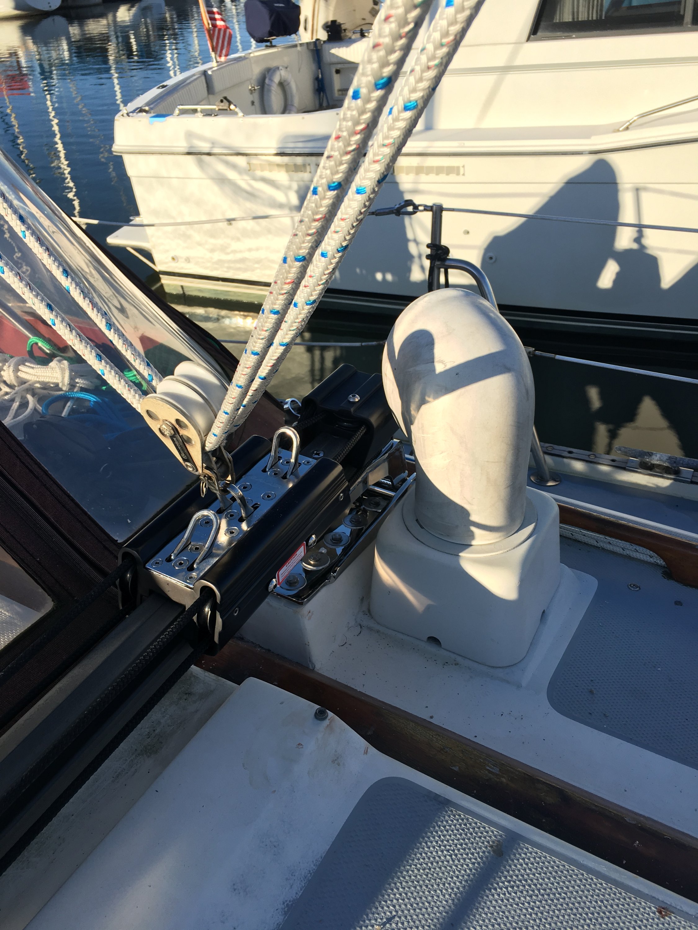

Ready for install finally. Was able to take a few pictures of the Garhauer track as installed on the boat. if I recall correctly there are 1-2 bolts underneath the end caps of the traveller. I have Spinlocks installed near the companionway to control the traveller sheets. I have 5/16" line for the traveller. (8mm).
