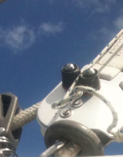

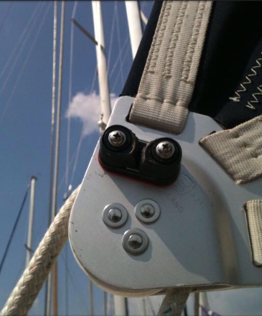

I have the perfect solution
What you really want to do with a leech line is snug it up once the sail is out, and always release it before you furl
Unfortunately, is impossible to do this in most situations because the either the boom is too high, or you can’t reach the small cleat that was installed in the sail.
Here is a great way to do this
Install a small dinghy cam cleat on the aluminum piece of the outhaul pulley. To do this you will need to drill & tap 6-32 screw holes, and cut the screws to the exact length so that they don’t interfere with the pulley
Now, you pre-set the line into the cleat before you unfurl. Set a large knot or loop in the end of the leech line.
Make yourself a “specialty tool”, i.e. a coat hanger with a hook bent into one end.
Then, once the sail is unfurled ...
You reach up with the “tool”, grab the end and pull, pulling the line tighter into the cleat.
Just before furling, reach up, and snap the line out of the cleat
This works amazingly well

Oct 7, 2016
68
Hunter 356 Little Creek, Norfolk VA
Are these photos from an actual real world instance of this solution?
