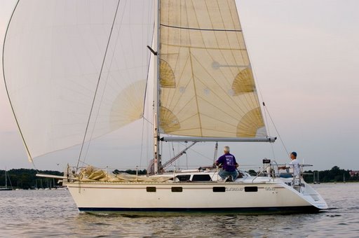

David, looked at your asymm flying on the big picture: http://hunter.sailboatowners.com/in...&Itemid=278&pid=13296&page=sshow&mn=&catid=61 . It looks like your tack pendant is either on the pulpit or over it. That's not too much strain? Love that bow wake, rockin'!

I wrap the tack around the forward, upwind side of the pulpit, and take it to the toerail. Forward on the toerail lets the spin lift downwind, back tightens the luff for coming closer to the wind. At 90 degrees or more off the wind, the tack is pulling forward, pretty much in line with the run from the pulpit to the toerail. Since the tackline doesn't deflect much, there is not much stress on the pulpit. Running the tack line there moves the tack a foot ahead of the forestay, and a foot to windward. We've had no evidence of displacement of the pulpit over 8 years of use, including a very exciting round-up when a front came in unexpectedly at the north end of Lake Huron last summer. You have to go forward to adjust the luff, but in cruising mode, that is just fun stuff to do while on our way to the next port!
I think 30 to 40 degrees off the wind is what most others estimate as the point where the wind will freely enter the luff of the chute. Once the flow is started, the sail lifts up and forward, and sustaining the flow ought to work fine on his boat.
Yes, we gybe with one sheet. When cruising we seldom gybe (maybe once or twice a day). To gybe, we drop the sock, coil the sheet at the foot of the sock, carry the sock and the sheet around the front of the forestay, rig the sheet on the other side, then hoist the sock. A racing rig would have two sheets, both nearly twice the length of the boat. Then you release the sheet, let the sail flow out in front of the boat, then haul in on the other sheet. (Our single sheet only needs to be a little longer than one boatlength.)
Yeah, that bow wave says hull speed!

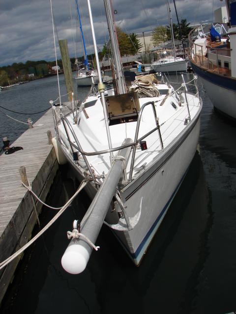

A bow sprit??.. without question it's worth it. Not only does it allow for a larger spinnaker it also allows for deeper sailing angles. I designed and built mine and I'm very glad I did.

Stretch, my sprit extends the tack of the sail an extra 5 1/2'. It allows me to sail 20 degrees deeper than without. The tack is adjustable from zero to 6 feet. The deeper you sail the more you need to raise the tack. This also allows the luff of the sail to roll out to windward and keep the sail drawing. However, the deeper you sail the closer you must keep an eye on the trim. If you loose the sail you will need to head up and re-load which will cost time and distance. The sprit does absolutely nothing for pointing because it is not used on a beat. I point higher than other 35.5's because I have a 6' fin keel and inboard genoa tracks. I can blow the doors off other Hunters.
