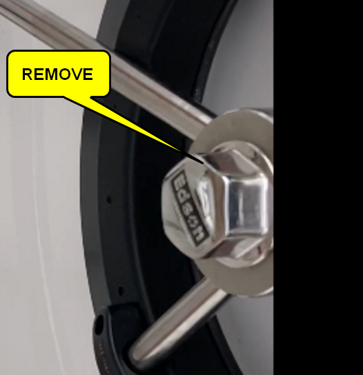

- remove the large nut in the centre of the wheel
- pull the steering wheel off the steering shaft
You should see a keyway on (I believe) a tapered shaft with a tightly fitting key in it. If so, that's not the problem :facepalm:.

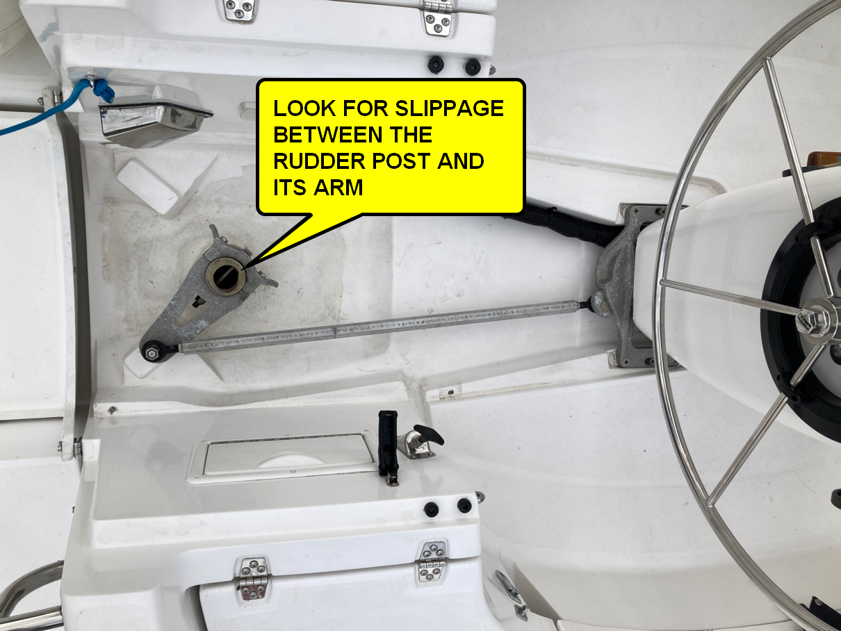

Also take a look for slippage between the rudder post and its arm :

I've already had the floor panel up to look at AP Ram options, and the Arm/Rudder post is rock solid.

When you remove that wheel nut you should see a 1” x 1/4” tapered key in the slot. They do slip out when removing the wheel itself so use caution. There should also be a type of spring clip attached to the shaft as well, which applies “some” pressure on the wheel.

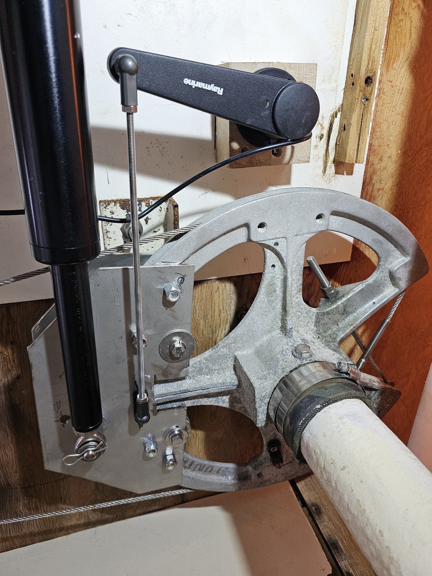

I have been deep into the bowels of my 1983 hunter 34 to install a new Raymarine Autopilot with their new linear push rod. While doing the installation I noticed that the wire on the pulley system had stretched some over the last 40 years. Also noticed that the turnbuckles that connect the wire/pully system to the rudder wheel were sort of crusted in place and difficult to turn and shorten the stretched wire.

I have been deep into the bowels of my 1983 hunter 34 to install a new Raymarine Autopilot with their new linear push rod. While doing the installation I noticed that the wire on the pulley system had stretched some over the last 40 years. Also noticed that the turnbuckles that connect the wire/pully system to the rudder wheel were sort of crusted in place and difficult to turn and shorten the stretched wire.View attachment 230777
And your next project is? ;)
