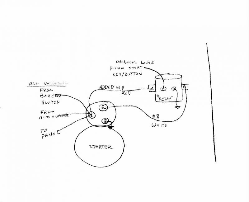

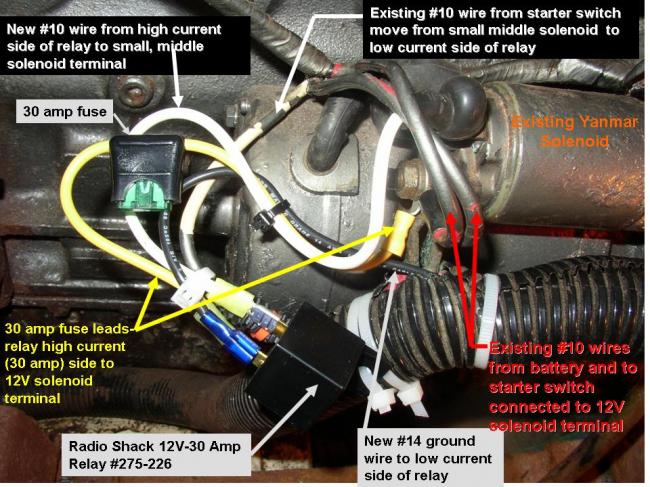

For your reference, here's pix of the starter relay solution with parts labeled...
Also, here's a wiring drawing for using a Ford type starter relay...
I tried the same relay as advised....could not get it to work....Good luck with that!

Re: Andre...
Hey Dan,
just bought the Radio Shack relay, it was out of its packaging and the last one in stock so I took it but I can't find any info about the connection. There is numbers on the unit, is it possible to let me know whitch numbers go where ?
Thanks in advance.
André

Salut André,
Have included the drawing I had received from Dan a few years ago and a cleaned up version of the dwg as well as a picture showing the installation. Dan I hope it's OK with you ! André, l'll send you a pm through this site with my phone number here in Cocoa, FL. You can contact me when you get near here and I'll be happy to help with any problems you might have, or provisioning if needed. Regards. Claude

Claude/Andre...
Claude: No problem in cleaning up that drawing--it wasn't mine but yours is much easier to understand now.
Andre: The relay numbering is pretty standard. I think this is what the terminals should be wired as (should be a pictograph screened on the relay housing - 85/86 are the relay coil):
30 = Fused with 30 amp fuse (equal to the RS relay's rating) to a heavy positive power lead - 10 AWG - (taken from the battery lead [big post] on the starter)
87 = Terminal on starter relay where starter button wire was connected
85 = Wire from the starter button
86 = Black wire to ground
The picture shows the fuse wired between the relay and the starter solenoid. I feel it shoud be on the incoming current lead side into the RS relay instead--how I've wired it on my boat. The RS relay wiring pictured is mostly white, but the black one is definately to ground.
