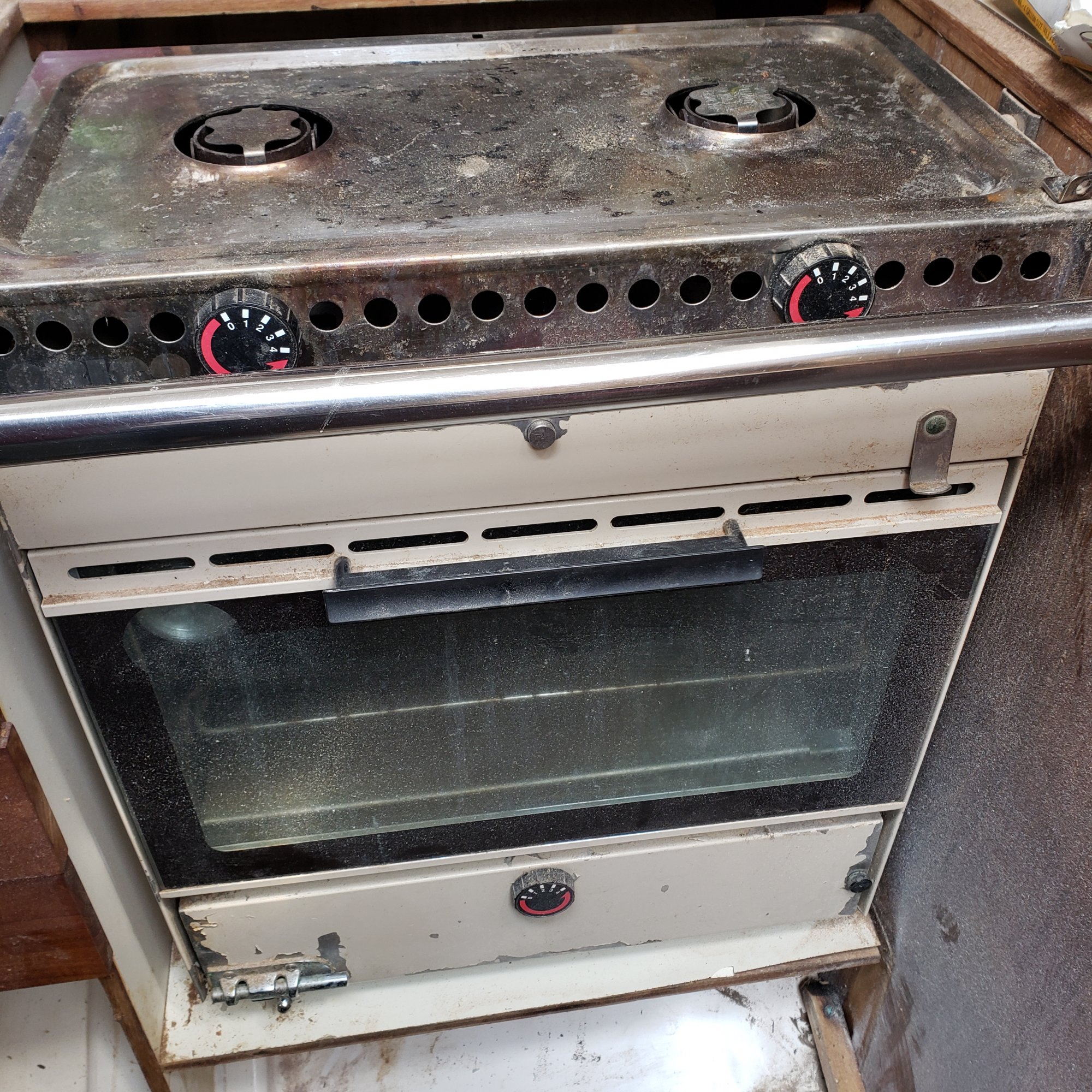

My restoration is now up to removal of the stove, but I can't figure out how to remove it. My boat is an 84 H34.

looks like an Origo 6000. Probably pop the top up and there will be screws inside the case. I only have a 3000 and it has a screw in setup but is above the stove as it doesn't have the oven as a counter weight.

Yes. Open the top, screws are on either side. The tabs that hold the weight of the stove will spring slightly to disengage. You might put a stick of scrap wood under it until you can get a good hold on it. Back lower corners of the stove are rather pointed and will gouge woodwork...

I removed mine, but it was a few years ago. I think the two pivot bolts are it. Be careful, it is pretty heavy and requires some maneuvering to get it up and out. I suggest having support to hold it up. It is difficult to get a grip to lift.

Thanks everyone! I found the manual on the internet and now realize that the button on the front actually does release the top part. I'll put some wood under the stove in order to brace it.
Thanks again!
