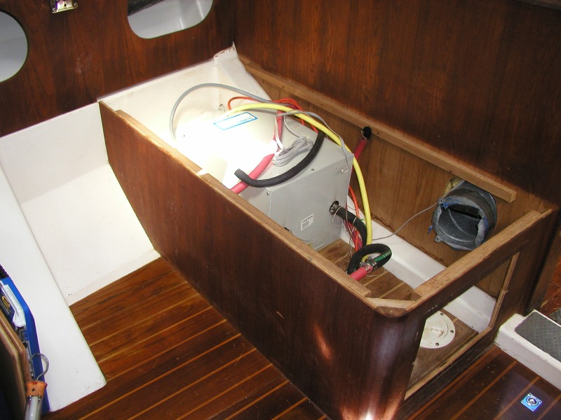

Hey, Highmillr.. I took some measurements in the starboard aft settee for my air conditioner installation.. The inside height from the top of the floor to the underside of the top plate is 15 3/4". This is the dimension of the front vertical board of that settee. The top plate sits on top and is flush with the outside of the front board .. I think the top plate is 3/4" thick but I am not positive of that.. I can get some more dimensions for you next week when I'll be there for a couple of days..

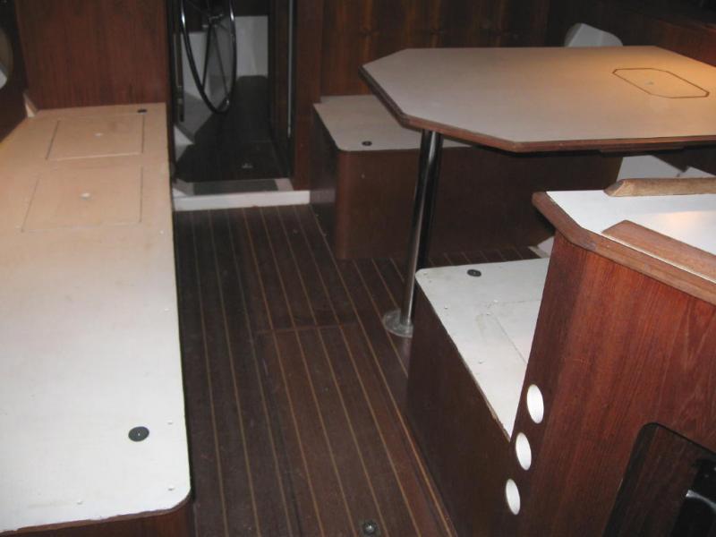

Kloudie, and Highmillr, on my boat top plate of port settee and 2 dinette seats is 1/2" thick.

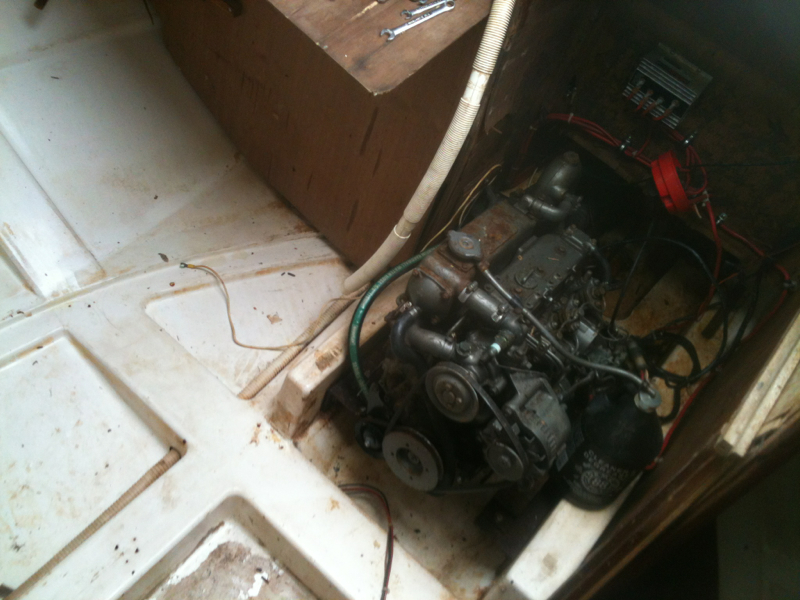

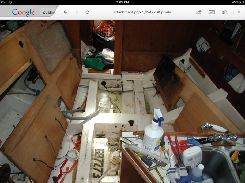

Wow you guys are great!!!! Thanks so much for all of your help on these measurements...I have the wood in the garage and have started cutting it ...next is staining and poly!!! Going with a sanded nice 1/2 plywood..and a "Cabernet" stain...got the flooring ripped out and have cut that ...going to resin the bottom to offer support and extra moisture barrier...pics to come...right now the boat is stripped clean of everything from the forward berth wall....back to the ice box stern....even the engine cover....looks like the engine is sitting in the middle of the floor!!! Have all but settee wood cut and about to knock that out next now thanks to you guys and the measurements!!! Thanks again!!!!

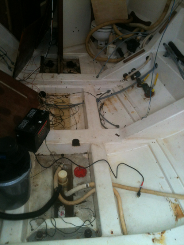

I really appreciate the pictures showing where the lines run under the sole. Some I am not sure whether they show Port or Starboard. I will need to redo the lines to/from the head and holding tank, so I like understanding the PLAN.
