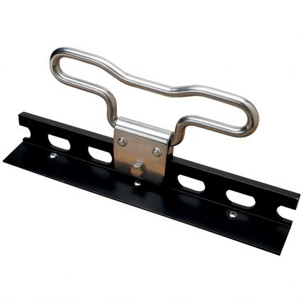

On my H31 I’ve used the Johnson folding cleats attached to the toe rail For spring lines. Attached at widest point.
