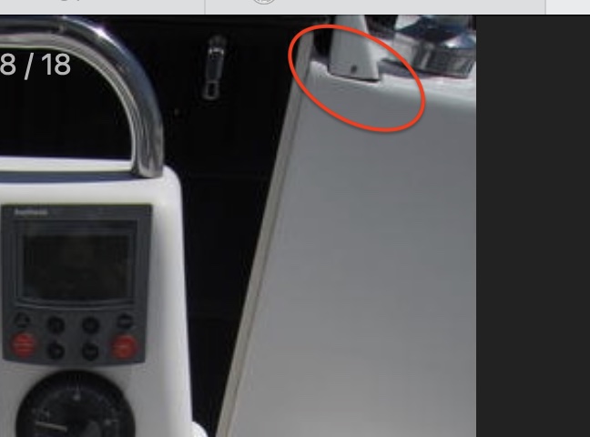

I think there is some photo trickery at work.
Trying to identify the image presented by the poster, it appears to be a close up shot of the companion way cover.
If this is true then the weather deck at that point on the boat slopes towards the sides of the boat either port or starboard. Based on observation of 310 boat images I suspect the location is on the port side of the companion way.

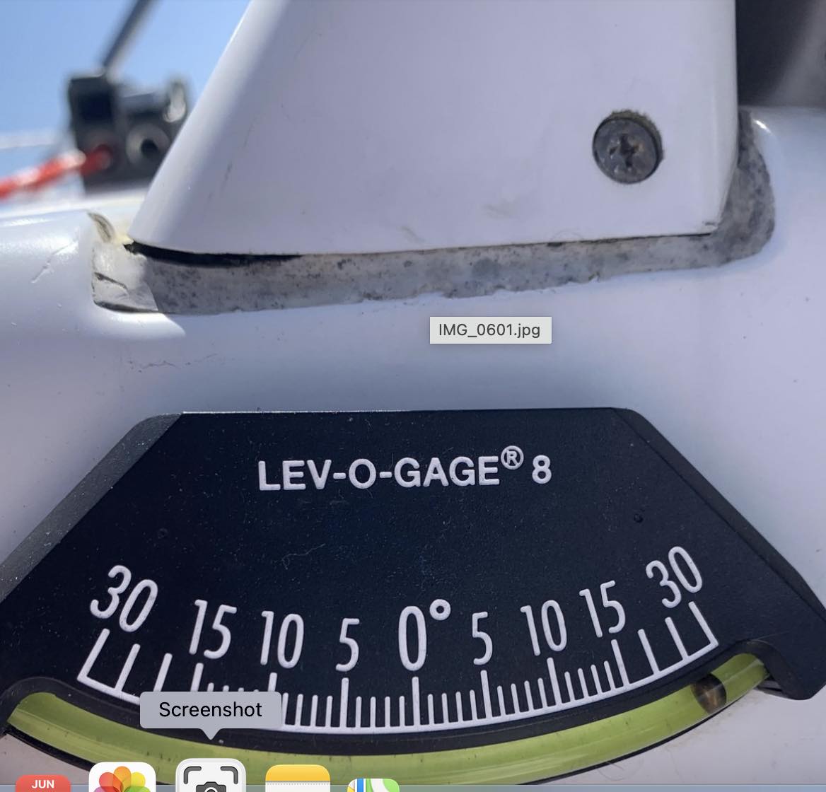

In order for the gauge to properly function the top of the gauge must be level with the horizon not a boat part.
So the 30 degree list appears to be induced by poor gauge installation not the boat heeling.

If the guage says zero when at rest on a calm day and gives 30 degrees of heel on both tacks, it isn't the guage that is the problem. 30 degrees is a hard concept to get, but it's simple enough to measure.
