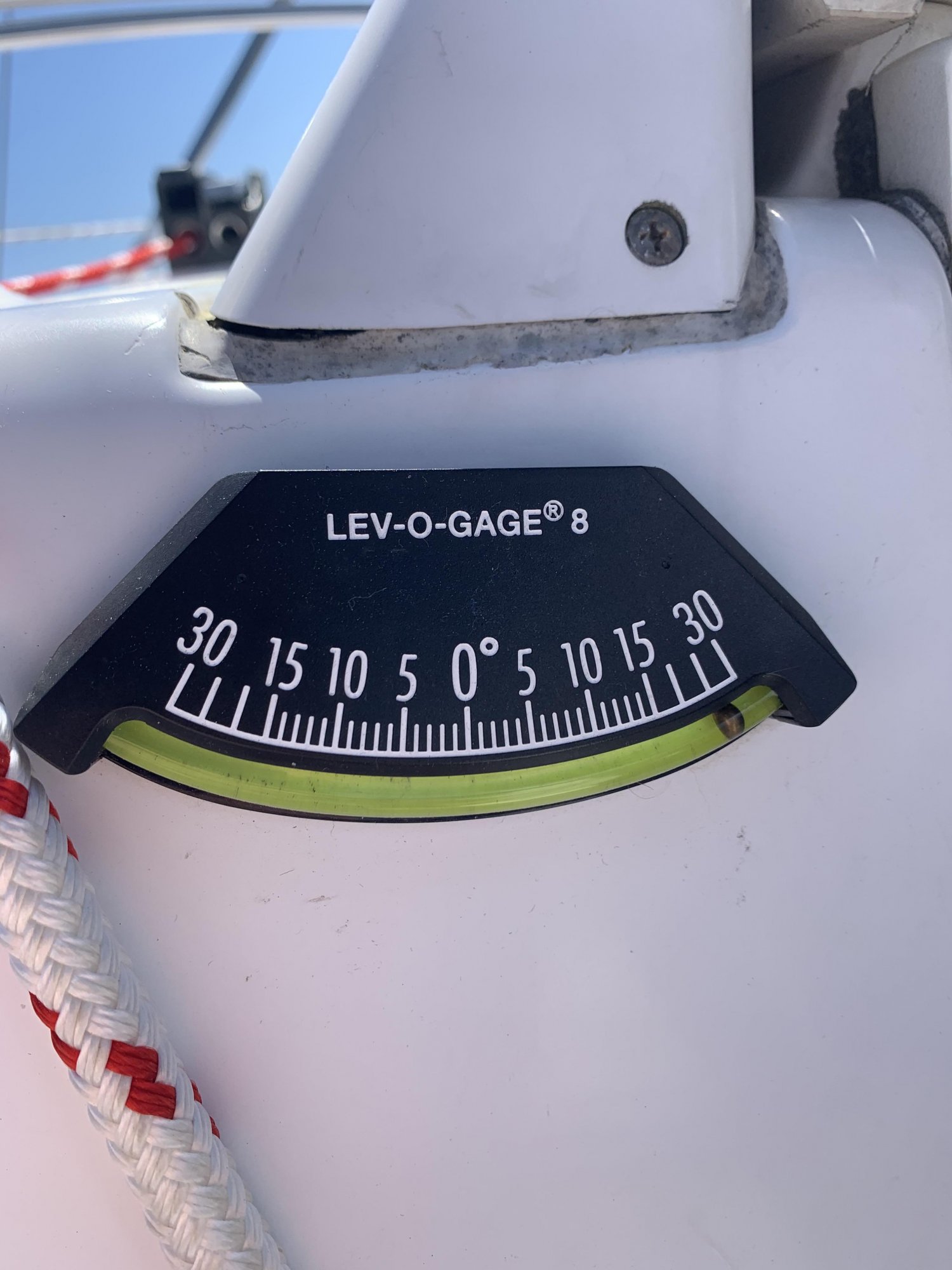

Wdonovan (sorry, spell check changed the spelling of your name), I see you joined us about two years ago so I'm reluctant to ask this question of someone with a few years of sailing exprienced, but I have to be know. When you say 30 to 35 degrees, is that measured or an estimate based on how it feels? That's a lot of heel and things start sliding off the deck at heels like that.
You probably already know that people with little or no exprienced on a sailboat can worry something fierce about a boat tipping over with even 12 degrees of heel. So just to be clear, that's an actual 30 to 35 degrees of heel and not 20 degrees that feels like 30? I don't want to insult your seamanship, I just don't know what you know.

It pinned the gauge more than once. I was too busy to get a pic of more than this 26 or 27. And the high heal times weren't brief during puffs, they were sustained.

Let me guess...
Always to that side, i bet.
The reason is your gauge is NOT level with horizontal.
Jim...
Hope you didn’t put a lot of money on that bet jim. The gauge is perfectly level. I saw over 30 on both tacks.
