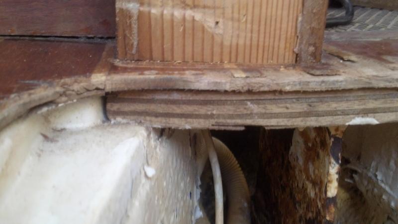

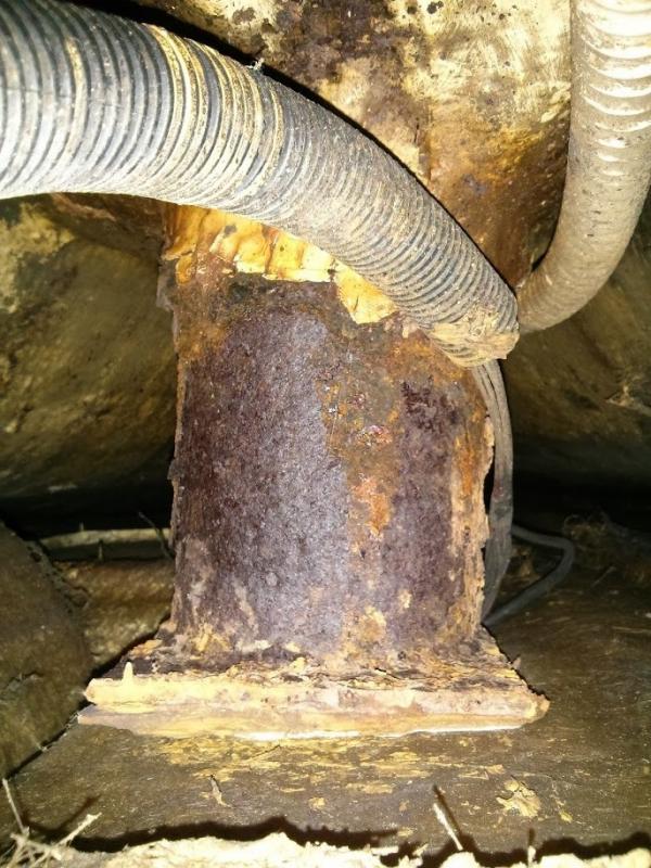

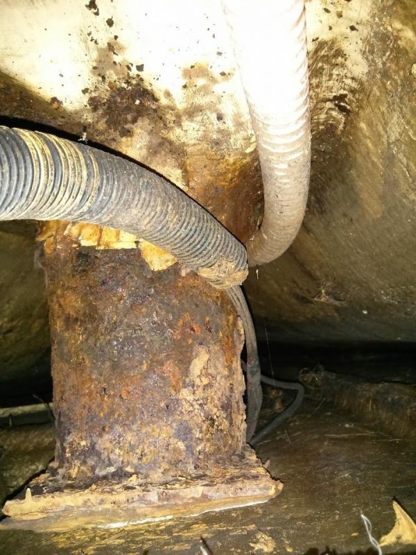

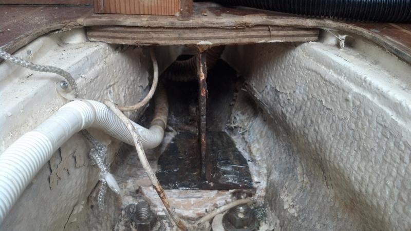

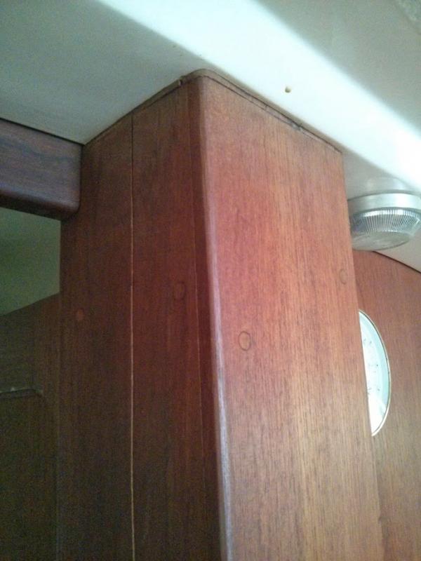

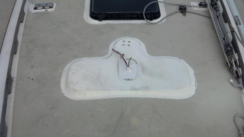

I'm in the process of replacing the compression post / I-beam on my 1980 Hunter 30. Some photos of what I am doing are below. You can see that the old I-beam has rusted and is warping from the off center load on the web. The plywood floor has delaminated and warped under the load of the compression post.

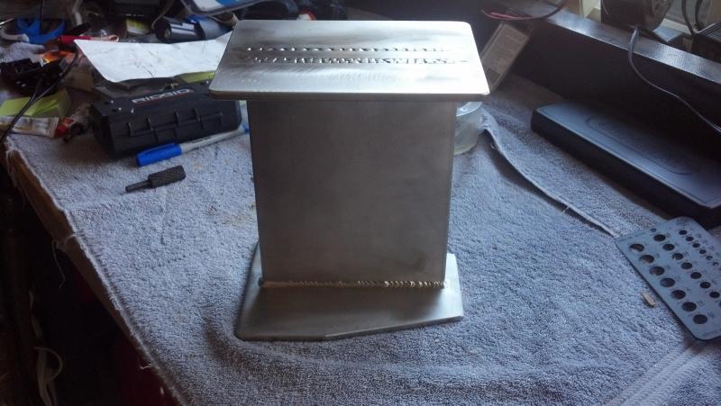

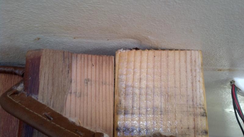

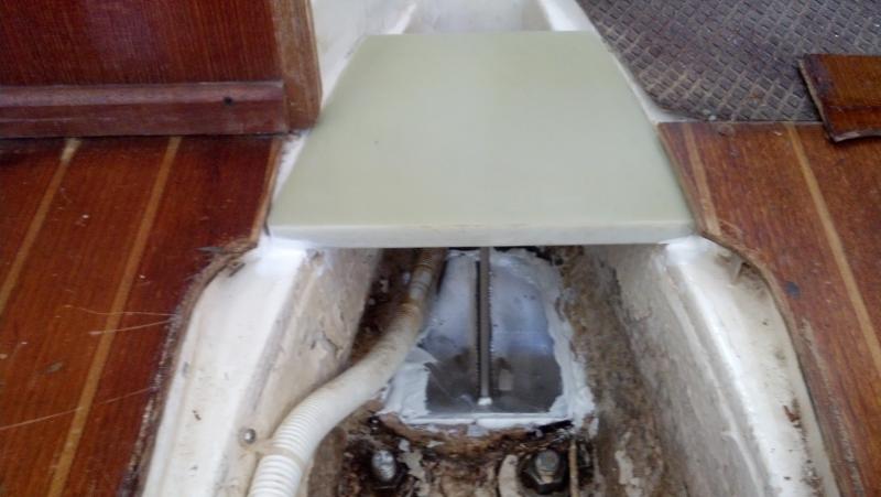

I've replaced the carbon steel I-beam with a copy made from 316 stainless steel. A G10 plate sits atop the I-beam, to replace the plywood. I plan to sister up a new compression post adjacent the old one, so it lies directly in line with the mast and the keel, not off to the side as the old compression post did.

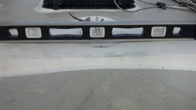

One question I have is how much should the new compression post raise the deck? My guess is that over the years the deck has slumped at least an inch (1/4" here, 1/4" there, etc.) A small bottle jack can easily raise the deck from below by an inch if not more. When I do this however, it lifts the deck off the bulkheads. Is this a problem? I kinda think other than from a visual standpoint, it's not a problem, I'm simply pushing the deck up to where it originally was.
