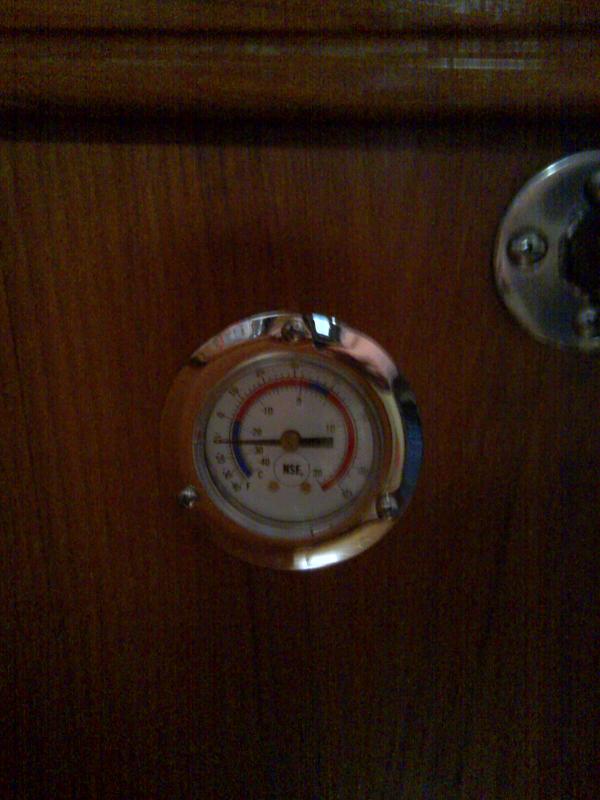

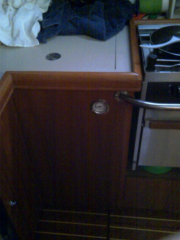

My freezer backs up to the galley sink. Part of unit is under galley sink on wall the cold machine part is in the freezer, much like this design. The difference is the compressor is separate and next to a/c under settee in front of galley. I would concider this adler unit for a replacement if that ever came to pass. Would just loose some space under my galley sink. But would pick up space else where. Looks like a very nice design. Some friends had a 29.5 and I believe this adler design may work, just would need to do a little farther investigation to confirm.
