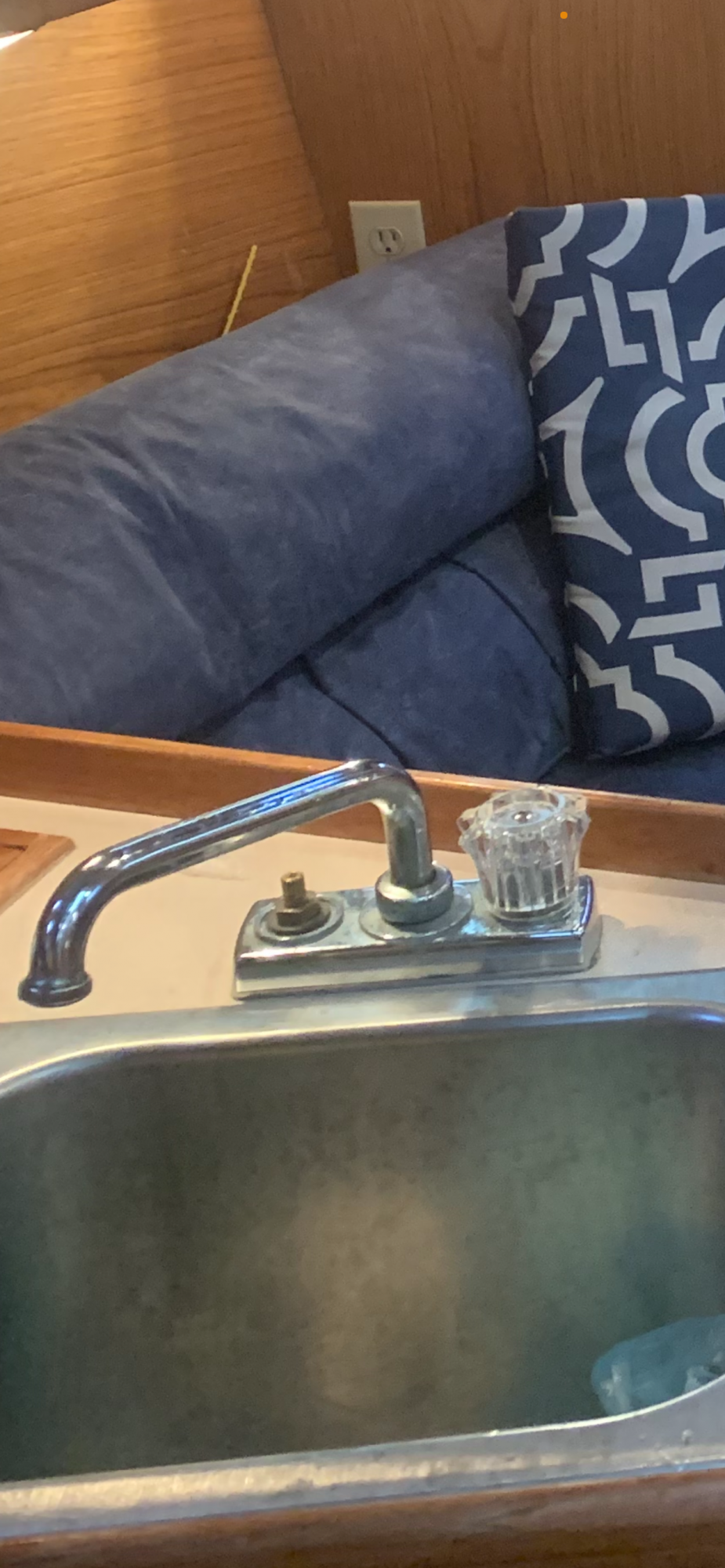

hunter 290 toronto
The issue is that the documents section here says the faucet is discontinued and no name is indicated on the devise either....still works fine except hot side leaking a small bit and needs a new cartridge. Cannot visually match at the plumbing store.
thanks for any help

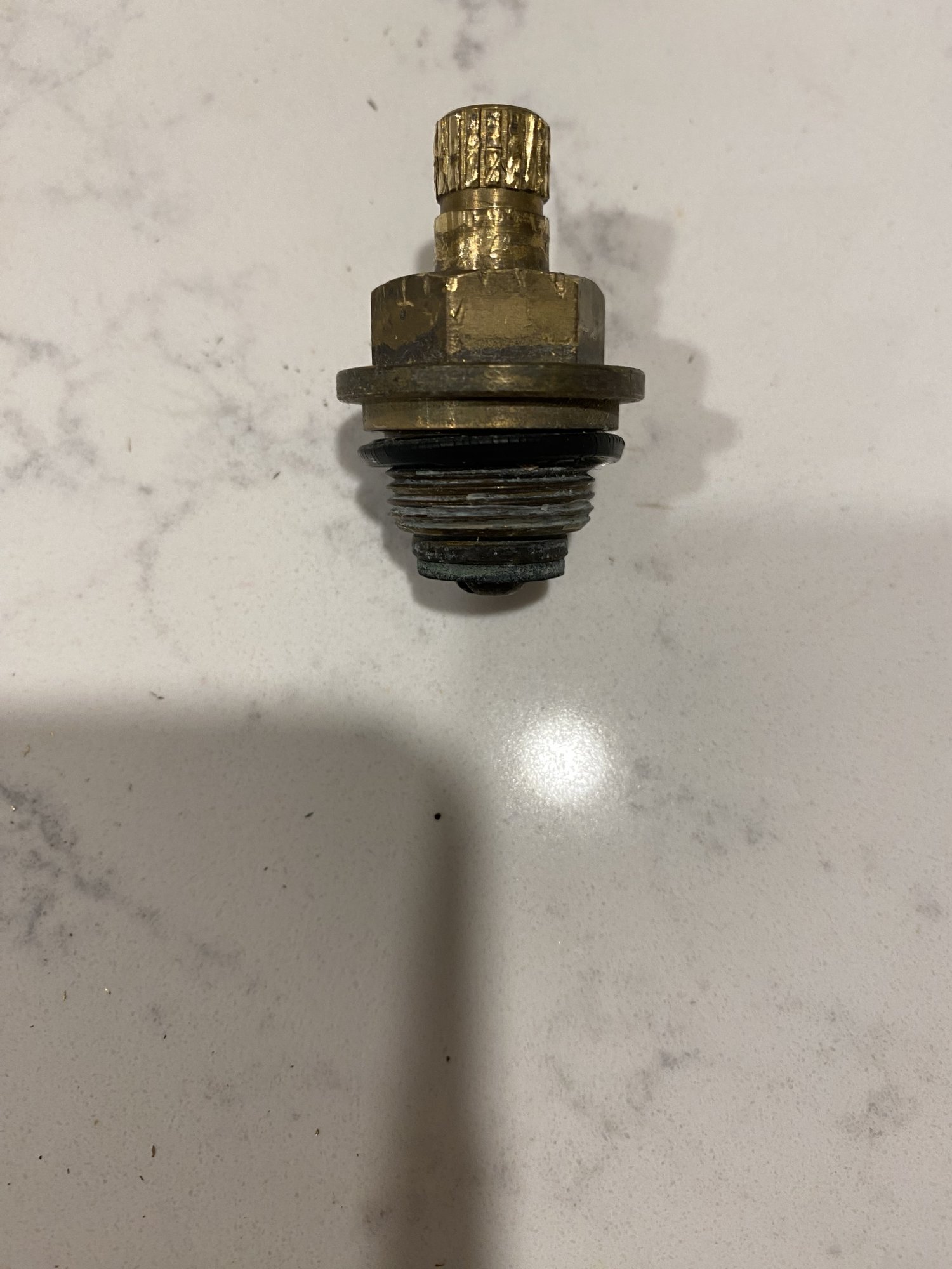

Here it is thks
Colin
That's a really old school valve. If the stem isn't too chewed up, it is still useable. What you need are the washers and o-rings. Something like these from Lowe's.
Or you can see if this stem works if the stem is unusable. I searched for Laundry Tub Faucet Stem.

I soaked mine in CLR overnight and put in a new gasket and O ring from ACE. Works fine now. FWIW
