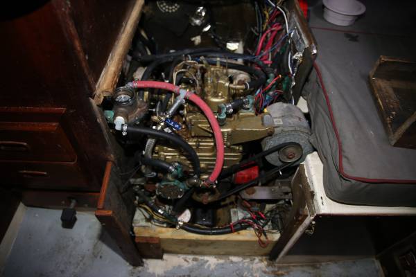

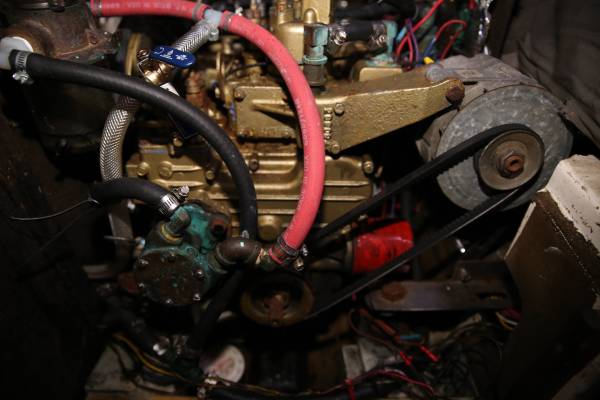

Good day everyone. I'm usually a reader, but decided to come out of the shadows to ask for help.
I have a 1979 Hunter 27. It has a Universal 5411 that has kicked the bucket I'm afraid. After having starting and power issues I changed the fuel filters, bled the fuel lines and still couldn't get her to work. After having a mechanic out I've been told that the injector pump needs to be rebuilt, injectors need to be replaced, and that there is really no point in doing that work when I only have 150 psi compression on each cylinder.
I'm on a limited budget and have little know-how, much less the tools and space to do much work myself. I see my options as having this engine pulled and rebuilt...makes me nervous considering the expense, the fact that it is raw (salt) water cooled and already leaks water from somewhere, and I have no idea the condition of the transmission. Replace it with another 5411, I saw on diesel trader a engine/tran combo for $2800, not cheap but a consideration. Replace it with another inboard, which is probably the most expensive option and likely out of my price range, or slap an outboard on there, there is already a motor mount installed.
The last option is to just sell it as is. I was looking at selling it before I started having engine trouble.
My budget on this was only about $2000, it looks now like that number is long by the wayside considering I have about $600 in mechanic hours already into it. Any and all advice is appreciated.

I have a 79 H30 and has a single cylinder Yanmar YSM12 10 hp diesel. I thought the 79 H27 had the YSM8 8 hp. There was a rebuilt ysm12 on Ebay for $2500. Still may be there.
It's still there $2500 or best offer. Comes with tranny and instrument panel. He's in Florida but worth the drive. He says it's 18 hp....I questioned him earlier that it was only a 10. He said the nameplate says 18hp...........?

I would consider rebuilding it myself. You can find a manual with rebuild instructions and it will probably cost you around $1000.00 in parts and a few special tools. If you are able to read up on it and follow and understand the manual it might be doable.
Likes: griffinburd
23,546
Consider that switching engines WILL INVOLVE wiring, the exhaust system and a ton of other little things you haven't considered. ITWMB, I'd do a LOT of research and homework on that engine specifically.
www.marinedieseldirect.com has the parts and manuals, but you most likely could find them online, since many Catalinas had them on their boats and the Catalina one Design associations, like the C30 and C27 have good websites with tons of information. So did Ericsons, there's and Ericson website that's very good, too.
This is one time, actually another of many, many times, when Google can be your friend.:deadhorse: I know some folks don't like hearing that line, but it's true. :) "Universal 5411 rebuild" would be a good start, huh? :D

Many sites that I've seen regarding the 5411 rebuilds say it's simply not worth it. The internal corrosion can cause components breaking when being disassembled, arts are getting harder to find. I am seeing gray oil so I know that it's had saltwater inside of the block. Another issue with rebuilding is I live in an apartment, short of trying to build a stand and working on it inside the boat (yes I know possible, but with my luck I'll end up with a 200 lb piece of iron on my foot) I don't know that I'd feel comfortable doing that.
Now if I had a garage and some room, I would LOVE to work on it. I think it would be fun and a great learning experience. Just right now I don't have that option...maybe if I didn't own a boat I could live in a house...nah...
All that said, what I guess I really need help on is:
Do I pay someone to pull and swap a different one in (it sounds like there is A LOT more to it)
Do I replace the parts and hope that the 150 psi is enough to crank it.
Do I get an outboard (if yes I assume a 15 hp, 20" shaft will do)
Do I sell it as is, take a huge hit, and learn my lesson. In the late summer I considered selling for $6500 when everything was working fine, though without the engine I'd probably take $4000...but even that may be asking a lot.
I don't mean to be difficult shooting down rebuild suggestions. As I said I just don't have anywhere to work on it. I am very appreciative of the advice so far.
