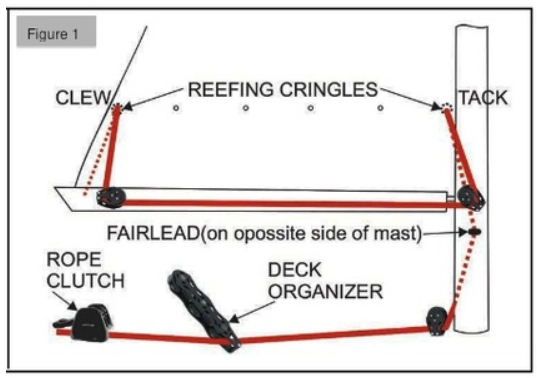

I sail a 260 solo quite often and find with our newer fully battened, full roach main I reef a lot more. Going to the boom in snotty conditions is a leap of faith - see nothing but bad in the future.
Think I have a nice design plan to install 2 single line systems (using small blocks to minimize friction) back to the cockpit. Really don't want to set the rig up/take it down to take line measurements. Any rough idea how much I'll need? My estimate is 55' of 3/8" for the lower reef.
Yep, that is what I did. It works really well with the blocks on the tack reef and clew reef. I would think 55' is plenty on your boat as I used that length on my C30. I use 5/16th NER VPC line.

Had a nice conversation with Dave C.
He suggested that folks have used turning blocks and controlled the single line reefing system from the back of the boom. This would definitely allow better solo control of the tiller.
