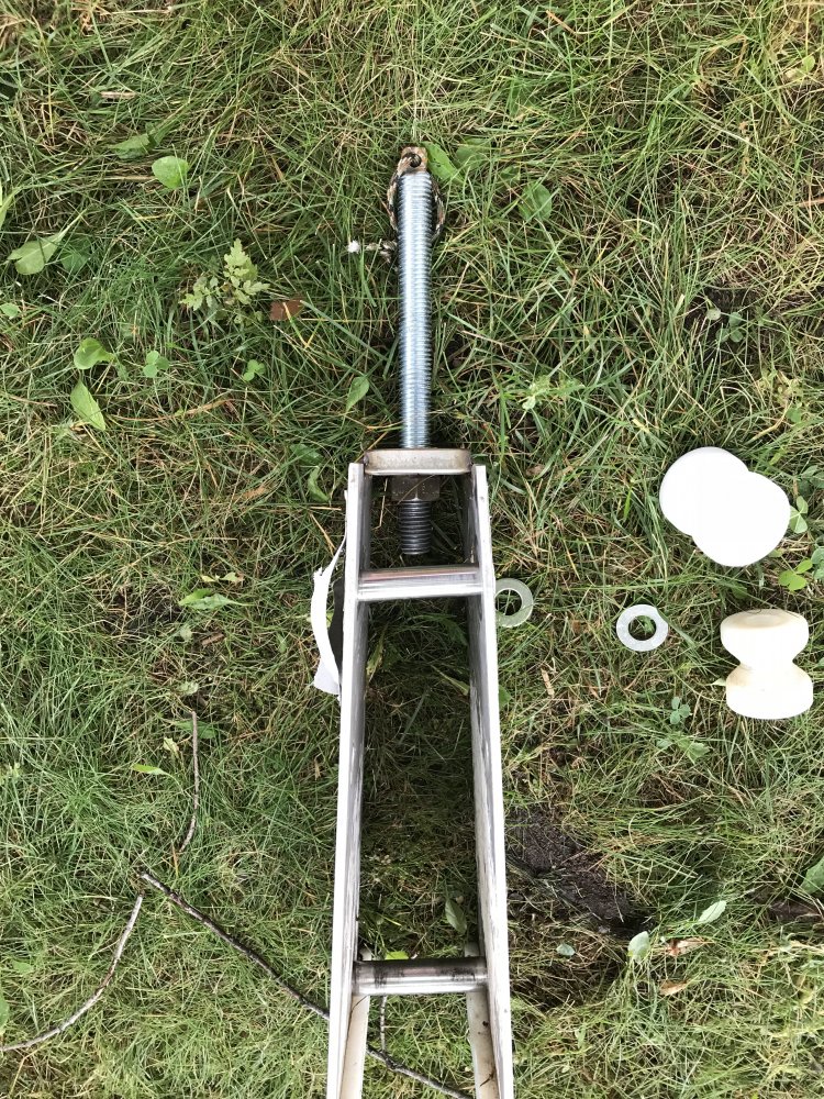

Here’s an update... the centerboard has been reinstalled successfully and she’s been sailed a few times. The problem has not yet really been fixed. The centerboard bracket was incorrectly drilled for the roller pin, with the hole on one side plate a bit higher than on the other side plate (see pic). The result is that the roller rubs (hard!) against the side plate where the hole is higher, which creates quite a bit of drag. For now I just installed a pair of stainless washers between the roller and the side plate to create a thrust bears of sorts. The tension on the uphaul is still very high, but now that know all is basically ok and nothing is going to break I don’t mind having to heave on it.

Long term my plan is to drill/grind the side plate holes out to 3/4” diameter raising one side a bit and lowering the other side a bit so that the pin is parallel to the top plate. I’ll turn a new roller with a 3/4” bore, and a slightly shallower groove, and replace the 5/8” pin with a 3/4” pin. But that’s a problem for another day...
