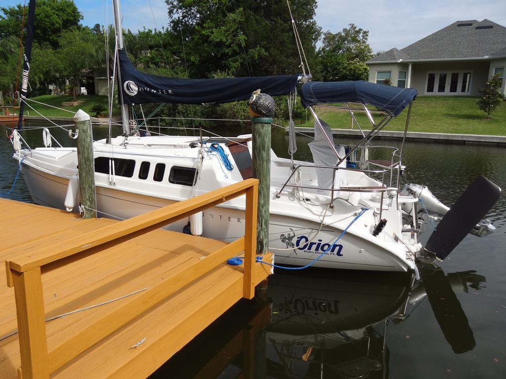

You could go with a 4 ft. Bimini, you would not have to do anything when under sail. It stays clear of the boom.

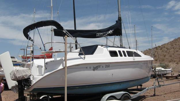

On my H26 I have a 6ft Bimini set up so that the boom passes over top ( I believe that I have almost 6ft clearance below my Bimini). You will have to move the main sheet forward on the boom to clear.
Apr 11, 2014
97
Hunter 260 Lake Lanier
We have the 6ft bimini on our 260. Instead of moving the mainsheet, I slide the bimini supports aft. This gives enough clearance to the mainsheet. While there is some aft overhang, I find that more useful while at the helm. Helps provide better sun protection in that position.

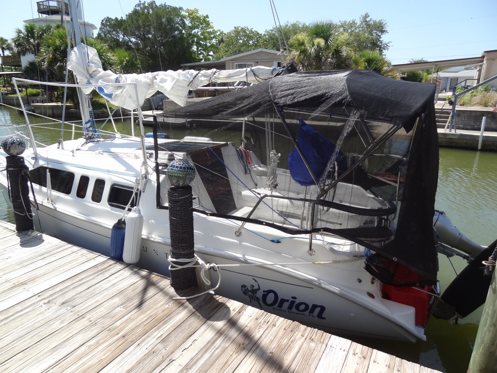

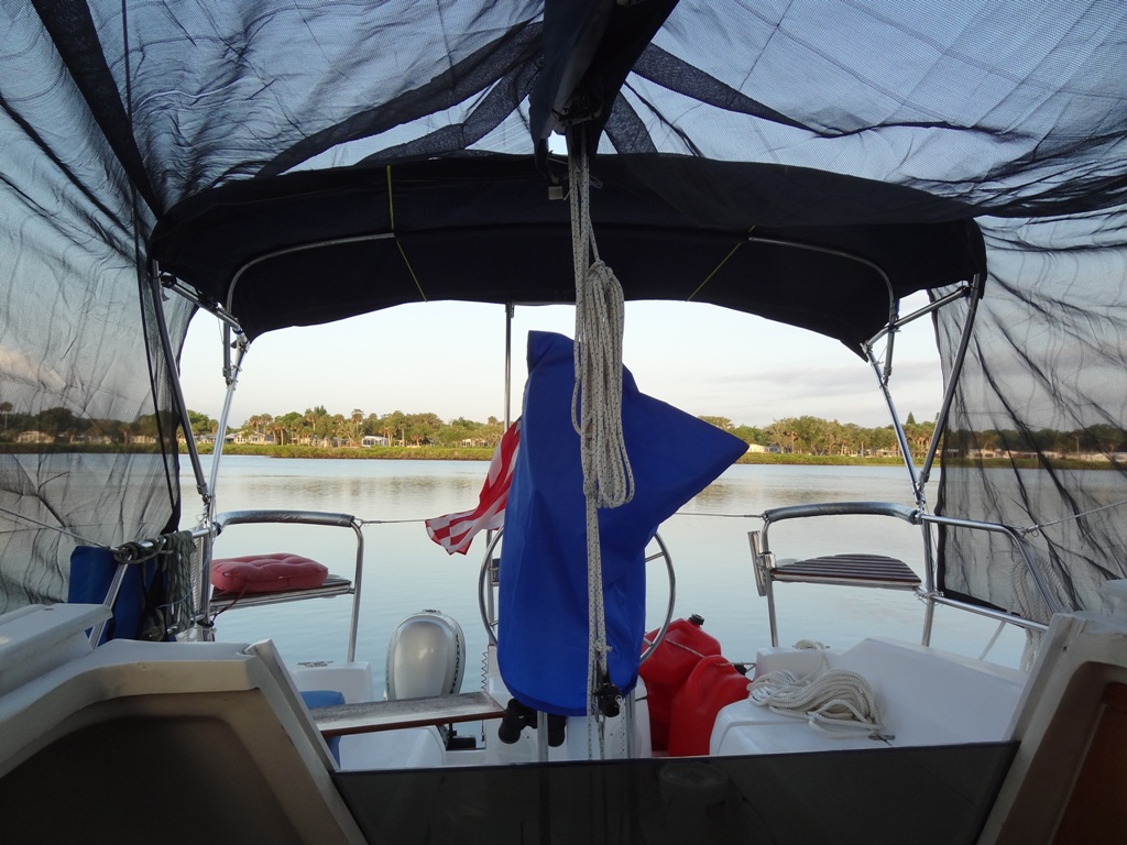

Hey Reg Guy... Where did you get that netted sun shade. Is it standard? I like it!
Jan 18, 2014
238
Hunter 260 Palm Coast, FL
Fred,
I bought it at Harbor Freight. When I right remember, the size of the black mesh heavy duty UV screen shade was 12 x 20 feet, paid about $30. It has a very fine grit and shall filter out 80% of UV light. I really like it, close the cockpit to the transom as well.
My impression was, it reduces the heat by 10 degree, and has the extra benefit to kept the bugs out of inside and cockpit. A relieve when on the water or anchor in the hot season.
