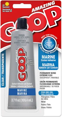

Next time on the trailer... crawl under and see if your gasket has left this earth. There should be a circular neoprene gasket around the lip of the valve cover plate. I had to rebuild mine on my H26. I used goop. I have a pic someplace but can't find it right now. With the tank valve open I took some masking tape and made a dam around the lip of the valve cover... then I poured a tupe of goop onto the valve cover and let it sit for a few days..... now I had a hard rubber coating about 1/4" deep on the valve plate. When I closed the plate tight, it made a water tight seal.
