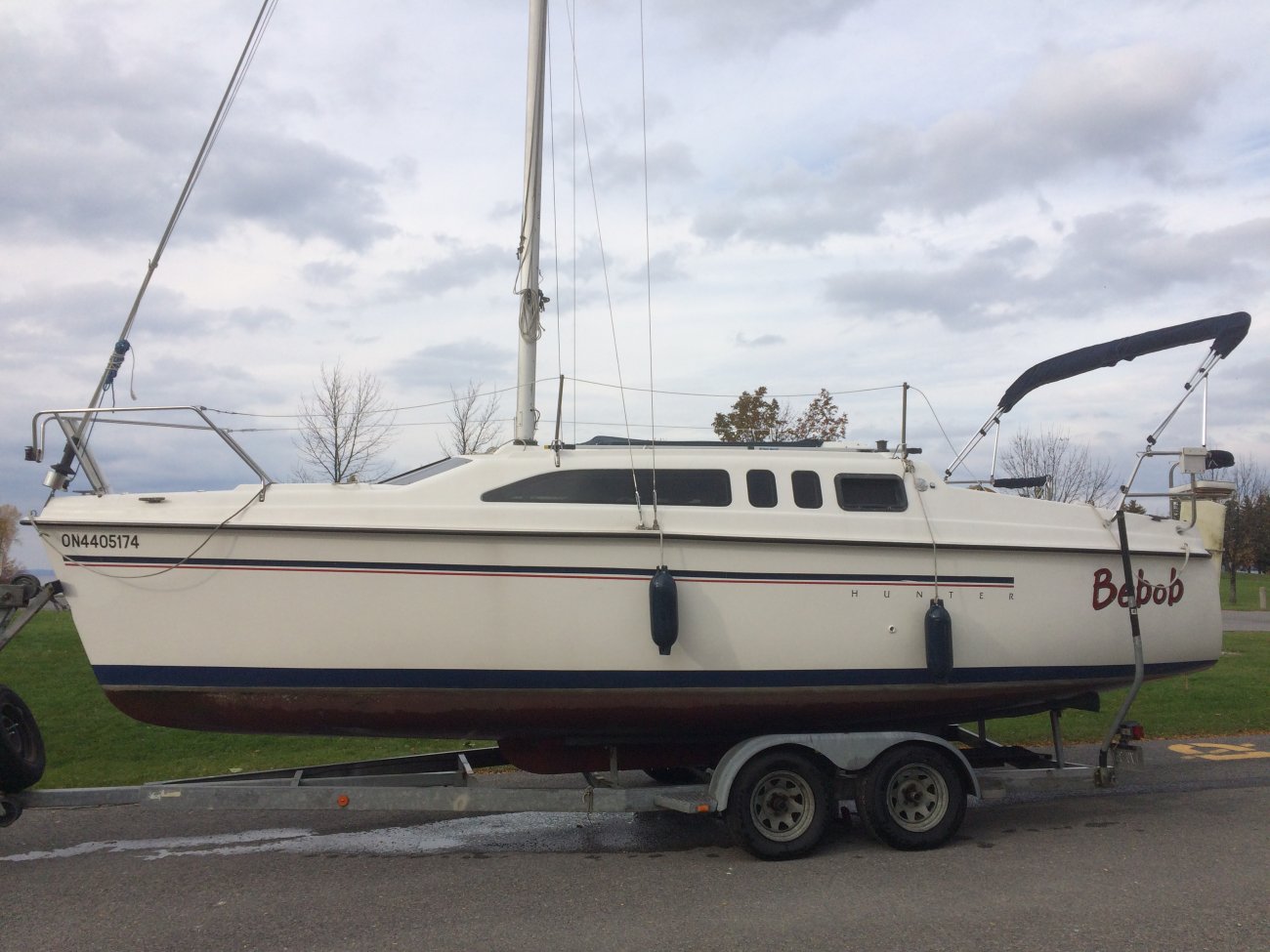

I have a stock H26 galvanized trailer with an extending tongue for my 1996 H26. I find that when towing, the trailer bounces and seems to go into a resonance above 90kph. (50mph). I have had the wheels balanced in the past and it didn't really go away. The same resonance occurs when the trailer is unloaded but just with a bit less energy. I noticed that there seems to be some (1/2 - 3/4 inch?) up/down play in the tongue extension and am considering thru-bolting the extension since I never use it nor can I since PO removed the flexible brake line piece.
The boat is normally strapped down tight on to the front bumper stop with the winch strap and I place a 2 inch strap over the stern to keep it bouncing or shifting on the trailer.
Does anyone else have these issues or have they bolted the extension tongue?
Just noticed this year that the inside edge of the leading tires are badly worn. The tires are six years old and probably have seen 10 - 15k kms in total. Is this normal. The tires on the trailing axle look almost new.

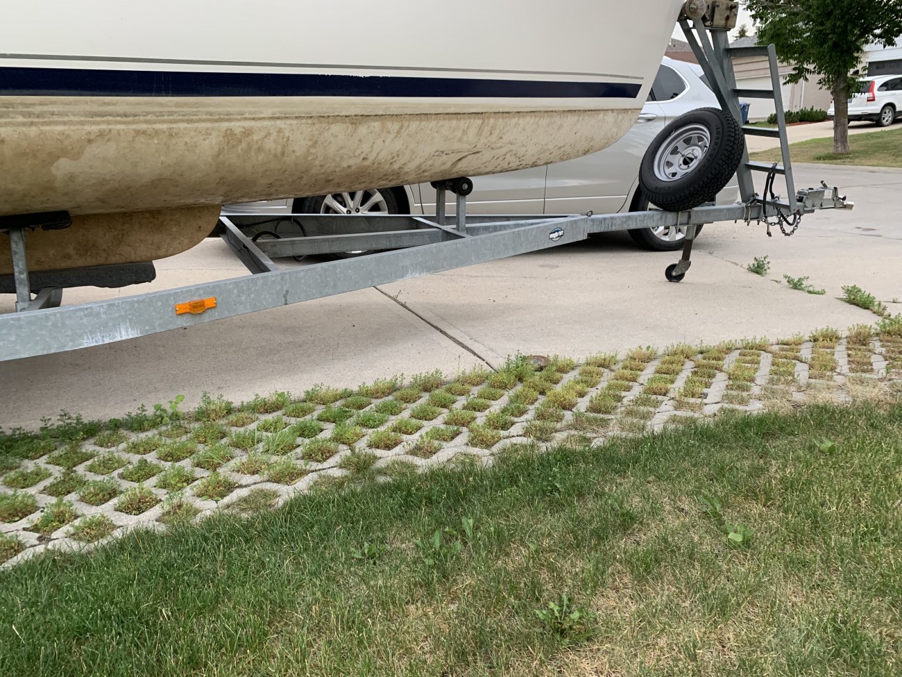

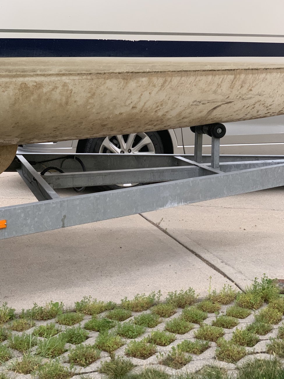

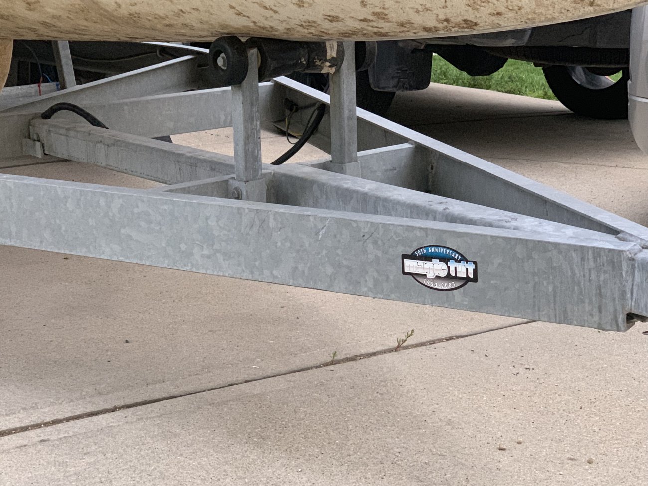

The stock 26 trailer seems to be missing a roller/support under the bow that is present on the 260. At speed I could see the bow being lifted and then dropping causing some of your bounce.
Perhaps Dave can say why the roller was added on the 260 trailer.
I doubt the tongue is the issue - ours has the same set up. It also wouldn’t likely be the cause of you front axle tires wearing more rapidly.
Can you have someone ride in the back of the Yukon, get up to bounce speed and see of the boat is moving vertically in relation to the trailer?
Roller may have been added just to deal with the weight of the bow tank but I suspect there may be more to it than that.
