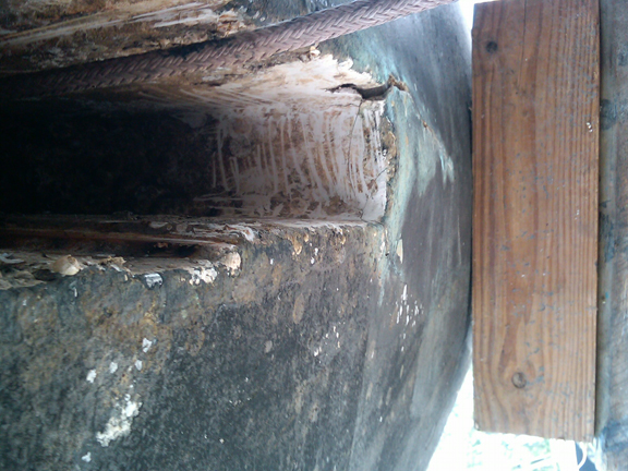

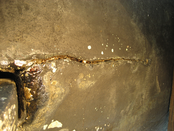

Is anyone aware of this problem or has anyone had this problem??? Sorry for the long post, but please read below and look at photos. We are battling the insurer to save this boat! (I recently posted this on the Ask a Hunter Owner forum and have reposted it here under some great advice from a responder!)

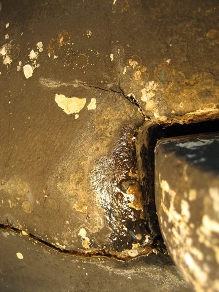

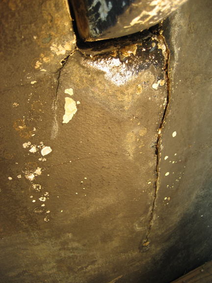

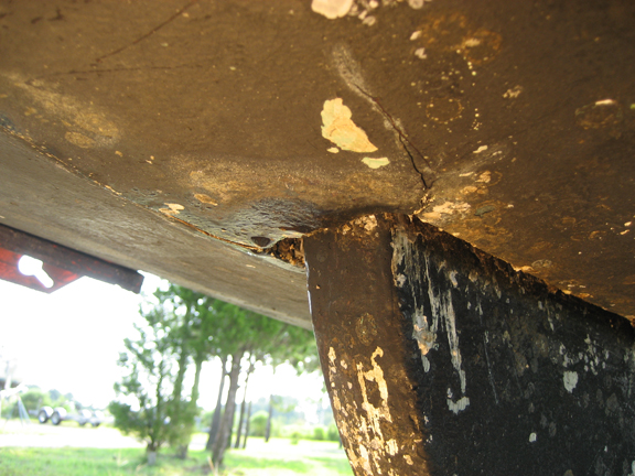

My father-in-law owns a 1994 Hunter 26--swing keel/centerboard with water ballast tanks. This fall, we discovered cracks in the hull originating from the front of the keel/centerboard pocket and progressing toward the bow. (Please see the attached photos.) The starboard crack is approximately 12 inches in length, about 1/4 inch wide at its worst, and old enough to have marine growth in it. The boat has not been hauled in at least a year. The port crack is smaller and appears to be relatively new. These cracks originate from the 90 degree reentrant corners of the keel/centerboard pocket. They progress vertically, but not all the way to the top of the pocket, and have caused some delamination within the pocket.
Our and the boatyard's best guess to the cause of the crack is impact. We have struck ground on multiple occasions while motoring. Exiting the creek where the boat is docked requires crossing a shallow sand bar (point of this boat). Unfortunately, powerboats take advantage of the unpatrolled waters to plane across the bar at his speed. On more than one occasion, we have been caught in boat wake and slammed down on the packed sand bottom.

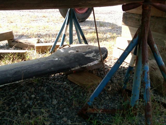

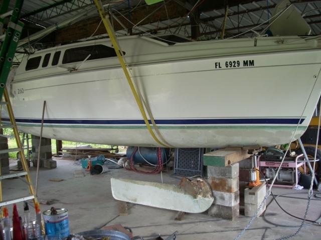

The centerboard is fiberglass. After the boat yard pulled it off the boat to give access to the trunk/slot it rests in while in the raised position, I moved it over on some blocks myself. Not light by any means, but not a lead keel either.
I had actually considered the idea of cutting the whole section out and rebuilding it with glass--the area with the cracks and delamination. Haven't run that by the repair guys yet. This would be a larger scale repair, but I know Laser's have a bad habit of ripping the mast step/pocket out of the deck when turtled. Laser's make a repair part that is put on by cutting about a 2'x2' section out of the deck and glassing it in. If you can do it for that, makes sense you could do that here.
***I added a picture showing the centerboard on the ground. In the second new picture you can get a feel of the full length of it and how it sits when raised. It protrudes from the bottom of the boat about 6 inches.

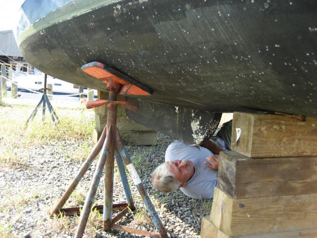

The picture showing the boat bow sitting on the block of wood.
Was there a period of time the boat was on the hard with the block located where the hull is cracked?
Would seem to be a lot of weight in one place – as opposed to a couple of boat stands at the bow.

I'm not real happy with those blocks either, but there are 2 sets of jackstands on each side of the boat (4 total). I think more have been added, but can't remember how many. A hurricane feinted the area about week after it went on the hard, and the boatyard put extra supports underneath it (we knew it was going to be there a while at that point).
Good thoughts on the blocks, and I been told that boatyards that improperly hoist a boat can damage it. However, we discovered the crack because water was seeping out of it from the ballast tank when it was pulled out of the water. (The rear plunger drain was opened.) Also, the crack is old enough that barnacles are growing in it.
***I added a picture to the original post showing the jack stands. This is pre-hurricane.

OK, that looks better
I can't help to think that was a catostrophic event.
The centerboards just are not that strong to lever or pry that hard to damage the hull.
Certain the centerboard would just break.
