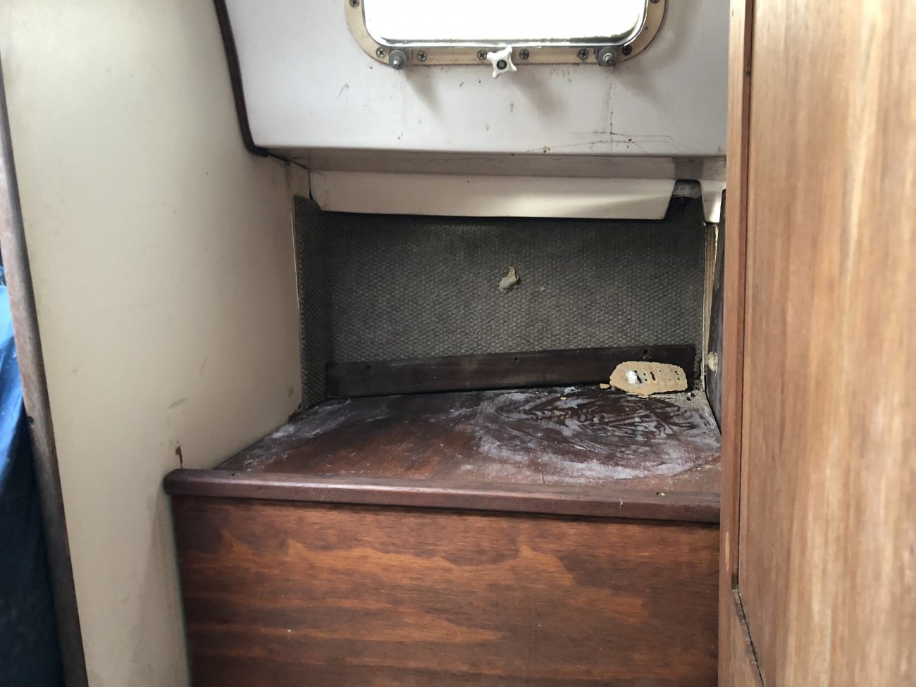

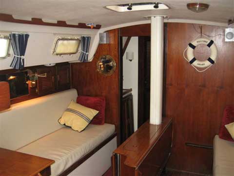

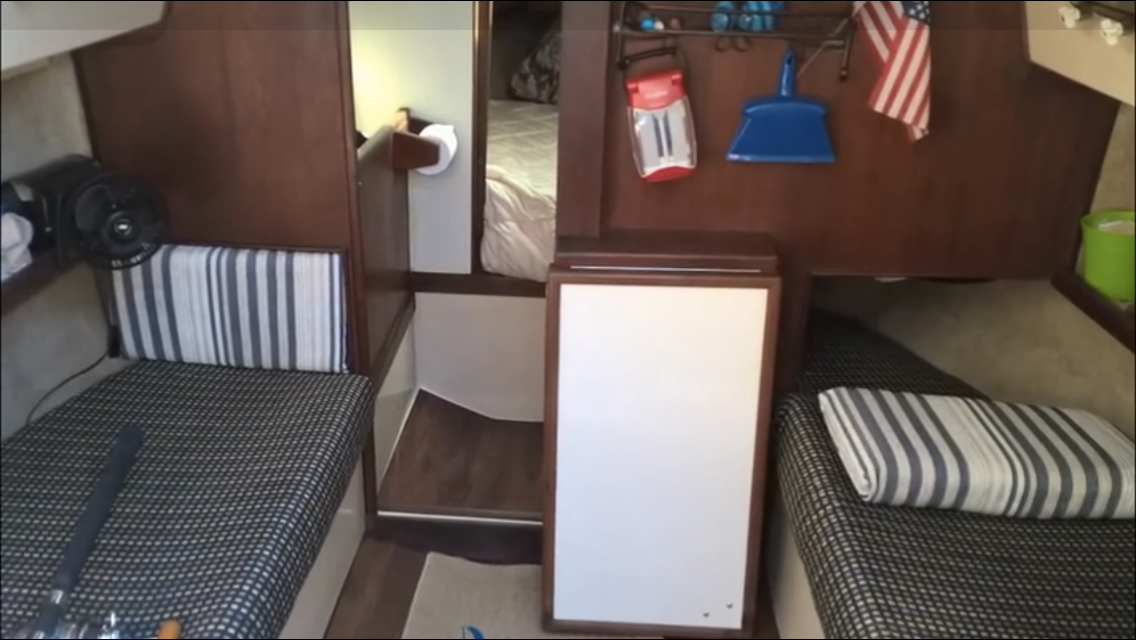

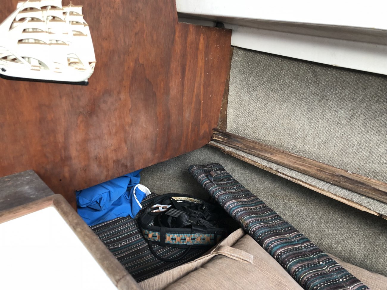

The first two images (grimier of the 4) are my boat.
The other two are off the web.
I was thinking I could open this boat up making it very spacious. But if the walls are structural then I’m out of luck.
