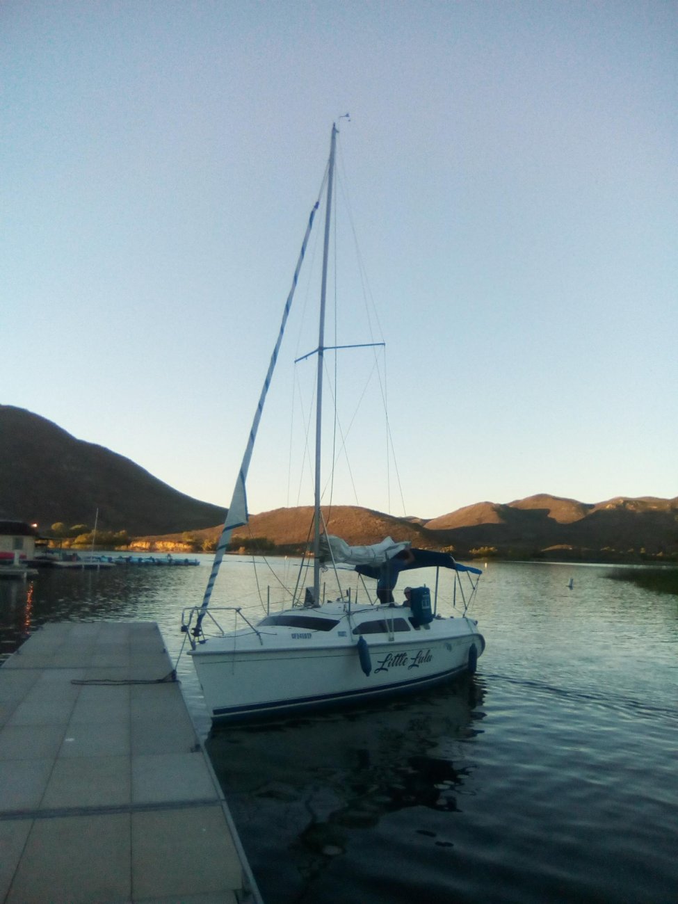

Just found the pin! Tried it and it works much better now. Had a great sail today on Lake Skinner, a beautiful small reservoir near Temecula, Ca. Good wind, full sails, beautiful experience with one of sons and my sister. I think I got the boat dialed in now - enough to go out solo. Thanks for helping arrive at this level!
