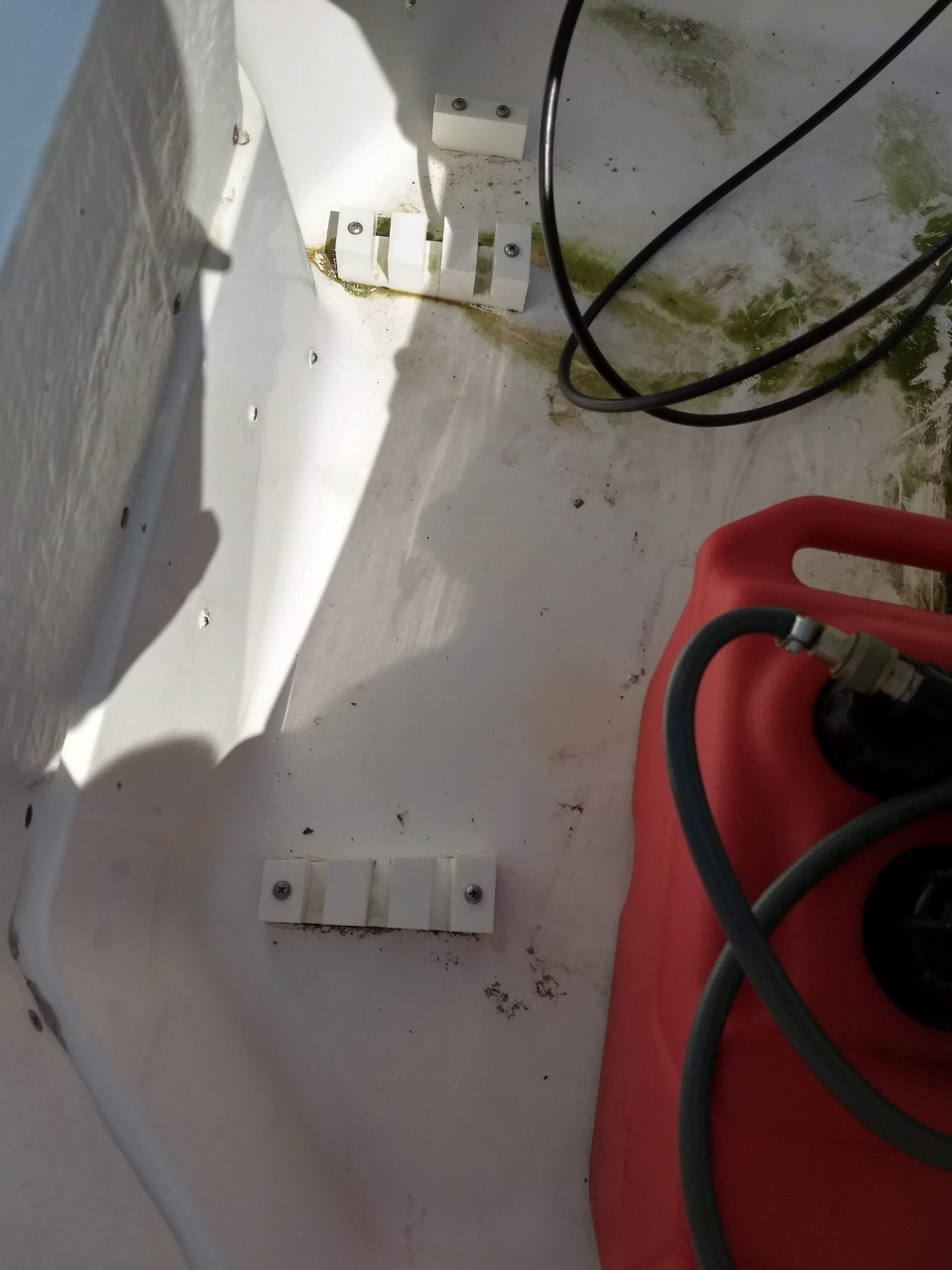

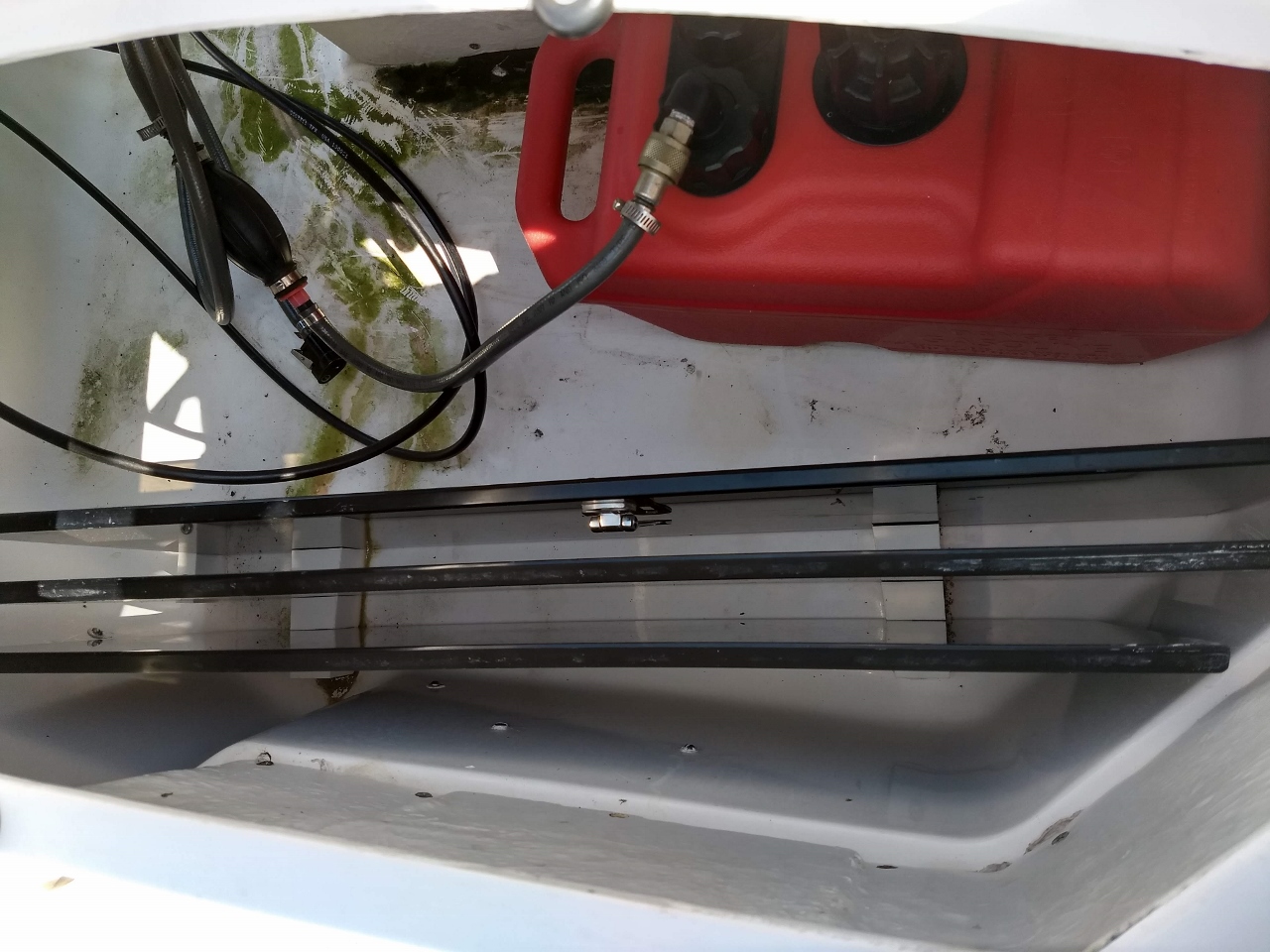

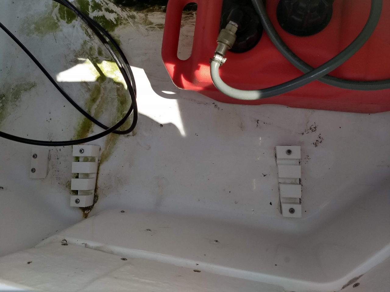

On my previous 240 I made a set of slotted brackets to hold the 3 boards vertical in the aft fuel locker. I used starboard and cut the slots to fit the thickness on a table saw. Probably more work than you wanted, but worked well for me, and keeps them out of the cabin. They do fit in that locker with a 3-gallon tank, so you might think of other ways to secure them.
