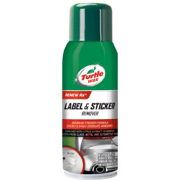

Aug 12, 2014
2,207
The back cushions in the cockpit of my 23.5 were held in place with velcro like strips. They, too, became cracked and unsightly so I removed them and just use portable cushions. It's been years since I removed the velcro strips but the glue that held them remains. If anyone has a good method of removing this glue, let me know.
This stuff is amazing. Worked much better than Acetone, Goof Off, or Goo Gone.

Got the adhesive off with acetone and quite a bit of elbow grease. Neither Goo Gone nor Label and Sticker Remover could touch it. Must have been some mighty good glue!
