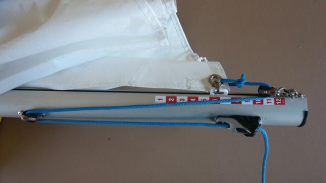

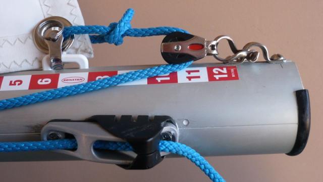

I have changed the previously self installed V Cleat that held the outhaul line with a two part cleat from the UK Clamcleat company. This one has an accessory 'Keeper'. The main advantage is that this setup overcomes the problem of the line being cleated accidentally when you have released it. I have also shackled the mainsail's clew to a small sail slide to keep the clew close to the boom.
Here is a complete parts list for this setup:
Model # Item
Small Sail Slide 16mm(w)X32mm(L)
Small Shackle
RF20101 Ronstan Series 20mm Block
RF627 Ronstan Twisted Shackle
RF2105A Ronstan Series 20mm Cheekblock-Rivit Mount
CL211 Mk1 ClamCleat Alloy Clamcleat w/integral fairlead
CL814 ClamCleat Keeper for CL211
RF1706 Ronstan Indicator Strip
3/16" line
I would love to see how other H15/146 & H170/18 owners have modified the rigging of their boats. Thanks to those who already have shared.
